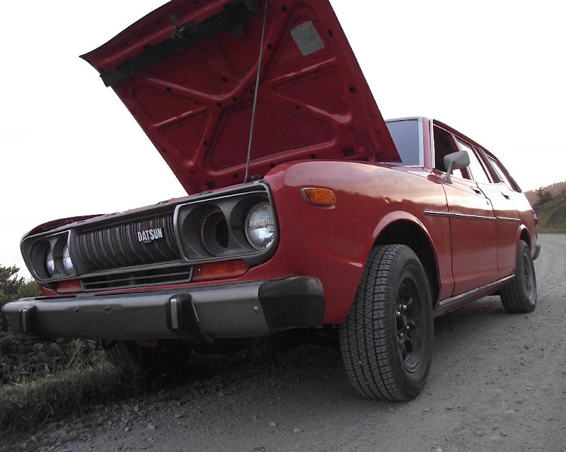

So like I said:..... that was just a trial fitment of the 510's suspension and brakes.....
So I needed the 510 to roll again.......... and the 710 is now rollin' high:

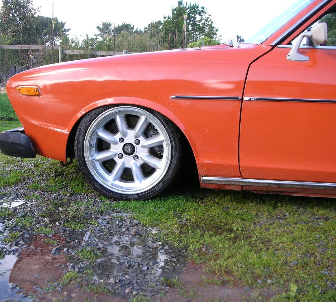

So I just can't take it anymore ................ the 710 needs to be lower..... :lol:
I sold the pair of front 16x7 +22mm Panasports and I kept the tires:

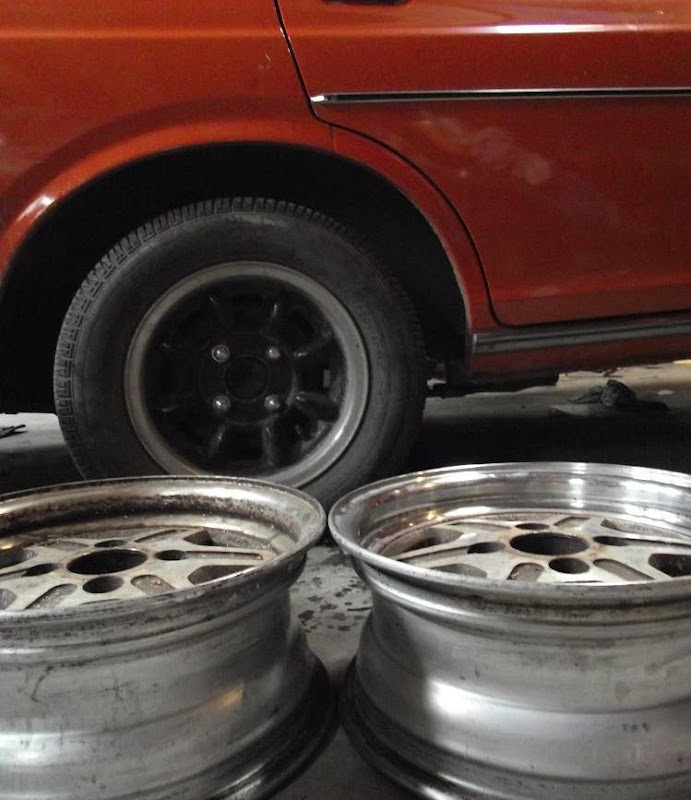

You might ask why would you sell the front Panasports??? ,,,,, ... I got some 280zx struts,, and I can hopefully fit a 16x7 +0mm Panasport in the front... ..
because the 280zx struts will narrow the front track width by ~3/4" on each side
So I'm keeping my 16" tires until I'm done with the suspension,,, and can do the measurement to see if I need a zero offset,,, or a +12mm offset
And in the meantime I'm going to run 13" wheels in the back,,,, and these 280zx 14" wheels in the front to clear the 280zx brakes:

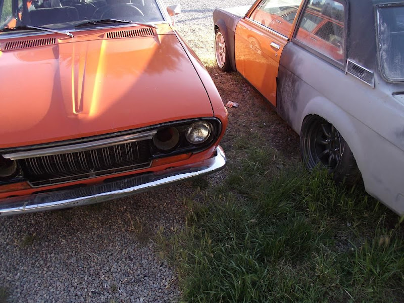

Soon she will be lower:...... :lol:
