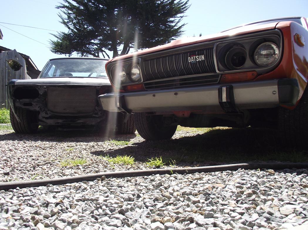

8 years ago I bought a less rusty 510:
My mom's rusty blue 510,,,, and my white, BRE flared 510:

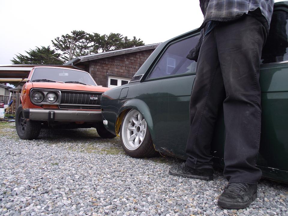

I wish I had more pics when it was white....
But 6 years ago it got a cheap dark green paintjob:

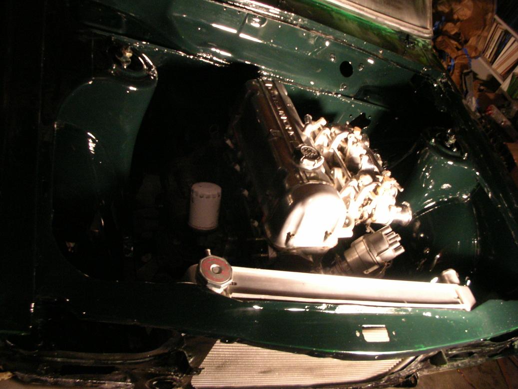

The L20b was getting tired,,, and well...... this is the last time the 510 was drivable:
3 years ago:

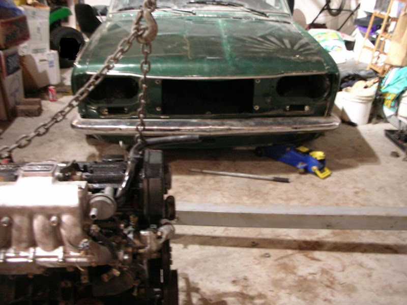

This next part is embarassing......... I was younger,,, and stupider.
For some reason I thought a Yamaha motorcycle motor would be a good idea:
Then a CA16DE with plans for a RWD CA18DET transmission:

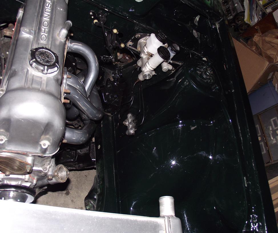

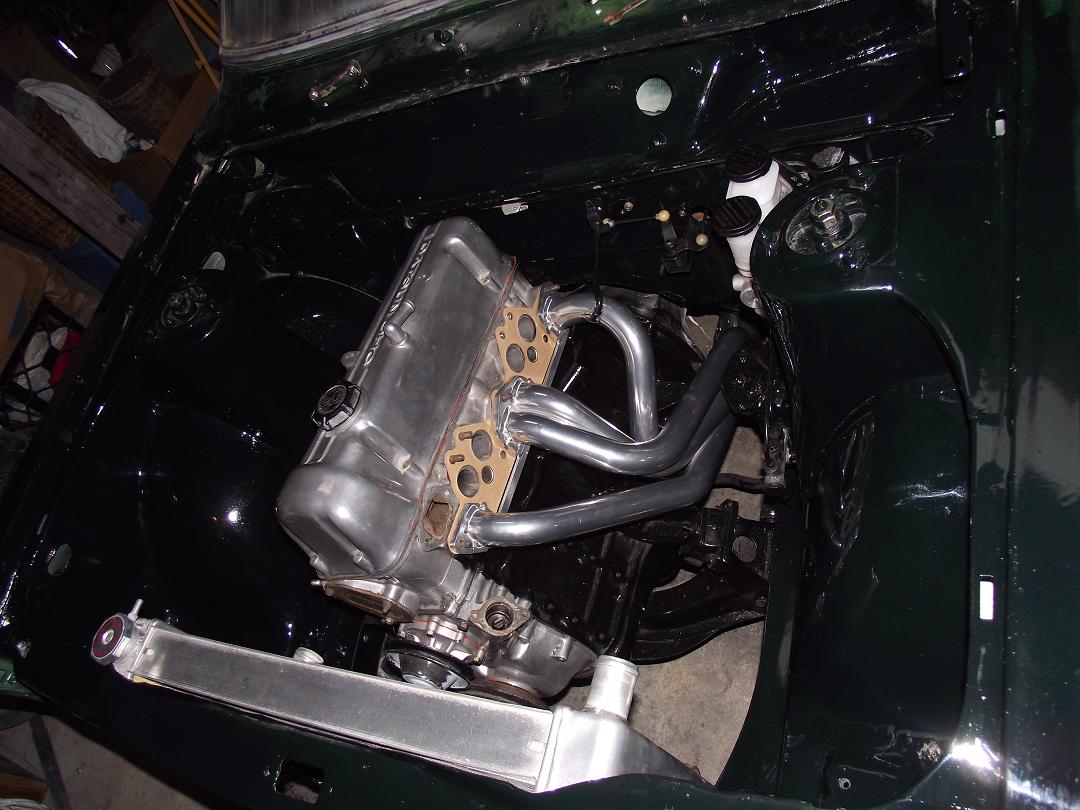

Fixing bad ideas:

Can I embed this video?.......... .. Here is a link to the motor running:
http://www.youtube.com/watch?v=4IRc-M0P ... re=channel
Thanks DatsunFreak,,,,, I wish I listened to the older guys who told me to keep the L-series 3 years ago
It was easy to pull the L20 and sell all the parts,,,,, but it was alot harder buying all the parts and pieces I needed to get it running again....
If your young,,,,, and really want to try a motor swap: KEEP ALL YOUR OLD PARTS

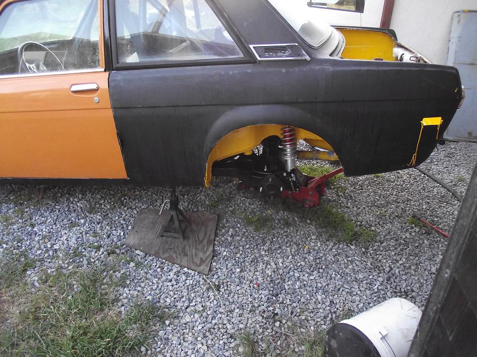

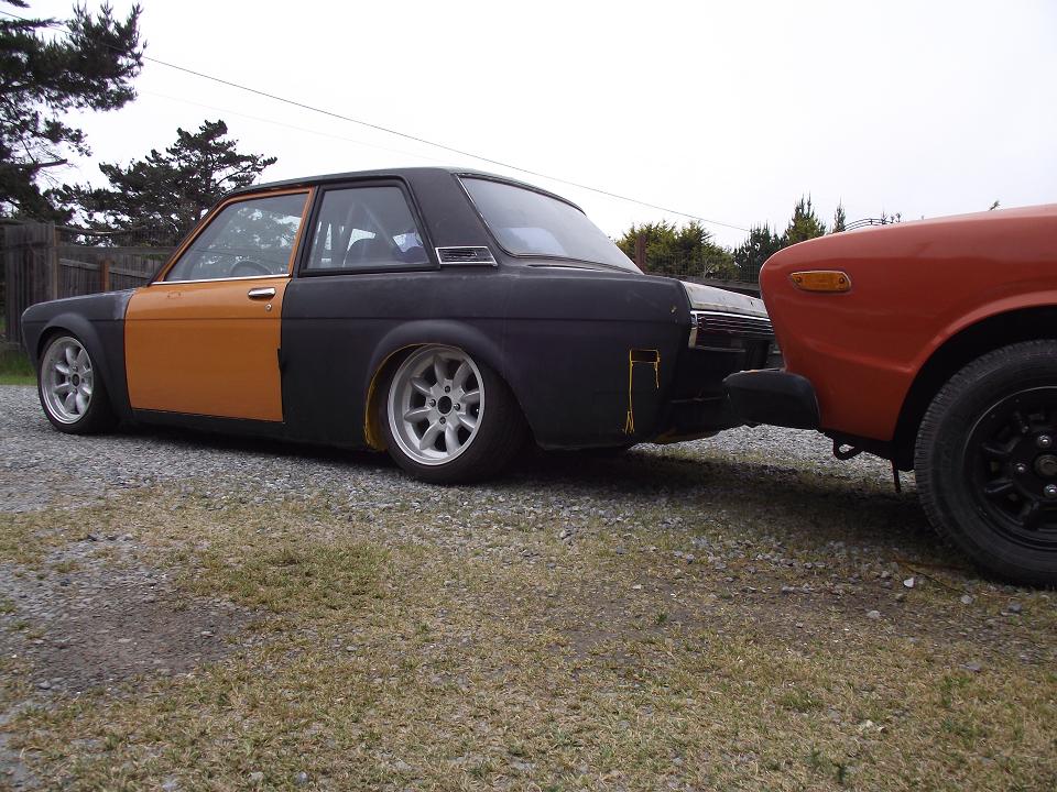

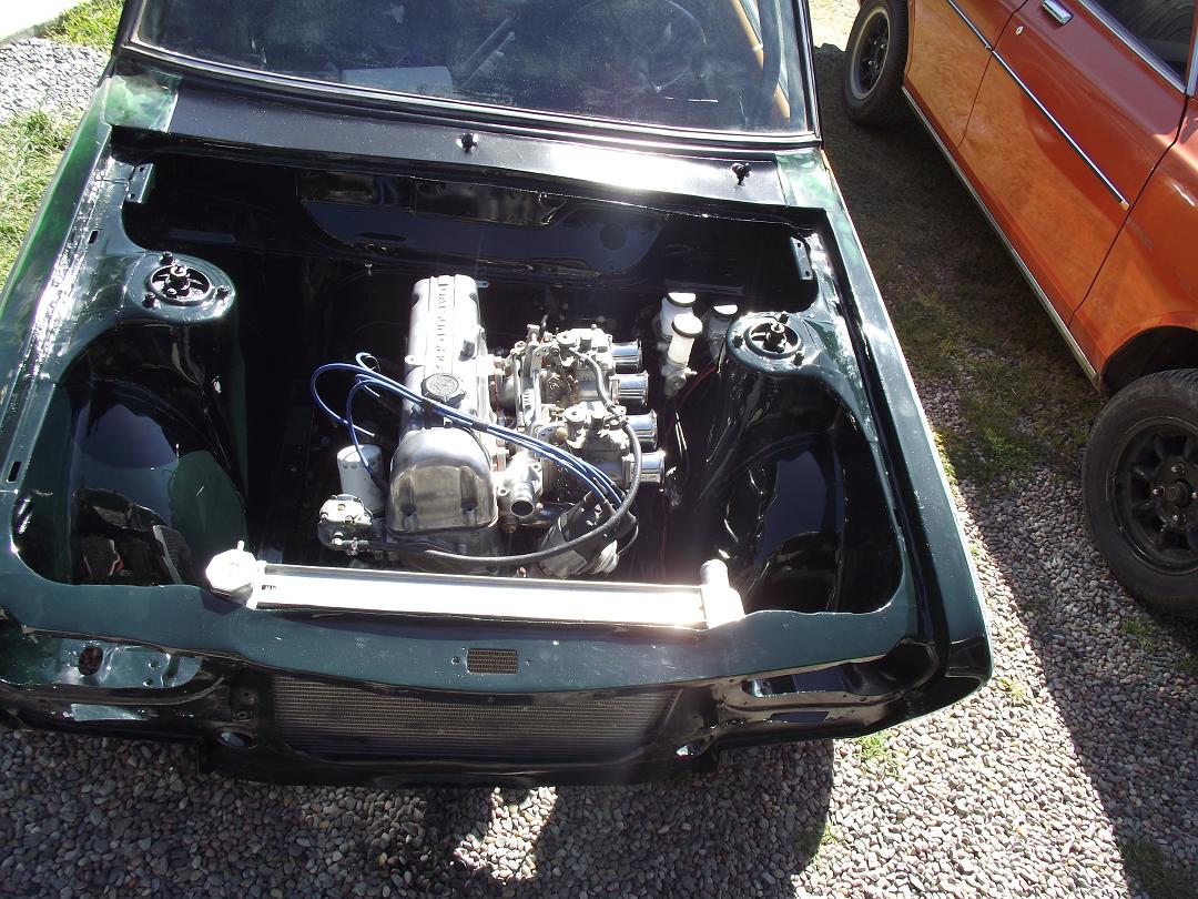

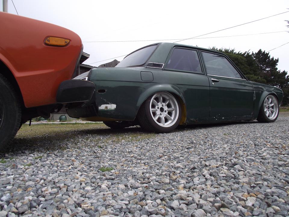

The motor is a L18 with a isky racing cam,,, dual 44mm mikunis,,, nismo comp header,,, 280zx 5 speed,,, IR alt,,, Matchbox dizzy,,, and a Griffin Radiator
My 510 will never be low enough........ .. but I can try:
16x9 -13 watanabes ......... 225/45/16 tires:
Those are 11.5" 300zx rotors........ 2 piston willwood calipers....... QA1 10" coilovers with #225 springs........ stock rear camber,, mini-tubs,, and there is NO room for bigger tires, or wider rims

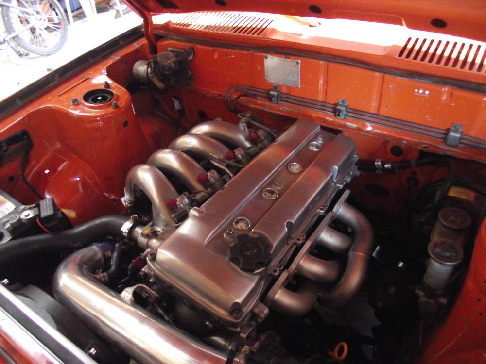

The 710 has a 1992 240sx KA24DE...... .. . first thing I did was clean the engine bay:
PostPosted: Wed Jul 21, 2010 10:11 pm
Joined: Wed Jul 07, 2010 12:23 pm
Posts: 143
Location: CA
Spent a few hours on the intake....... ... :mrgreen:
