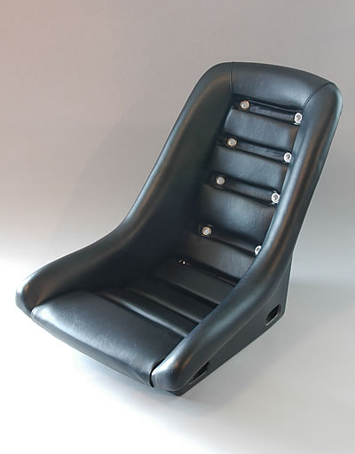

The interior was pretty much scrap since all the foam turned to mush and is un-replaceable. So for the interior, I'm ditching most of it and going with custom seats (probably classic racing seats from http://www.classiccarseats.com/ ) and keeping the interior sparse, including ditching the rear seats and just covering up some of the door panel/interior panels with black painted metal. Carpet... I'm still not sure if I even want to do carpet yet! I kind of like the white-bare-metal idea.
