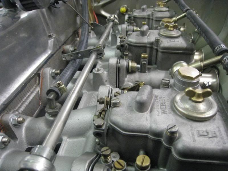

Alrighty..didn't work on the car today, but did get a couple of things I need to button it all up.
I needed to swap the carb linkages from one side to the other, so here are the genuine Weber parts: they are a lot shorter than the arms that the carbs came with, so I think the old throttle arms must have been part of a Japanese kit, possibly came with the manifold. Also since the Weber arms have a ball, I can't use the old linkage arms which bolt on to a hole in the arms. So I bought these new "ball rods" which have a plastic cup design which can pop on to the Weber arms.
But geez, Weber parts are expensive! Would you reckon that the throttle arms are $30ea and the ball rods are $20ea? Well they are.

But anyway...the Redline manifold is so much longer that one of the K&N airfilters wants to occupy the same real estate as the washer bottle. Also the other two filters are so close to the bodywork that I can't get a screwdriver in there to fasten the top of the filter....looks like I'll be driving around JDM-stylez without filters until Plan B makes itself known.
Well anyway here's the stuff-up...I should have installed the linkages before I put the manifold on.
The Redline manifold has got different positions for the jackshaft mounts...the old FET had the mounts in different spots and you could still somehow get the jackshaft in and out...but with the Redline manifold, the only way I can get the jackshaft in now, is to remove the radiator :) ...or remove the centre mount for the jackshaft, which you can see in the pic above.
I want to take the radiator out after rego anyway, and also replace the fixed fan with a clutch one, and check the waterpump...but for the time being I think this bodge will be ok. The jackshaft is 10mm steel, so I can't see it flexing or getting bent or anything like that, especially since the bellcrank for the throttle cable is mounted right next to one of the mounts.
An immediate problem is that the longer Redline manifold means that the original throttle cable mount is now too far away to get full throttle travel. I'll have to make up a longer bracket to put the tip of the cable closer to the jackshaft...and re-route the brake booster hose too!
As you can see, with the softmounts, there is quite a big gap between the carbs and the manifold. It should be good to prevent heat from being conducted to the carbs from the manifold (but the main source of heat in an L-series installation will be radiated heat from the headers below anyway)
The other issue is this...moving the throttle arm to the other side means that the linkage for carb #1 is awfully close to the distributor and ignition cables.
I can re-route the plug wires to get some clearance, but it isn't ideal and it makes sense that the Japanese manifold put the linkages on the other side. I can make juuust enough room by making the plug wires go around the front of the engine, but now will have to get new wires of a different length, because now most of them are too short. Just as well these are just $6ea cables from Auto One.
Ahh well...still some more fiddling to go, but nothing insurmountable. At least it all looks nice... :)
