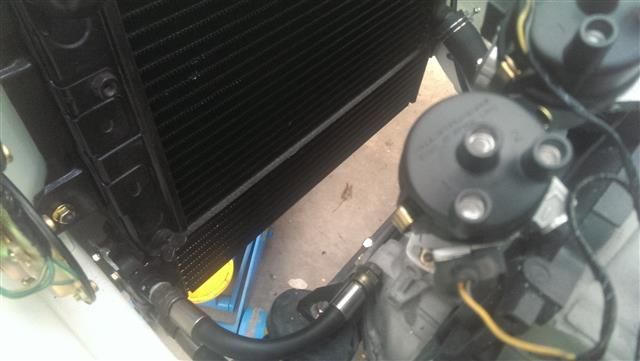

I had Pirtek make some new oil cooler hoses. They reuse the original fittings and clamp on new hoses.

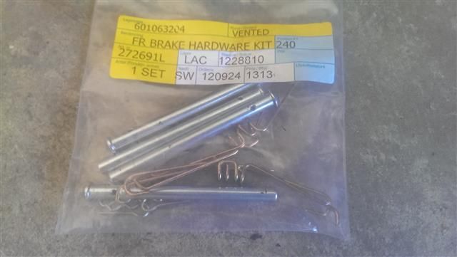

I ordered some new guides and anti rattle springs for the calipers. The original springs and guides had seen better days.

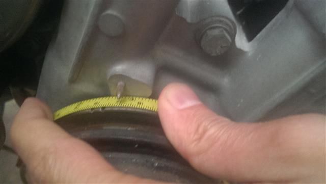

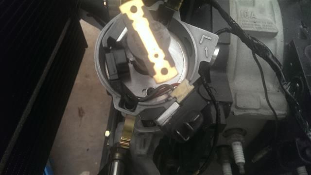

Setting up the timing. I was making a basic tool to fit over the front pulley to make timing adjustment a little easier. Dazz mentioned to check that TD timing pulley isn't 360mm in diameter which makes making the marks easy. Basically each mm = a degree in timing. Pic 1 shows the factory 10a settings. Pic 2, measuring for the new timing marks.
Image Image
Setting the trailing ignition. Dave Broadhurst slots the internal timing plate to allow for the extra timing that may be required for BPs and PPs. It's a really trick setup and well thought out modification. Interestingly Racing Beat recommend up to 35 degrees for TD engines. TDs must have completely different port timing to their SD counterparts I'm assuming.
Image Image
Doing the same for the leading ignition....
Image Image

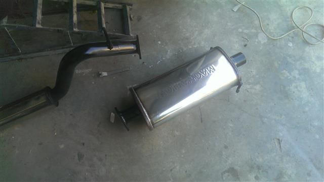

Exhaust done.... Long primaries which are 1 3/4 ID into a 2 1/4 collector into a 2 1/4 rear stainless muffler. A lot of people try and reinvent the wheel. Mazda knew this was the best setup from the late 1960s. If you have an opportunity take a look under any stock L10B Cosmo and guess what you'll see. I don't recall exactly but I think the primaries on the L10B may join after the diff. The other key thing is not to go overboard with the ID on the primaries unless you want a lot of noise.
Image Image
Nothing fancy at the rear, I sprayed the rear of the muffler black to anti bling it. Also nothing fancy at the tip, just your typical 80's style setup, straight and matt black. Pic 2 completing the engine bay wiring......

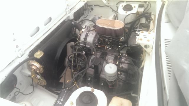

Engine bay pretty much done, just needs the battery clamp repaired, the heater pipe attached to the radiator, OMP sorted and a sump bolt. I'll be ordering new nylon hose for the OMP this week. Jeff sent me some wire style hose clamps to seal the rest of the cooling system. There's a 6 week wait to get new ones from Japan, can't wait as I've had enough !

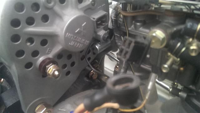

Well, having a string of teething problems with the Mazda. Fixed some leaks and some other issues, more to go.
I was suppose to start it but would you believe I don't have a spark plug tool of all things !
The dash idiot light goes off which is good but the oil pressure light hasn't switched off yet. I've given it about 3 or 4 cranks. Anyone have idea how long before it gets oil pressure ? All the lines and cooler are new as is the block, I'm guessing it might take a while to get all the air out.
If the light doesn't go out I'll connect a mechanical gauge directly to the block.

first up disconnect the return oil cooler line to make sure you have oil moving through the whole system and make sure the battery is at full capacity, rotary's need to spin as fast as the starter will allow
