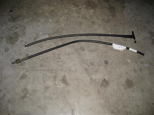

Rx3 accelerator cable is too short so used a 929 cable that was cut down to size. Looks like a factory cable :)
