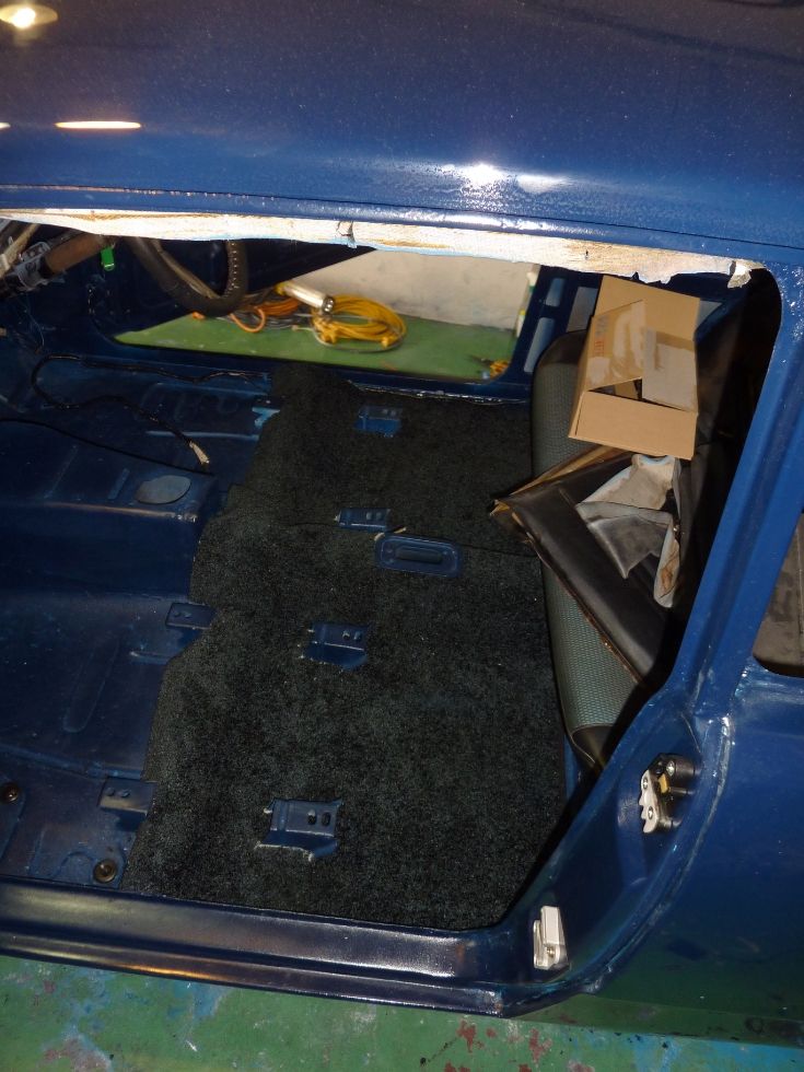

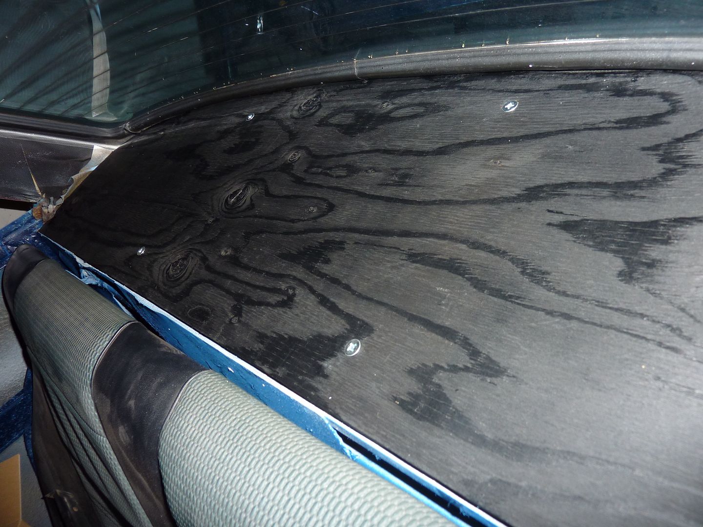

So, since the little Life is currently awaiting a new head gasket, I had the whole weekend to focus on the Bellett. Starting with the hinges on the trunk.
It was an utter pain to get aligned. I had to get my better half to align it while I sat inside the trunk ready to tighten the bolts. Now that it moved up and down, I installed the stay to keep it up!
Next, I wanted to get the harness run, but it was a little old and gross looking.
So I gave it a wash and then wrapped it in brand new tape.
With the harness clean and kind of in place, I got tired of having the passenger door tied shut. I tied it shut initially because the floor in my garage is uneven as all get out. This meant the passenger door was perpetually open, just begging to get damaged. It also meant that I couldn't open it. So, I got to work installing shims to align it properly and installed the door opening stay thingie.
With this done on both sides, I now had doors that wouldn't over extend and would stay open!
Next up, I cut out some new rubber for the door handles and installed those guys.
Then in went the window regulator.
Next up was the lock, but it was in particularly rough shape, barely turning at all. You can see why too, it's grimey and gross.
So apart it came to get a thorough cleaning.
Next I needed to install the rest of the door striker things. (Quick note, my camera has taken one too many beatings and is truly on it's last legs. As such, the pictures are getting worse and worse and blurrier and blurrier. Sorry about that.)
Same on the body side.
And with those installed and adjusted, I now had doors that would hold themselves closed! (Another side note: the interior sitting inside the car is not installed, I just needed a place to store it that wasn't the kitchen.)
It was getting late on Saturday and I was running out of energy, so I installed one more item and then called it a day.
Sunday morning I was right back in it working on the hood.
I got the popper mechanism and handle all installed.
Here's where the main harness comes out and the hood popper cable. As you can see, they get brand new grommets.

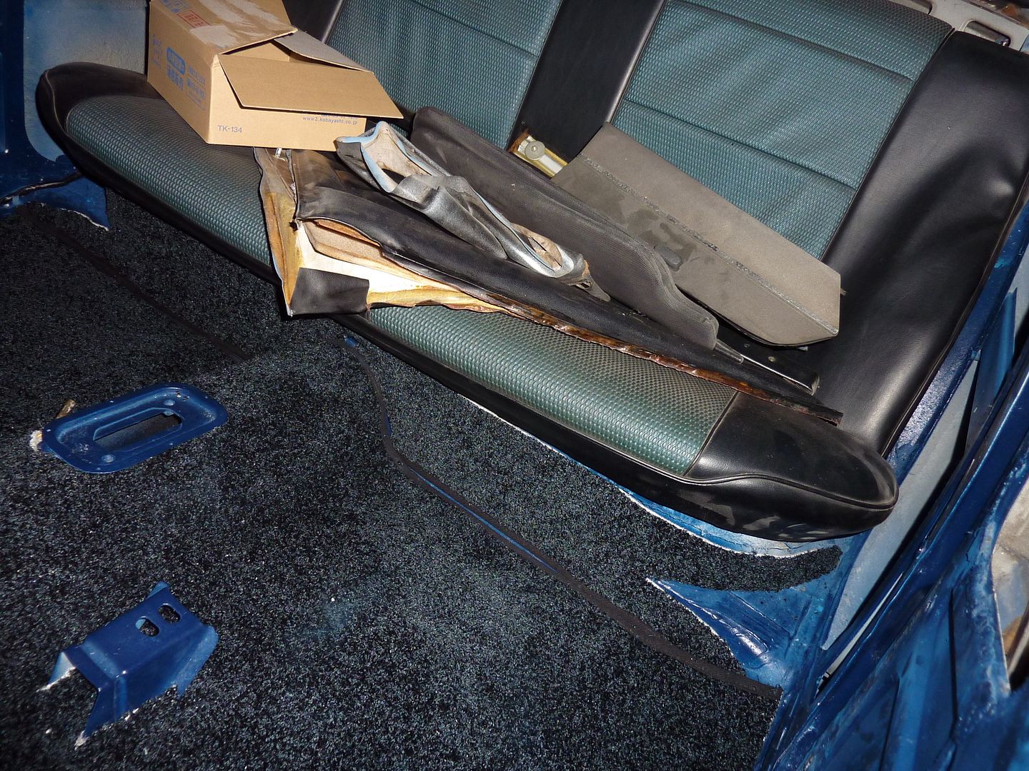

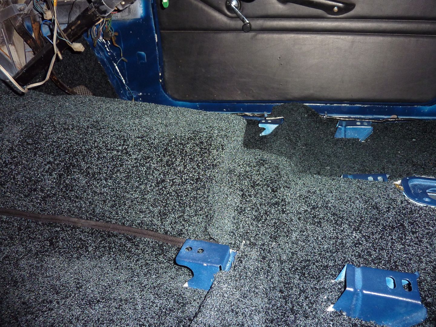

One thing that was really holding me back on the interior was carpet. I couldn't find any fitted carpets and the original carpet had long been destroyed. My only choices were to get someone to custom make a carpet for me, or to make the carpet myself. Given that I had come this far by making/doing everything myself, I wasn't about to let a little carpeting get in my way. A trip to the local rug, curtain and carpet shop yielded this nice, 2.5 meter by 2 meter black rug.

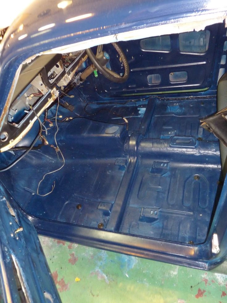

First step was to clear out all the stuff sitting on the floor pans and pop in some new grommets.
Then I cut a piece roughly shape but oversized so I could trim it down.
I started fitting it by aligning it in one corner and working my way across. The first new cuts I made were to accommodate the passenger seat mounts.
Then I formed it over the tunnel, cut out the e-brake hole, then the driver seat mounts and finally trimmed off the excess.

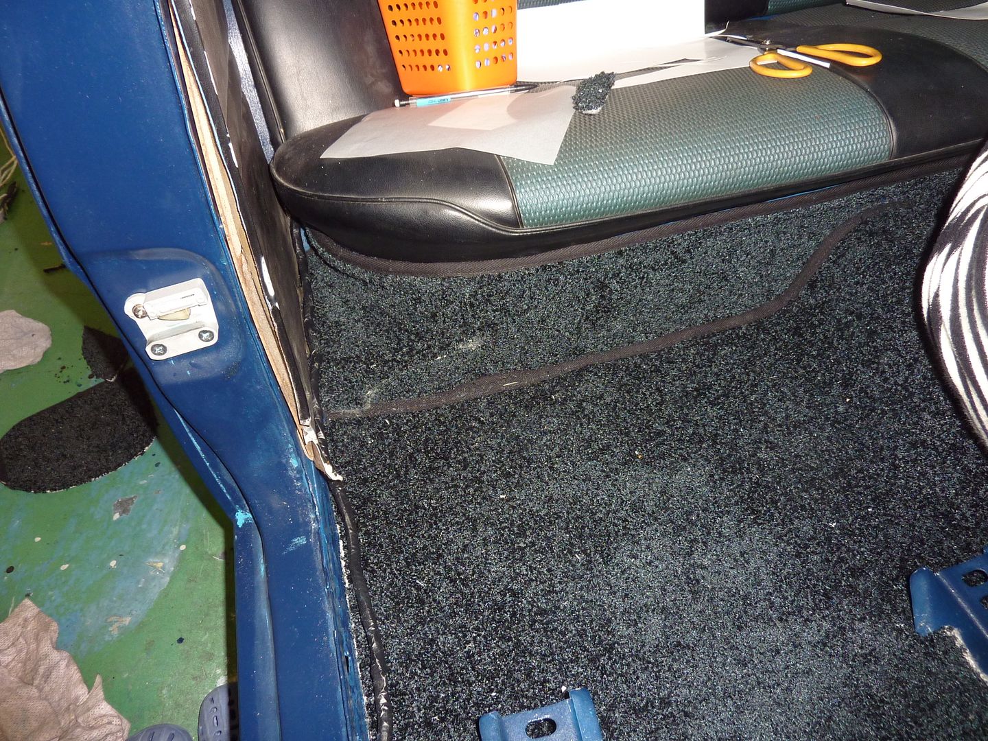

Next was the bit that goes on the metal that's just below the rear seat. Fortunately, I had the original piece that went there to use as a template.
The newly cut piece set in place.
Then small triangles to fill in more exposed steel.

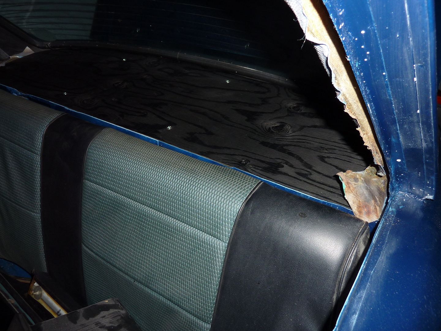

Moving above the rear seat, I got to work on the rear parcel shelf. I took the piece of wood that was there originally, drilled new holes in it to mount it properly, sanded it and painted it black. Then I mounted it into the car.
I used tapered screw head M6 bolts to mount it so they would sit as flush as possible.
Then I cut a piece of carpet to the right size and set it up there.
Looks pretty good!
I need to sew on a cover for the end you can see to cover up the white, exposed edge of the carpet.

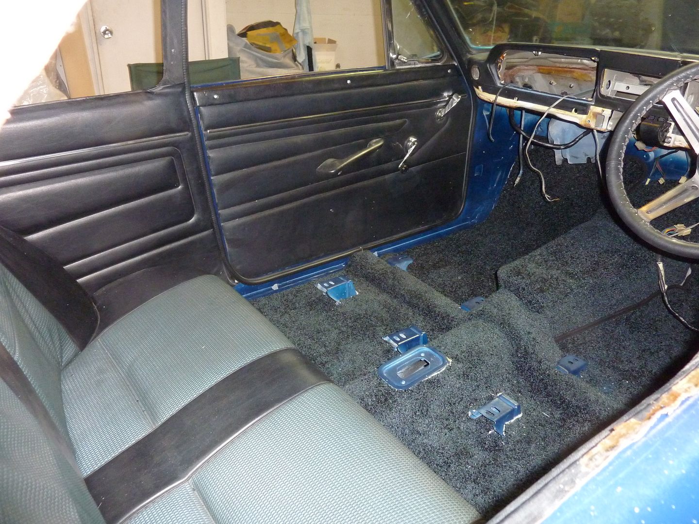

Next up was the transmission tunnel. Again, I used what was left of the original piece as a template.
Unfortunately, the template was seriously deteriorated on the driver side and I cut the new piece a bit too short on that side. So I had to recut another piece to fit.
While I was working on carpet, I started gluing the exposed vinyl from panels down. I would line it with a thin line of bond and then use a ton of clothespins to hold it all in place while the bond cured.
Once the center console piece was mostly in place, I cut out the passenger side foot piece.
And then did the same for the driver side!

Miki then got to work cleaning up the final bits of exposed metal underneath the seat and generally just making my work look perfect. While she was doing that, I decided to install the chrome trim that lines the rain gutter just above the door.
A nice plastic deadblow hammer made quick work of these pieces!
They still need to be polished, but that's something I'll handle all at once.

Not bad for my first time doing a full carpet installation on a car.
I think once the aluminum trim and the seats are installed, it'll look really fantastic!

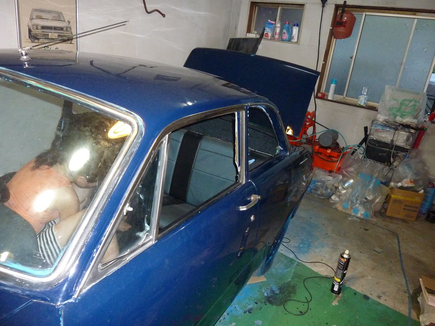

I enlisted the help of Miki to help me finish off the last bits of the carpet just below the seat. The parts that were bothering me were the little triangle pieces. So she made some templates and got to work!
After much cutting, shaping and gluing in place, we have a perfectly formed triangle piece that covers up all metal!
The flash on the camera we're using is crazy bright and highlights things like you wouldn't believe. You can easily see the seam where the triangle piece is, but in the flesh it just disappears.
You can see a little blue poking out in between the floor carpet and the side carpet, but that's just because we were moving in and out of the cabin all day and the floor carpet slid around a bit.

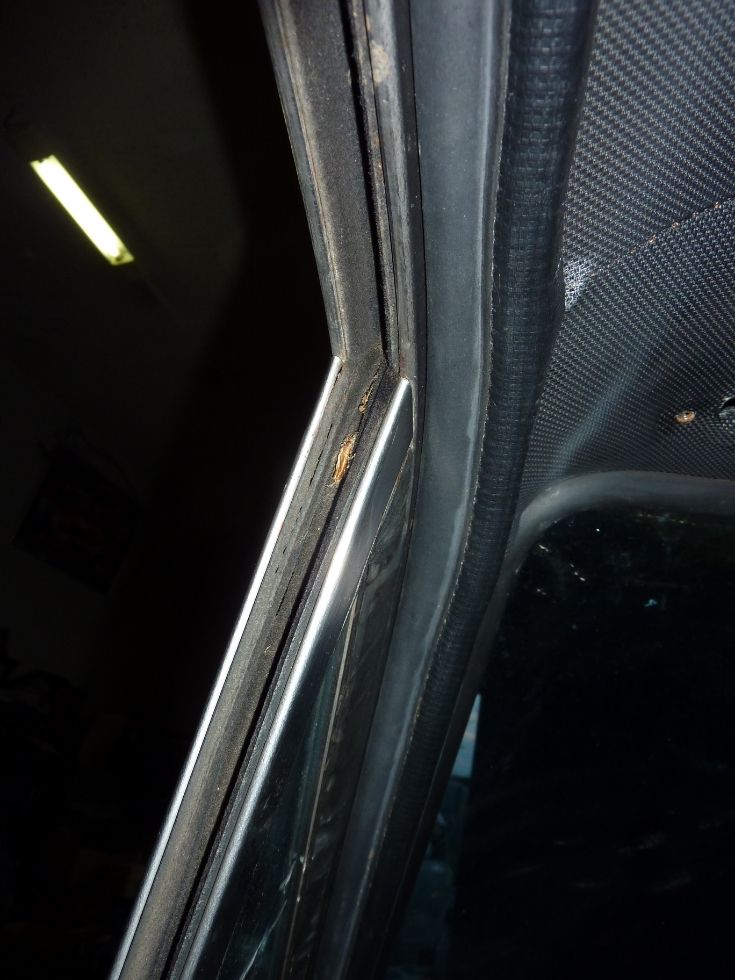

I then got to work bringing the trim pieces that go just below the door panels back to life. They're just super flimsy aluminum and were in really rough shape. I tried polishing them to bring them back, but they were too far gone. So I rubbed them back with some sandpaper to get a clean, smooth surface and then hit them with a few coats of zinc rich silver paint. They came up looking much better, but I would like to find some replacements of these in the future.
The next problem I ran into with them is that they're designed to work with a different type of door weather stripping, so they don't fit at the moment. I need to trim them to work with the new weather stripping I have.

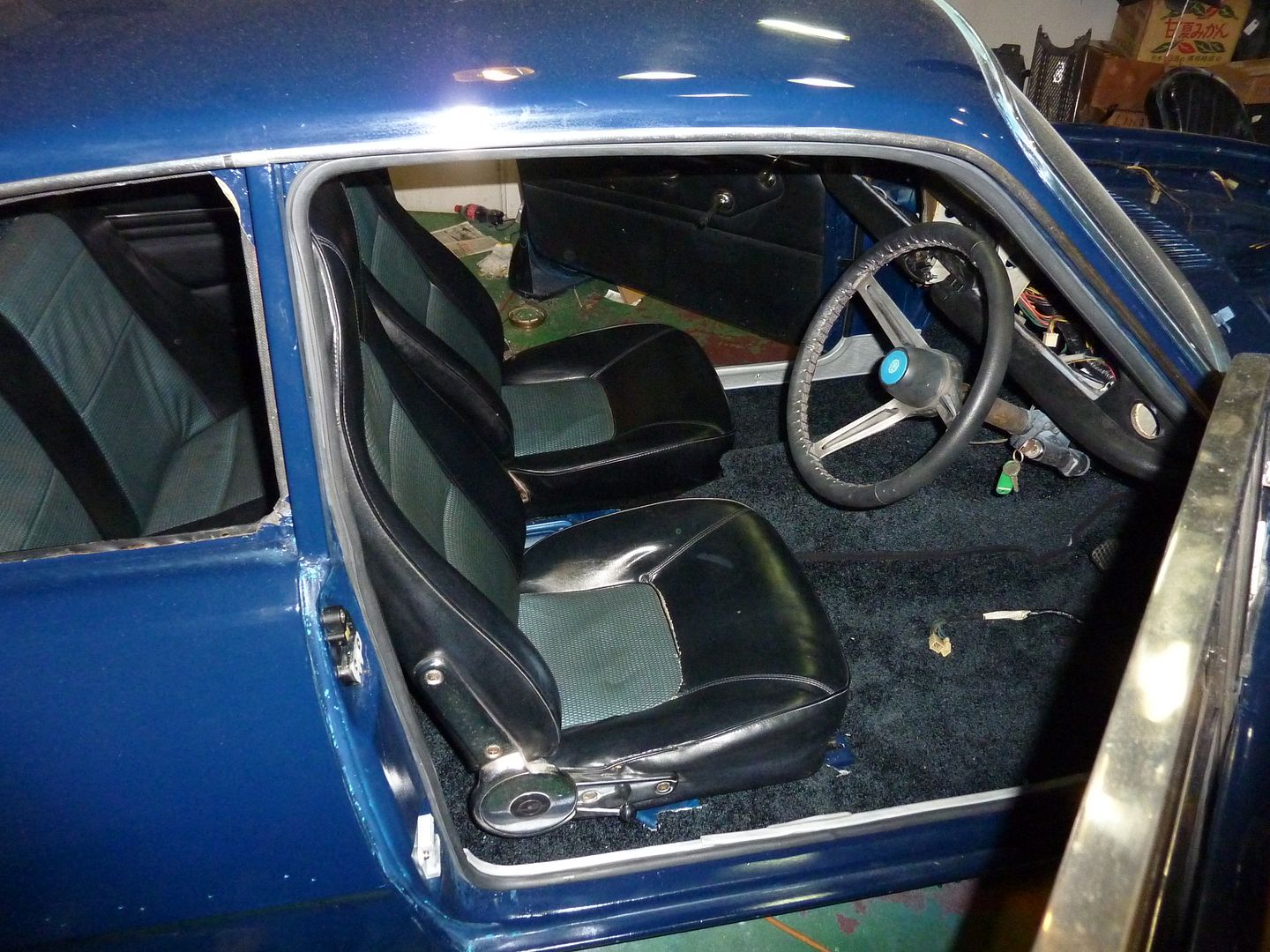

Then I really wanted to get the seats in, but first, I had to clean up, paint and regrease the seat rails.
And bam! Seats in!
Naturally, I had to take a seat and close the doors. The thing is massive inside. Maybe it's cause I'm used to daily driving a 360cc kei, but it's really, really comfortable and spacious in there!
Even with both seats all the way back, there's still a tiny bit of room in the back seat. If you scoot the passenger seat forward a bit, there's tons of room for a normal sized adult.
It's beginning to look like a car!
With the right engine in it, this could be one amazing GT/long distance car!

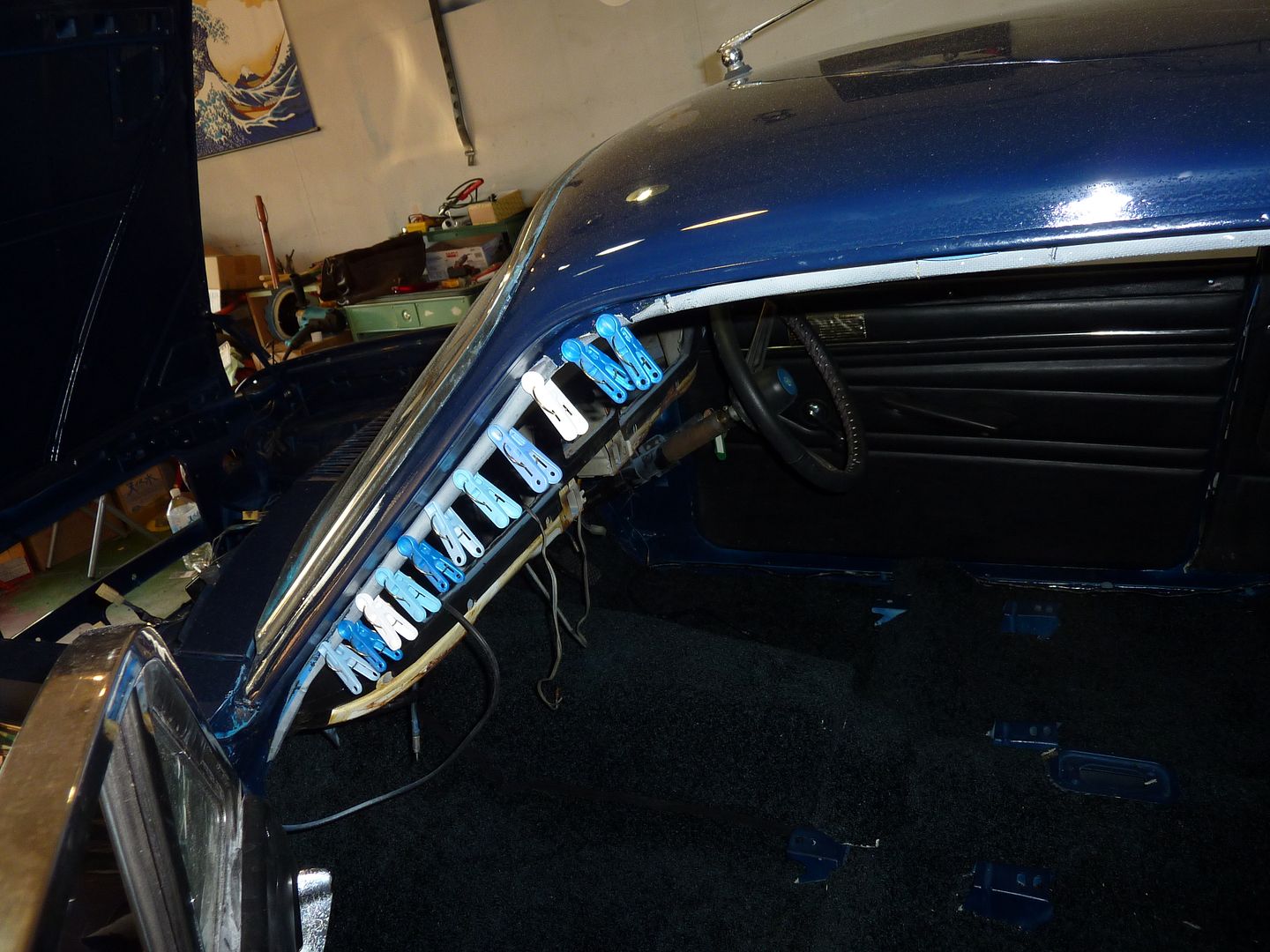

While that was set aside to dry, I got back into the lighting. It was time to install the rear lights. I immediately ran into a problem though and that was with the chromed plastic rings that sit around the lights. These rings have (well, are supposed to have) four studs that go through the body and then through the light housing. You then tighten some nuts down on the studs and it tightens the whole thing up. Unfortunately, all four chrome rings didn’t have the studs on the bottom anymore due to rust. Since, they’re pretty frail plastic, I didn’t want to try to get some new studs in for fear that I would ruin the plastic in the process. So, I used normal bolts for the bottom to hold the housings to the body and then studs on the top of the ring stab through like normal.
So, the bottom of the ring isn’t directly attached but the actual taillight assembly is very solidly attached on all four corners. You can see there’s a slight gap at the bottom of the ring, but it’s really not much at all.
So, since that method seemed to work pretty well, I just kept on rolling with the next light!
This one has a tiny bit more of a gap, but it’s still so small it’s not really a big problem.
So, I kept at it and got all four lights in!

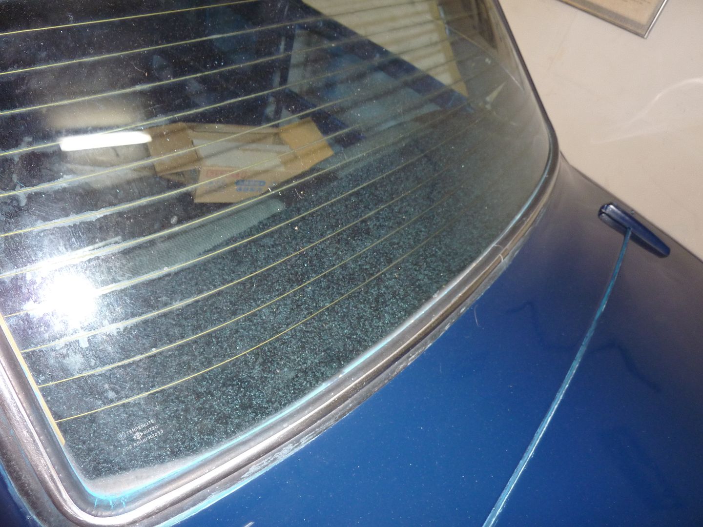

When I first got the car the previous guy who restored it didn’t want to remove the headliner. Unfortunately, the headliner needs to be removed to get the roof antenna off. I took advantage of this hole to keep me from having to remove the headliner when I did the repaint. Here’s a picture from a little while ago after I installed the sun visors showing the hole.
I thought it looked pretty bad and I wanted to fix it, but I was coming up empty handed on ways to fix it in a slightly manner. So, I thought that covering it up could be a solid alternative. So, I cut out a thin piece of board, covered it in black leather and gave that a shot!
The blacks actually match in color, but the pattern of the headliner causes it to light up like Christmas when you hit it with the flash of the camera. Still, it looks miles better than a hole!
A shot from further back.

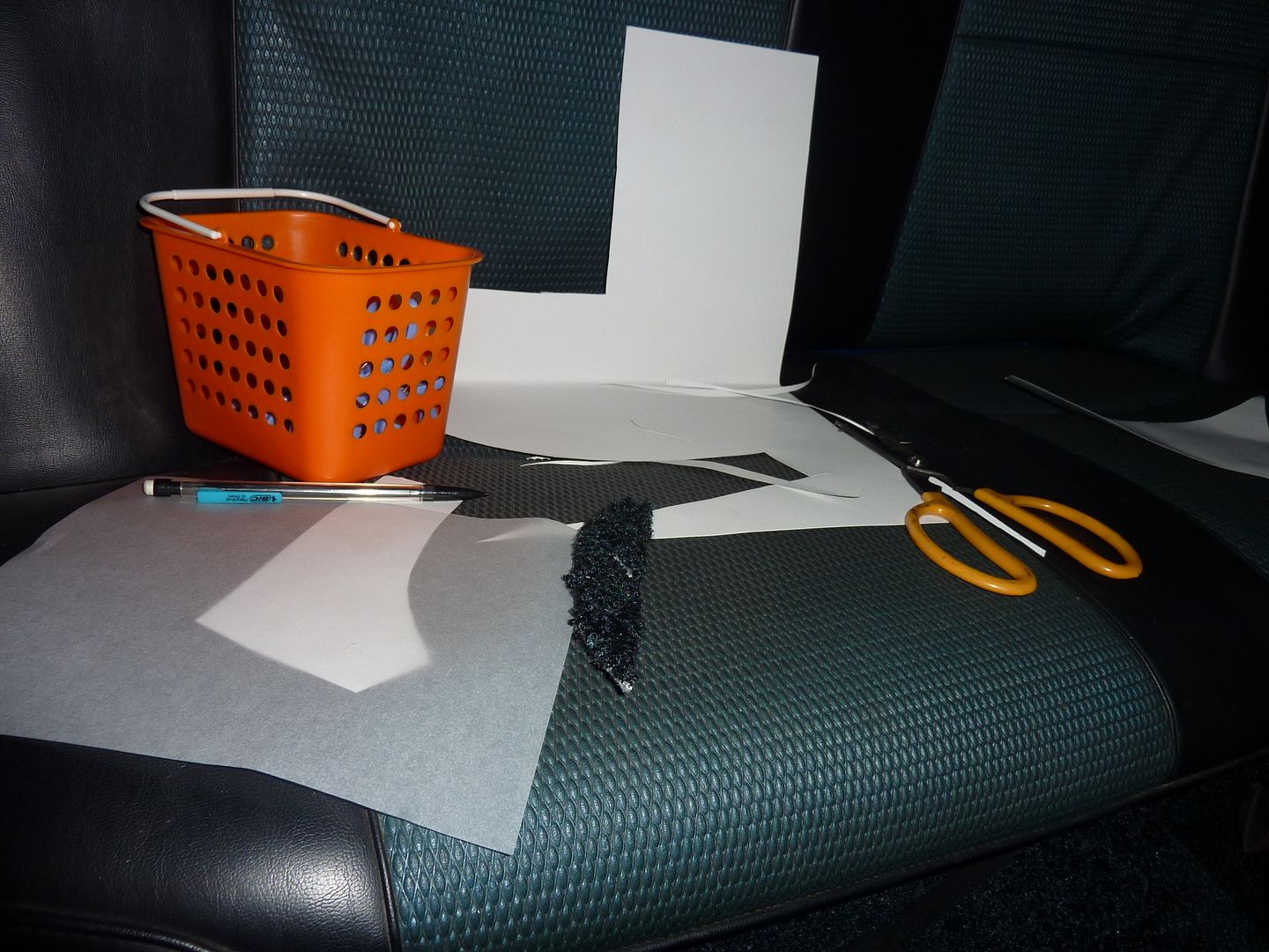

I wasn’t alone in the garage this weekend though, Miki was out there helping me considerably! She was in charge of the trunk.
Her goal was to create a nice cover for the spare tire and gas tank, so she started by making good old cardboard templates!
This upgraded into coroplast which we would eventually lay carpet over.
