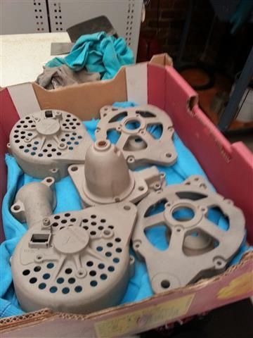

Next is part one of the alternator rebuild. I got all the parts back from the electroplaters, all look much nicer now. Part one covers diode installation. Die hard Rx3 nuts will notice that this is actually a later model alternator and not the correct one for a 10a rx3. I believe these were fitted to REAPs Rx3s and 13B Rx4s. The give away is the heatsink design.
The alternator contains 6 diodes of which 3 are positive biased and 3 are negative biased. You can use a multimeter to work out the anode and cathode orientation. It's very important not to mix these up. The alternator basically provides power to run everything on the car once it's started so it's important to use an alternator that can supply enough current to power everything in the car at once. The output of the alternator should be higher than the output of the battery.
In short the windings within the stator and the rotor produces an AC wave form prior to the rectifying diodes. If you connect up an oscilloscope you should see 3 sine waves from memory. Without going into too much detail the 6 diodes take that sine wave and give an unregulated DC 13 or 14v at the output. To understand why it's unregulated you'd need to view the output on an oscilloscope. The diodes do this by simply restricting part of the AC wave form. It's been a long time since I used an oscilloscope but if I get the urge I show you all. The dirty DC signal is then fed into a voltage regulator to provide a clean DC output.
Soldering in the diodes, checking their orientation and checking their operation after installation. You won't find many auto sparkies doing this sort of work these days. Middle iron worked the best, flux is required to solder to the steel. The flux etches the metal clean for the solder to take. I used a small torch to get the diode heatsink "pot" up to soldering temperature.
Image Image
Image Image
Image Image
It's important for the solder to "flow" for connection integrity and physical strength.
Image Image
Checking polarity of diodes and operation after installation.
Image Image
We do the exact same for the other heatsink. One heatsink has a series of positive diodes the other negative diodes.
Image Image
I'm waiting on the alternator housings to come back so I can solder the diode ends to the stator. Next update I'll check the stator and the rotor windings. As you can tell I like the technical aspects of a project more than anything else.

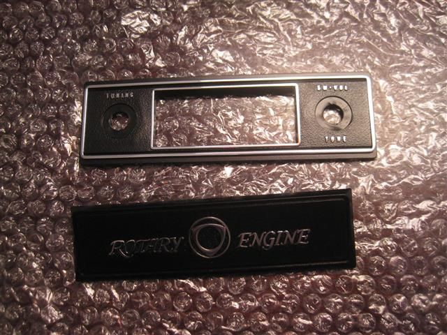

Dropped in to see Dave (RestoreMaz). Did some plastic chroming for us. I had to straighten the radio fascia panel before Dave started working on it. I basically had to bend it back into shape using a heat gun and some clamps. Dave's theory was good, better I accidentally snap it than he accidentally snap it.... :) It was bent like a banana from over tightening the radio nuts.

One of my mates finished blasting the alternator casings and sedan starter motor. It's all ready to go back together when I get time.

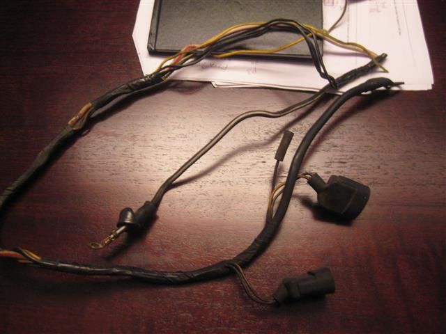

I found a good Rx7 ignition harness for my twin distributor ignition. The rubber ignitor plugs are in A1 condition. Basically I've stuffed Rx7 high energy ignition system into the original distributors. I can now complete the wiring, I think I'm still missing the ignition relay though. Will take a proper look through the boxes of junk that came with the coupe.
