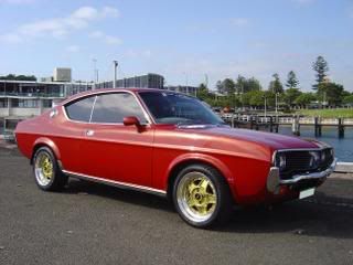

<I><B>Hi to all.
Just wanting to introduce you all to my 1977 Mazda 929 RX Hardtop,
which over time I have nicknamed "BabyGirl".

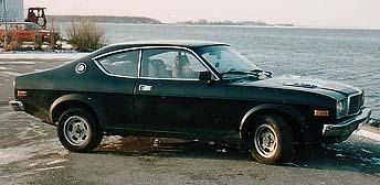

The next 2 photos are not original pictures of my Mazda 929 Hardtop,
but because it looks identical, including the wheels, I decided to use them
After owning her for a month, and putting on a different set of rims.

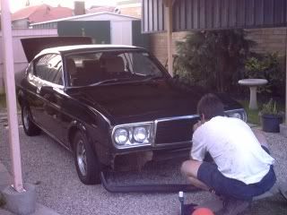

Was never a fan of the Series III front RX-4/929, so I changed it!!
.................to this
And because the Series III bumper didn't match the Series II front, it was also changed...............

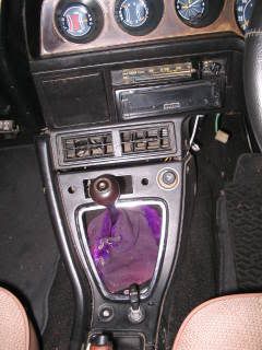

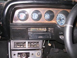

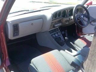

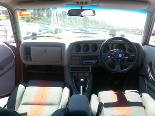

I took out the Old Woodgrain Dash.............
And not so good interior...............

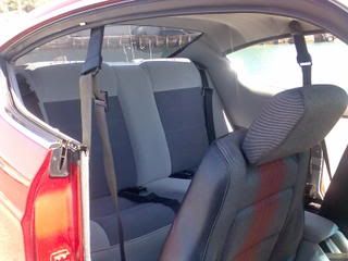

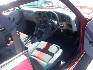

And replaced them with custom Grey interior
out of wrecked RX4/929 Coupe which I puchased for parts,
and installed a set of early RX-7 front seats,
black with red/grey inserts..............

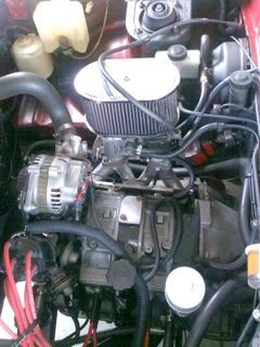

Kevin Webb from SCR South Coast Rotary in Wollongong, NSW Australia,
sourced an early 4 port 13B from an RX-4,
re-built it with his SCR Racing Apex Seals, and J-Ported it.
It runs a re-jetted 48IDA Webber, with Series II RX-7 electronic ignition,
lightened flywheel, 4 puck ceramic clutch with 1 tonne presure plate,
RX-7 Series II 5spd box, single piece tailshaft, thru to the stock 929 diff.
It runs custom 2” medium length extractors collecting into 3” mandrel bend exhaust,
2 custom made 3” straight thru resonators,
over the diff into a custom made 3” straight thru muffler,
with stainless steel packing, and a 3” bendy chrome dump pipe.
100 decibels at 2,200 idle. Deep Brapp Brapp, nice and quiet. LOL

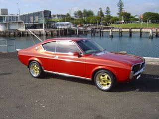

Colour is a custom mixxed Mazda Velocity Red.

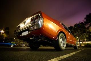

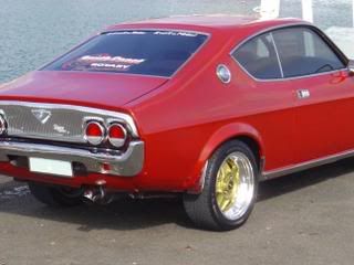

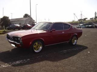

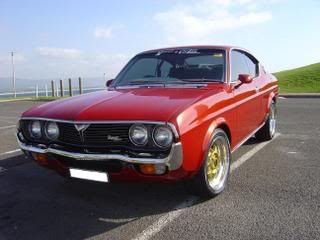

Just before I re-sprayed the car,
the opportunity and the decision came to change the rear tail lights.
I was never a real fan of the Series III, so to change the look,
I changed the front nose cone to a Series II,
and the rear was going to be changed to a Series II also.............
....................but decided against it!!
Instead I took a different path...............
And it turned out fantastic...............

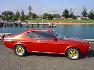

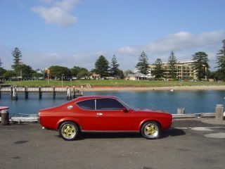

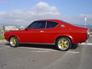

The finished product now sits on a set of
Australian made 16x7 and 16x8 Gold Simmons B45s

Love that car!! are those RX-2 taillights? Whatever they are they look great. I'm a big fan of the Australian way of building cars. You guys down there build some nice rides!!
I can't wait to start work on my RX-4. :lol: :D
Thanks for your comments PERTANO. :tu:
Yes they are RX-2/R-100 tail lights.
The difference being is I have used 4x Brake/Reverse light units instead of the Blinker/Red reflector set up that you would normally see on Rx-2s and R-100s.

B1500boy wrote:
Hey man, sweet overhaul there. Mate, can't say I've seen the Rx-2 taillight conversion. Love the B45's. What the colour? When you swap the front over do you need just the outer panels or do you need other inner panel to bolt them to??
Hi B1500boy.
Thanks for the feedback.
The colour of the B45s is Simmons Gold, they look fantastic because they were only resprayed 1st week in January.
The colour of the car is a custom version of Mazda,s Velocity Red, found on the 6, 3, RX8.
Custom being that when I was getting the paint mixxed, they didn't have the full ingredients, so I took a chance with a couple of different ingredients.
Wasn't sure how it would turn out. And it worked :tu:
I used the Series III guards.
Only encountered 2 problems.
First, the front stone tray beaver panel, needed a couple of new holes drilled to bolt it to the bottom of the guard.
Second, the Series II guards have a slight cut out to allow the bumper bar ends to sit neatly inside once the rubber inserts are placed on. but since those rubber ends are not always available, I don't have them.
The bumper ends fit snuggly over the guards, just have to be careful as there is not a lot of room to allow easy removal and hence its easy to scratch the paint.
I found that all the bolt up points are the same, had to change the headlight craddles to suit the different grill though.
The inner guards in these car are part of the front chassis section, so they are all the same, or very very similar.
Hope this helps
Cheers
