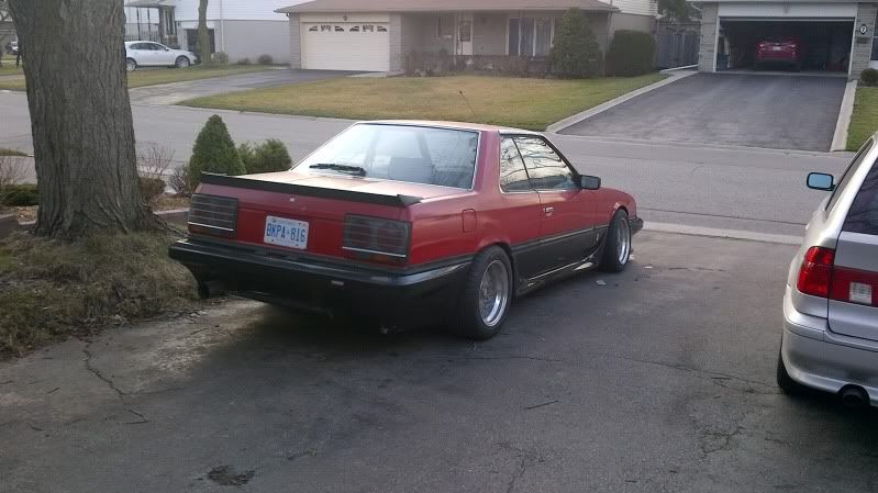

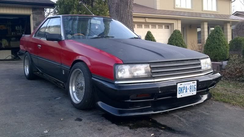

Hey all,
Long time nostalgic car fan, been working my way through many.
Current Car is my 82 Dr30 which i personally saved from a junkyard in japan when i was living there.
Has:
Full S13 suspension & Steering rack conversion
Fj20et Swap(was n/a)
Hks T4 Kit
Arc intercooler
Aluminum rad
kakimoto exhaust
Haltech Sprint 500 Standalone
Bosch 044 pump
Custom fuel Rail and lines
850cc injectors
Z32 Transmisson
Nismo 1.5 way diff
Rays Centerlock mesh wheels
84 ironmask power interior
Tomei Cluster
Defi Guages
Blitz talking turbo timer
Blitz dual SBC
Check my photobucket for my past collection!
ae86, s12, s13 Lots, mk2 jetta, 760 Turbo Wagon and more!

Good looking DR. How was it putting in the Z32 trans. I have heard about the RB25 trans installs. Was it just like those?
 Post subject: Re: 1982 Dr30 In Toronto Canada
PostPosted: Wed Oct 03, 2012 7:31 pm
Joined: Tue Oct 02, 2012 5:05 pm
Posts: 6
yeah, they are the same trans just with a stupid shifter setup, i have an rb26 bellhousing on it to make it bolt up, and custom speedo drive gear but they are super cheap i paid 180$ for the trans from a local engine importer
