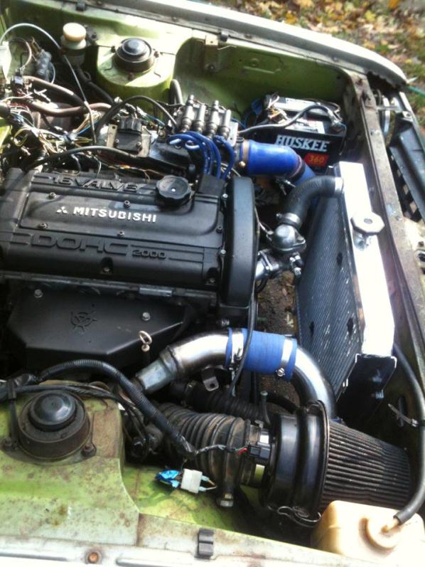

suppose I should update:
the other day I made motor mounts and now I have an SRT4 intercooler for it. I need to do wiring, then it's on to some fun.
Seen here is the EVO 8 intake manifold with the adapter plate. My brother has lots of these for anyone else that wants to run a similar set up.

So, it runs and drives. I dont think the stock radiator can keep up with the engine though.
Sorry for the small picture, this website blows. 800 pixel limit, I mean, REALLY?

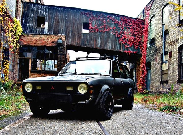

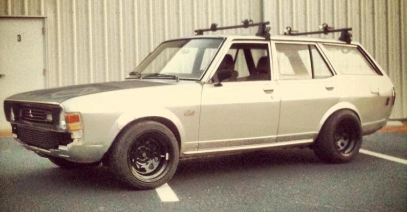

diamond racing wheels one, new radiator from a 2.6 liter model later 70s colt, had to massage a little to make it fit. Drove it 4 hours up to a meet in detroit, farthest I've gone since the 4g63t swap. Need to get the flares on soon.
http://www.ebay.com/itm/290773321216
That's the radiator, significantly larger than my stock one.

I should have gone zero all around, but i went zero on the rears (15x10) and 3 inch backspacing on the fronts, so they stick out 5 inches (same as rear) instead of sticking out 4 inches (would be easier for fitment) Not sure what 3 inch backspacing means in terms of offset, but online calculators say its -38mm.
flares as tim said are for a 280, they're curing in the garage with the rubberized coating I put on them, they'll be going on this week. Thinking about painting the car satin black, body is pretty much screwed, so the satin black will give it the rugged look it deserves. here's a quick photoshop of that:
