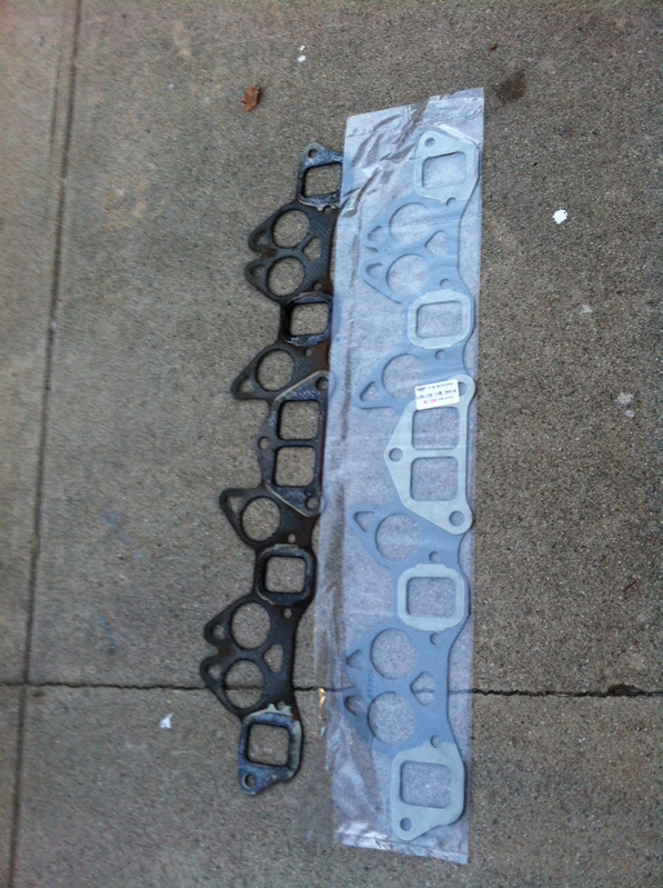

Some weeks back, actually just before Bayline, I was searching for a larger than stock intake / exhaust gasket, I even experimented with making my own die and punching it out on the press but only with mixed results...
A couple people on here, as well as some co-workers, and Dave Rebello, all told me to ditch the gasket and just run with RTV only...
I gave it a try..
In fact I re-set the header 3 separate times trying to cure a exhaust leak at cyl 5, but I could never get it perfect.
The header flange checked out flat, but the leak always came from the top edge of the cyl 5 runner... that guy's not clamped very well with our header bolt arrangement...
Anyways, while it didn't show on the Kameari California distributor (Misano Motorsports), I was convinced I had seen something like a big port gasket in years past from Kameari Japan. Some phone calls later confirmed it was in fact available...
A couple weeks passed and I got a package today:
Exactly what I was after! It matched the old one I had taken off the car last month!
And not too bad at 2000JPY each - I bought several for the future...

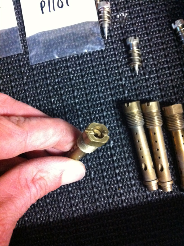

In other news, I've been digging deeper on the Mikuni Solex that came on the car from Japan.
They are 44PHH S5 independent type carbs (not homogeneous), and so far these jet blocks have stumped a couple people...
Thought I'd post them here in case someone has seen these before?
Will (Rad2ltr) posted them on 311s.org and we got some interesting feedback from guys in Australia...
They have recessed jets like OAs, but have no bleed pipe, and no visible markings anywhere along the jet block...
Anyone?
Anyone...
Buehler?...

Do you think those Kameari ones are oem gaskets that have been given the embiggening treatment?
And sorry, can't help you on Mikunis, I'm a Weber man myself :)
PostPosted: Thu Jul 26, 2012 5:47 am
Posts: 570
Hey Kevin
While the construction seems similar, the paper material used looks different on the Kameari ones vs the stock ones. And the Kameari ones have the Sakura embossed stamp between cyl 5 & cyl 6 and a part number embossed between cyl 1 & cyl 2
Maybe they have a vendor make them from scratch for them
They don't look to be thicker or thinner than stock however

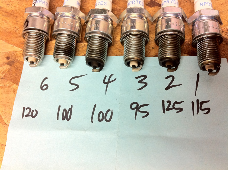

But the red car's been running "OFF" for about a week...
I aborted a drive out to Supercar Sunday last weekend when it wouldn't rev as I got on the freeway onramp.
I swapped carbs, jets, plugs and nothing helped.
I just did a compression check and here are the results:
The plugs pictured have been in for less than 10miles and show real uneven a/f mixes, and of course the compression figures are LOW LOW LOW...
FYI STOCK L24 compression figures should be in the 170-180psi range...
It's unrealistic that I'll get it fixed in time for Monterey Historics in 2 weeks' time, so I'm out... sorry.
But like the phoenix, the red car will rise again...

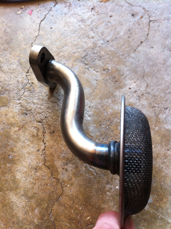

BTW, what pickup tube you got? Is it the L20 one?
PostPosted: Tue Aug 21, 2012 5:50 am
Posts: 570
Kevin,
Picture of oil pick up tube for you:
