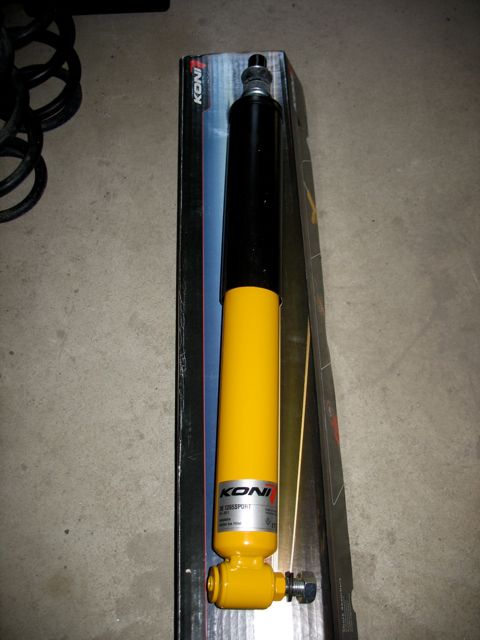

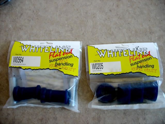

Shorten tube, TRD green shock and 6kg TRD coil, Polyurethane Bushing... along with the AE86 brakes, 9 1/4" veted to replace the 8" solid one, and freshly rebuilded calipers to go with them... forgot to take pictures

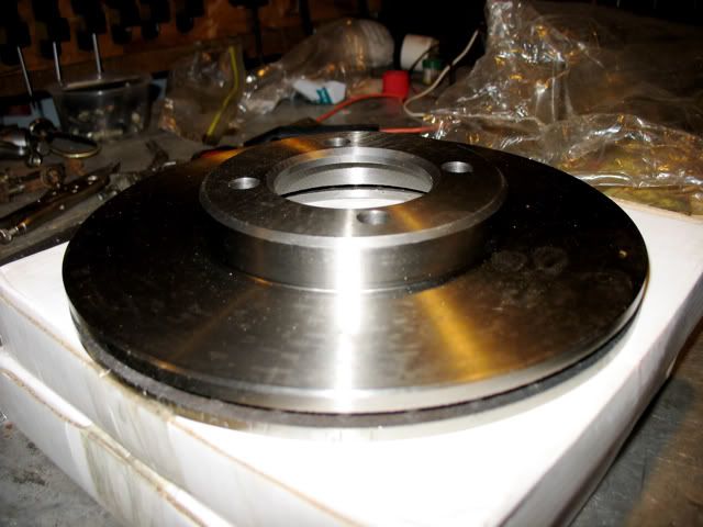

I have found a set of AE86 hub and steering knuckles since none of the KE stuff works... all that's missing is some RCA and I'll probably get a set of bushing adapters for the balljoint to be able to fit hte AE knuckles on the KE balljoint instead of trying to press a bigger balljoint in the KE LCA.
By doing that, I'll change the bolt pattern from 4x110 to 4x4.5... so I'll need to do something about the rear. The plan is to ditch the stock 5.7" or 6" rear for a 6.38" S diff... why?
Because I already have those (bearing, brakes and all)
That will upgrade my rear brakes from 8" to 9" drums to follow the front mod.

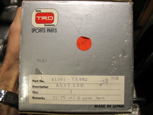

Yeah, that's a uber rare brand new in box TRD LSD for the 6.38" S diff... if I could find someone willing to trade a 6" TRD LSD for that one, I'd probably keep the KE diff and either redrill the axles to match the AE86 bolt pattern or locate some KE30 axles, but in reality, the 6" TRD LSD is probably as hard to find as the 6.38"...
So I ave also located an early S diff that I'll rebuild with all the piece above, I also have whiteline poly bushing to go with it and a pair of those

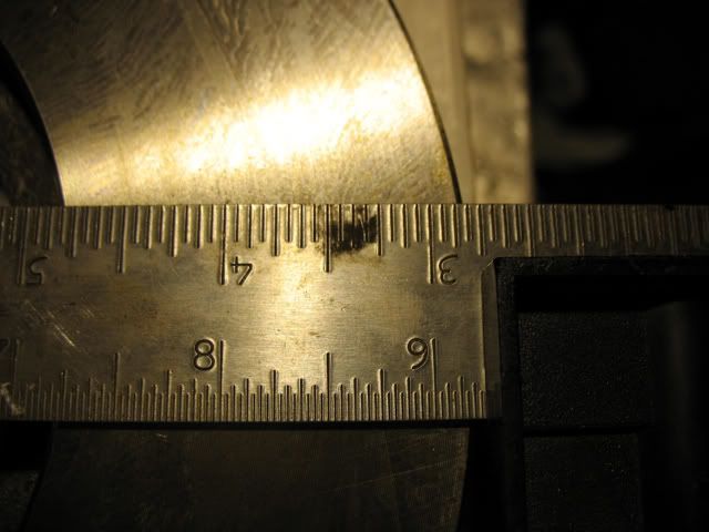

First, I have this mystery cam that came with the car
According to the interwebz, that code is for an aftermarket cam for an Opel CIH engine, ENEM is a scandinavian (or somewhere close) company that make those cam. But it's not an Opel CIH cam, definatly a toyota K cam so I'm thinking it must be a regrind following those specs which are :
Seat to seat dur 308°
came lobe spacing 108°
lift : 11.8mm (with the opel rocker arm ratio... I have no idea how it compares to the 3K)

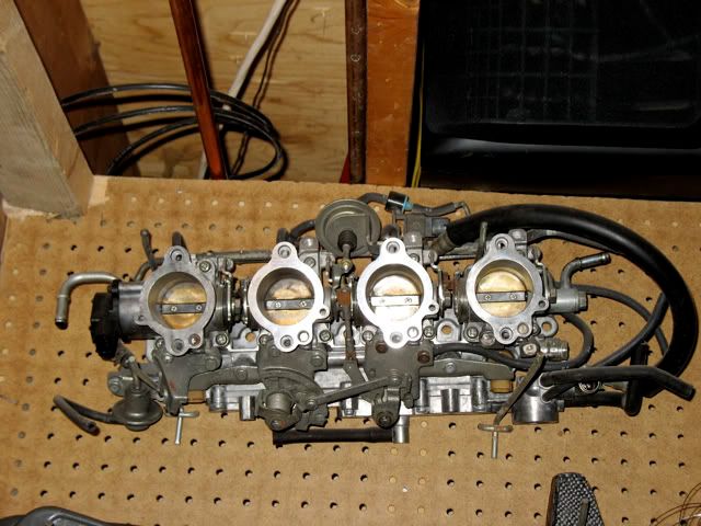

4AGE silvertop intake manifold gathering dust in the basement for the last 5 or 6 years... along with a MS 1 or 2, can't remember...
So the plan might to put both in used on that little engine... milling the block and head and going a little oversize to achieve higher compression ratio. For the management, the plan is to KISS. I plan on using a stock distributor (or an electronic form a 4K) for spark timing and a fuel management with no feedback using the MS I already have : MAP, TPS, IAT, ECT. That's it. No idle stepper or IAC, I'll just modify the linkage so the stock choke cable cracks open the throttle to get a fast idle and I will adjust idle by using throttle stopper screw. I'll only need a little adapter manifold between the head and the throttles of the silvertop manifold. I'll ditch the stock lower manifold with vaccum ports, fuel rail and injectors in order to make some rooms (because there is not a lot between the engine and the strut tower. So I'll need use the ports that are on the throttle bodies for a vaccum signal and to run the vaccum advance on the dist... since the car has no power brake, the only other vaccum that I'll need is the PCV. Also, in order to keep things simple, I'll probably use a set of standoff injectors mounted in the velo stack. I'll have the luxury to mount them deep i the stacks because those 42mm TB are already way to big for the little engine so the injectors will not create to much restriction and that will be a little safer since the exhaust manifold is sitting right under there... but that will mean I can use a standard fuel rail form almost any 4 cyl DOHC car and just modify the mounting poits instead of having to fab one for the weird intake port spacing of the 3K and I'll save the hassle to make injector bung and mounting holes on my adapater manifold (made from scratch) and having to machine all this.

As for a quick update, nothing has been done on the suspension yet but I have sourced all the parts I needed to complete the swap to AE86 front and 6.38" rear... I just need to get going on this. It will probably gain a few extra pound from this but hey, upgrading the brakes from the tiny 8inch solid disk and 8" drum to 9 1/4" vented disk and 9" drum should make quite a difference... and I'm not even talking about the TRD LSD ;)

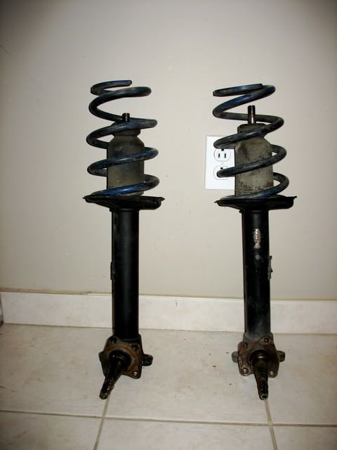

Since I am swapping a whole AE86 front suspension, I needed to find a way of bolting it down. Let me explain...
The KE lower strut bolt spacing is 80mm and the AE86 is 85 so I need some way of bolting my strut on some kind of knuckles. The AE86 knuckle wouldn't fit since the AE uses a bigger balljoint and the AE baljoint is too big to be pressed in the KE LCA. The LCA itself is 30mm longer on the KE so I'd have to modify a AE86 LCA for the front track to stay close to stock.
The easiest way was to get some AE86 knuckles with the 85mm lower bolt spacing and use an adapter bushing to fit over my small balljoint to bolt it on. The problem is that even power steering knuckles are a little longer than the stock KE20 knuckles so it makes up for slower steering... so I went that route since AE86 knuckles are readily available. Their is one other alternative : the TE27 uses the same length knuckles and has the same small balljoint as the KE but it has the same 85mm bolt spacing as the AE... but they are rare.
So after cleaning and painting AE86 PS knuckle, someone came to me with TE27 knuckle he found in a box in his garage... so I'll use those!

And my new 2 ton press to help get rid of those pesky 40 year old bushing...

Now I only need to take out the torque wrench and put some cutter pin in there... apart from that, the hub/disk are mounted on the spindle and the caliper and brackets are bolted on the struts. As soon as the paint dries on the spring perch, I'll slap those on with the coils and I'll only have 5 bolt per side to get all that back together on the car. Don't dispair... I'm getting there lol
Oh and by the way, the Energy Suspension polyurethane bushing that came with the car are complete crap... I'll take the rear leaf bushing dimension and order some whiteline ones and get myself a complete set for the front in order to replace those piece of shit... ES ones are going in the trash because that's the only place they belong. If you need some bushings, do yourself a favor and pay a little extra but DO NOT buy those crappy ones.

Well, I'm finaly done with it!
I'll only need to bring out the LCA once I get some quality bushing to press in there... the worst part of all was bolting the top plate on the strut tower. Was tighter than a virgin and the strut bar wasn't really helping out.
Everything is either new or rebuilded and freshly painted... I just need to refresh the undercoating so it doesn't look all ****ty. I think I'll use bedliner, after seeing what mythbusters could do witht that, I think it'll be up to the task ;)
Oh yeah... upgrade?
But now the sad part...
The stock TE21 steelies look sad compared to the enkei... I'll need to take care of that soon! Oh and even if the coils are TRD 6kg lowering coils, the car didn't drop a mm, probably due to the fact that the AE86 front must weight a good 250lbs more, the coil must not compress enough... oh well, the 4A-GE weight should help in taking care of that issue ;)
Oh and something strange but good came out of this, I went from something aroung 3° or positive camber to 0.5° or negative camber... and it's a hell of a lot stiffer in the front. Now for the wheels, I think I'll try to grab some 14 or 15" to fill the wheel gab instead of cutting the coils and slamming the car.

Anyways, the rear end is out...
I'll be able to swap it out for a 6.38" in order to use my bearing/brake that I bought for the TE... and the TRD LSD ;)
Oh and the leaf packs are out so I'll be able to dearch it and add one or two other leaf in there...

Well, here is the story of my T50... I traded it for the rear polyeurethane bushing I had bought for my TE to the guy that bought it. When I picked up the tranny, the guy wasn't home and it was pouring rain. The thing was wrapped in 3 plastic bags so it stayed dry but it wasn't the best deal. First, the damn thing was stuck in 1st... I told the guy that I would only trade with a tranny that turns without making awful noise and shift through all the gears. Obviously, the guy didn't care about that. Second, it was missing the yoke. I have a bunch of 20 spline for early T and 21 for W tranny, but no late 22 spline yokes... dammit again.

Other problem solved, I finaly swapped my diff with a local member here who builds mini legends. He was looking for a small Toy diff and gave my a very clean TE2X 8 bolt S type (6.38"), which has the same spring perch as mine and the same total width, which is almost 3" narrower than a AE86 housing. It came with axles retaining plate, bearing and seal in perfect condition (I had brand new ones, but I'll problably save them for somwhere down the line. I also got 2 whole set of 9" brakes, back plate and all the hardware, so I got more than a complete axle. And I also got a neat surprise. I was expecting a 4.1:1 two pinion diff from some automatic corolla (since they almost all uses that) but here is what I got:
9/37... 4.111:1, alright, we won't call home because of the gear ratio difference between that and a 10/41 4.1:1 but the 4.111 has less teeths which are a little bigger than it's little brother which makes it a little tougher ;)
The only problem is I that I have no idea where this ratio comes from (maybe a late tercel 4x4 AL25, but I'm not even sure) so I'll try to take care of it... if that's even possible ;)
So while I was chatting with the guy, I told him the "tranny story" and he reached and grab a yoke and told me that he thought it came from a manual AE86 but he had no use for it...
right on! An other piece of the puzzle found
