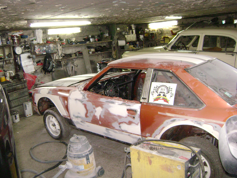

Pics of when it arrived and the dissasembly.

Without the kitt, and some stuff i did on the weekends.

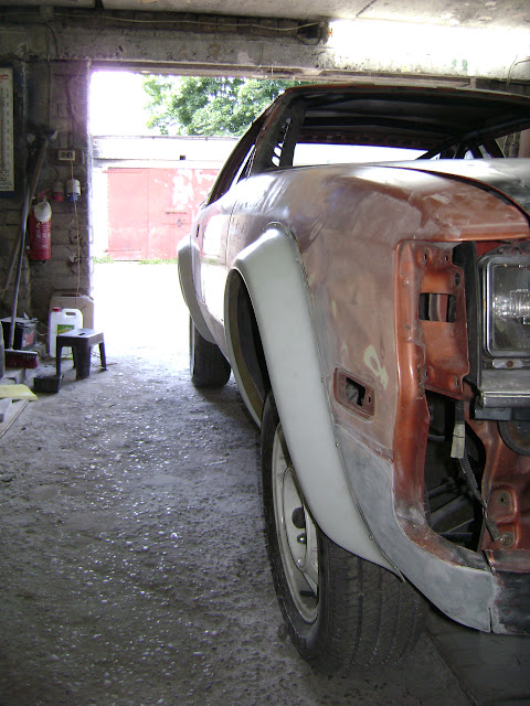

Took some pics of it today. Not sure when i will be able to start the bodywork, have loads of work the upcoming months. Shes a bit dirty tho.
These fender flaires are original trd pieces if im not mistaken, wanted to put em on my car, but then thought theyr just too wide for me.
