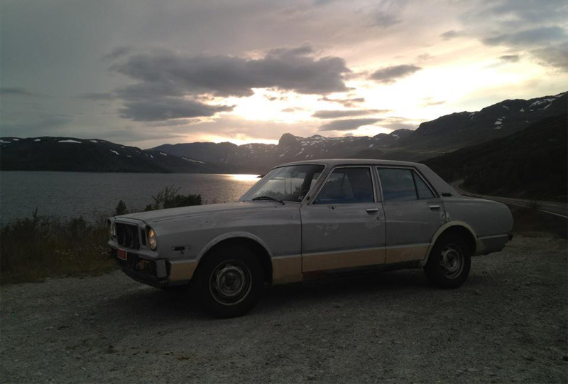

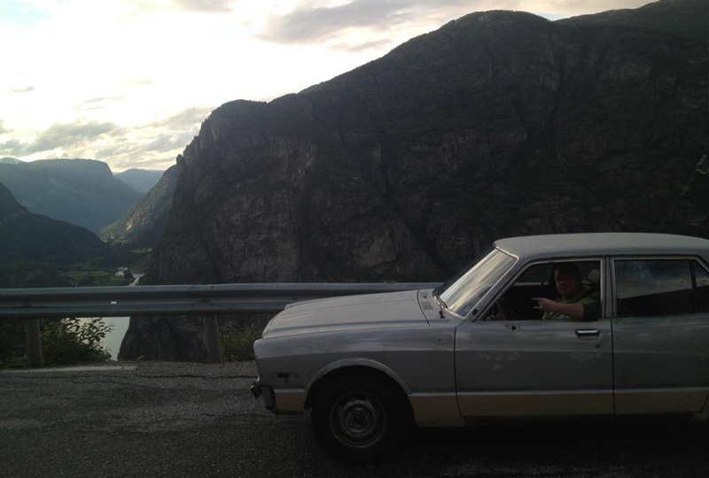

Finally, after years of bad shit happening, karma seem to reward me these days. As luck would have it, I bought two more cars just days before snapping the driveshaft. So replacing it was done in an afternoon with no problems. One of the cars was in pretty bad condition, so I only kept a few bits and pieces like chrome trim and a black interior. The other one was actually drivable, and I drove it all the way home over the mountains of Norway (800 miles/500km)! Here's a couple of pics from the trip home.
Not sure what to do with it, but if it passes the test to get plates, I'll probably paint it white and slam it on widened black steelies or something. Would make a sweet daily driver.
