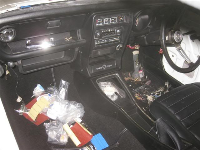

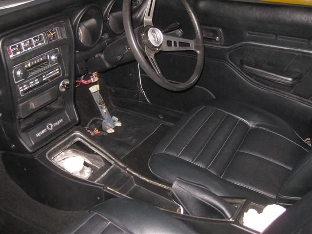

Couple more photos... all coming together. Cabin wiring should all be OK now. Waiting on some Mazda terminals to complete the engine looms, 1hr work max as most is already done. Not entirely happy with the rotary engine console badge so redoing it in a reflective chrome, aside from that its :tu: Steering wheel is same as an SP, late model 808 coupe or Savanna. I think they have a nicer feel than the fake wood plastic ones. Passenger door trim isnt finished yet incase you were wondering.

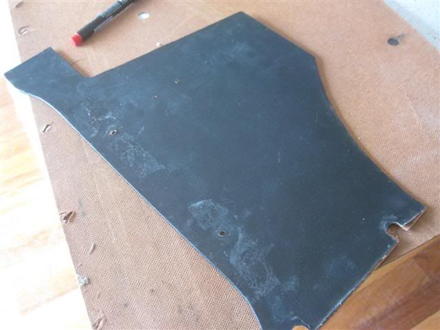

Mounting the door trim vinyl to the new back boards. I used Oxy/TiG wire to make my own staples.
New boards are now mounted. I want to repad the upper area of the trims (the area above the chrome trim) before I glue around the edges.... future update on that one.

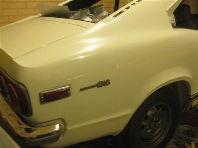

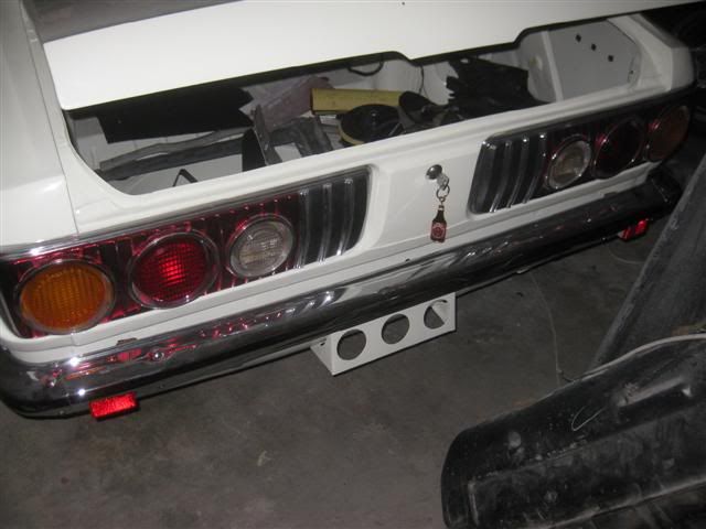

I ended up fitting new tail light lenses that were purchased from Street Lense, Sydney many years ago. He still does them for anyone that wants a set. Pic 2, gluing down the lifted edges on the left kick panel.
The old lenses come out pretty easy, the recesses are cleaned up and the new ones are then glued in using silicon glue in a chalking gun. Kick panel edges are done then I use Eucalyptus oil to remove old tape adhesive that was used to hold the original screws in place.

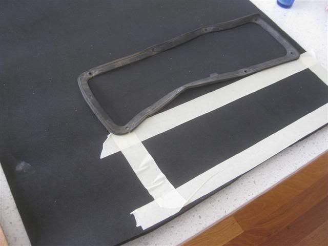

Kick panel ready to go on. Pic 2, making my own tail light gaskets from 6mm sponge rubber.
Gasket is marked out by using masking tape over the top. Pic 2, reflector, badge and one tail light installed.
Rear shot, the other tail light will be fitted shortly. Pic 2, interior almost done, dash is complete waiting for power too test everything out.
Passenger seat and scuttle panel will go in shortly. The car needs a good clean, various fasteners spread across floor related to brake, clutch pedals and various other things. I know where everything is which is the main thing :) Once the seat belts are done I'll give it a good clean. Pic 2, attaching the door trims to the new back boards. Guy in Sydney did a great job making them. The trims are only glued around the pressings so thats the only place where I placed the glue.

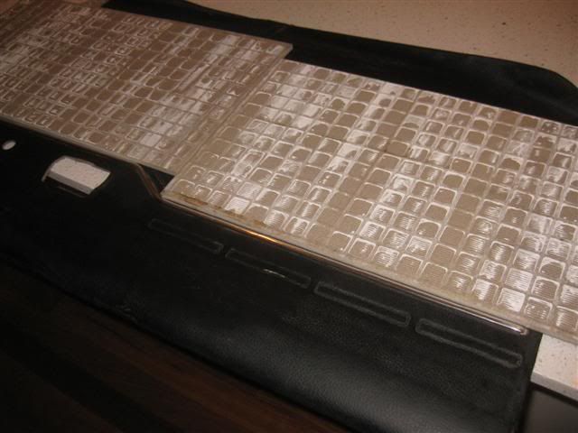

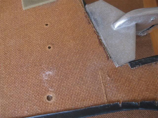

The trim is then flipped over and I place a couple of heavy tiles overnight to make sure the vinyl bonds nice and flat with no wrinkles. I'll be padding out the upper section with new foam and pulling it taught. The passenger side is 5 shades too light so it'll be given to a trimmer to dye the fabric back to the original colour. Its a chemical bond process and not simply vinyl paint over the top. Aside from that the vinyl is still nice and soft.

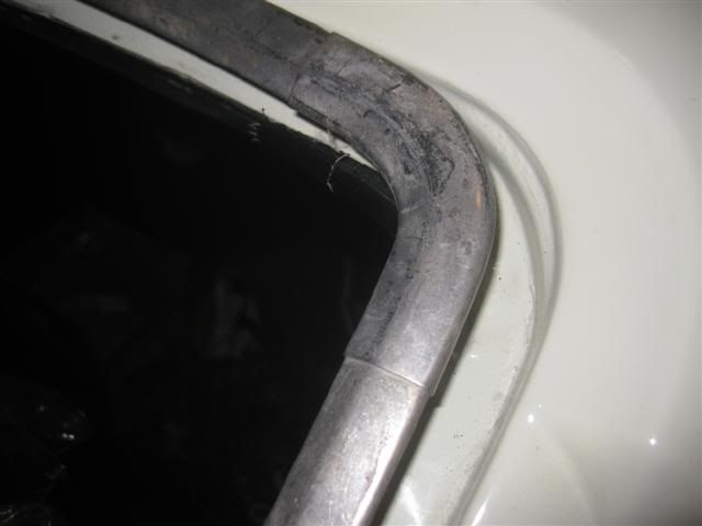

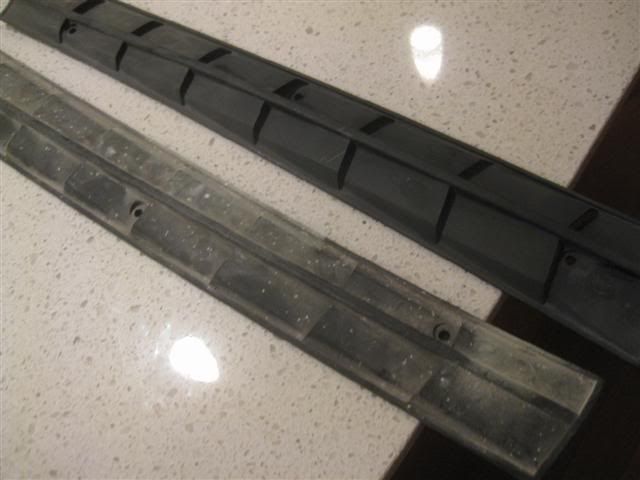

Starting to repair the rear bright work, a few dents, twists and lots and lots of scratches. Will take a 2 or 3 hours to have them looking their best again. I had Dave (Restoremaz) do the gutter chrome a few years back which is ready to go in shortly. Rick from Mazbitz also did a few bits for us. I decided to do the remaining lot during a weeknight when not much else is going on.... fiddly work.
I blasted 5 layers of paint off the rear vents a few years back to reveal pretty good plastic. One of the previous owners must have had a fetish with colour matching blue, red and green because those colours where colour coded everywhere :lol: I'm tempted to leave them in natural plastic but there are not quite perfect. I'll probably drop them off to Ricky, it'll save me some money mixing up paint and buying plastic adhesion promoter so the paint doesn't peel off. He has a couple of bits for me that I need to pickup anyhow.

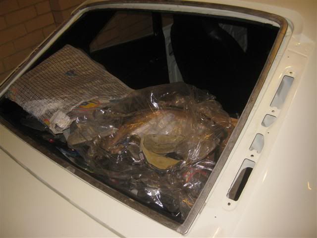

Thanks, I've also finished repairing the rear windscreen chrome. Turned out pretty good. If anyone knows where to buy a new rear screen with the demister let us know, thinking about having the windscreens installed shortly. If I can't find a new rear one I've got a couple of used ones that I'll need to buff up and pick the best of.
The diff housing is all a part as well so I can give it a coat of paint. Thinking of installing a 3.9 instead of the stock 3.7. I've got an LSD which I'm thinking about putting in as well. LSD will most like be sent away as well, I've learnt enough skills, I'll leave that one for the professional. Brake booster has been sent away to be quoted on reco'ing. Drum brake backing plates are also away at the blasters. I was surprised to find the rear axles are different lengths, learn something everyday.
Lots of small fiddly stuff to do, front windscreen chrome is the next job on my list then passenger front window, seat belts take #2, the list goes on.

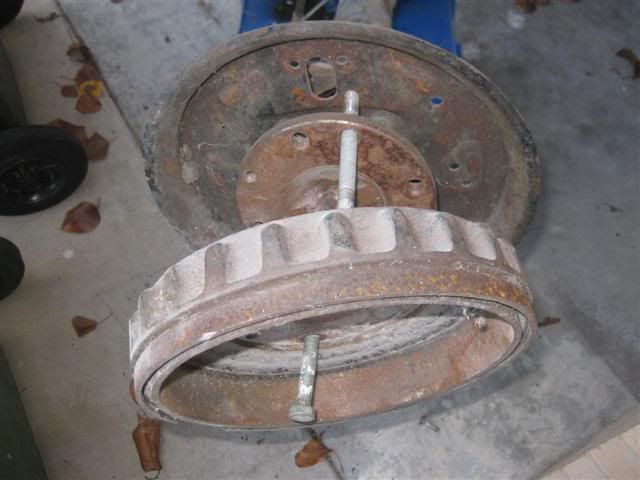

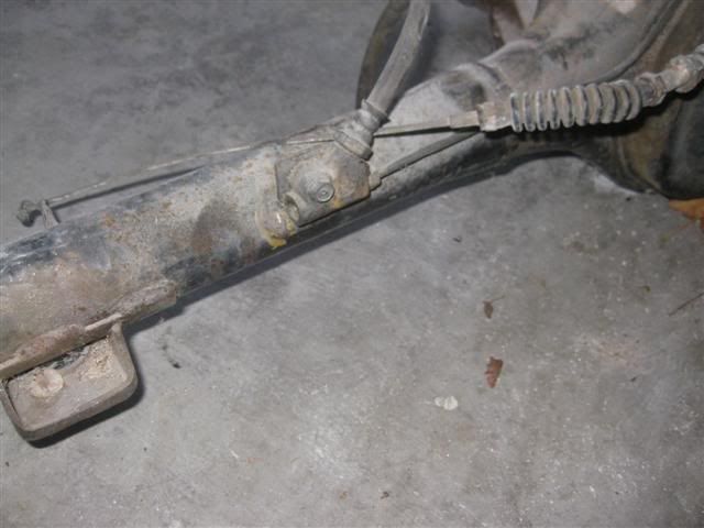

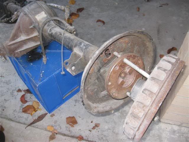

Pulling apart the 808 diff housing for a rebuild and paint. Brake lines coming apart using a pipe spanner.
Brake drum backing plates have been sent to the blasters. I'll paint them once I get them back. Pic 2, I forgot how much diff oil stinks !
Not sure if this is present on early diff housings like the one currently in the car (10a one) but you can see oil baffle plate for the axles.
Diff will be sent away for a reco and an LSD installation. I'll most likely install a 3.9 gear set instead of the 3.7. I have a 5th gear now so that will make the car nicer to drive. The brake booster is currently at a brake specialist getting overhauled. I tried cracking it open without success so decided to send it away. It needs a new pivot made up which Im unable to do (don't have the tools) so made sense to drop it off to a specialist.

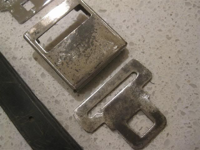

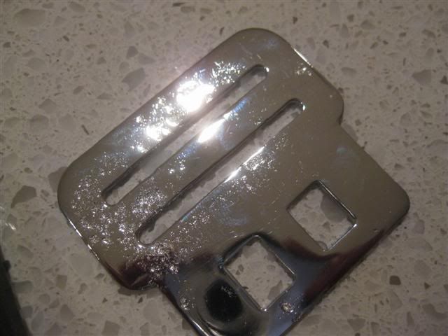

Seatbelts take#2 ! This time I'm having them copper plated only and I'll repair the minor pits myself. Front seat belts tongues are single hole, rear are twin hole. Once I repair them there will be another copper coat then a bright nickel/ cobalt shiny chome plate. Pic 2 the headlight buckets, pedals and various other bits have been blasted and ready to go on.
These are the rear seat belt buckle covers. They have a plastic wrinkle finish but they normally chip and rust between the metal cover and the plastic coating. I had these sandblasted and powdercoated in a textured finish. They came up really good. The button will have a chrome finish with a rotor symbol in the middle. I saw a new set of original seat belts like this, never seen them before but thought it would be a nice touch. No idea if this detail was present on Rx3's but I like it ! Pic 2, pedals and accelerator ready to go on. I bought new pedal pads from Mazda, approx $5 each from memory.
Front seat belt buckles are different to the rear ones. The plastic coating typically cracks unfortunately, they work fine otherwise.
The fix is easy, dual wall 24mm (when shrunk) heat shrink. Dual wall means the wall is really thick and durable, typically double the thickness of standard heatshrink would be my guess :) The inner wall of the tube is coated in hot glue. The stuff is available from Jaycar Electronics if you're chasing some. Cut to length and slip over the stalk.
Apply heat, the tube shrinks, glue melts and we have a new looking stalk again 8) Pic 2, I finished repairing the front windscreen brightwork. Thankfully I've almost finished the lot. I have the long stainless sill (rocker panel) trims to repair and polish, the shark fins that sit in front of the rear lower wheel arches and that should be it.

About the rear glass. Don't you give them yours and they copy the dimensions to produce a new one?
 Post subject: Re: 1973 Mazda Rx3
PostPosted: Thu Jul 12, 2012 10:55 pm
Posts: 510
There is a bit more involved than that as the glass has a curved profile that needs to be matched so it fits right. Producing glass without the demister is relatively straight forward if you find someone who has a kiln.
If they have a demister the manufacturer needs to tool up in order to produce them with a rear demister.
I'm trying to see how many people are interested in buying reproduction rear Rx3 808 windscreens with demister installed. I'm meeting up with a manufacturer next week if my work commitments allow. Depending on numbers they will cost anywhere from 400 - 800. I've only been given rough prices at this stage. They will take 2 -> 3 months to manufacture, the tooling to produce the rear demisters on the glass is the killer. If anyone in Australia is interested send me a PM so I can get an idea on numbers.
If it turns out to be viable I'll contact interested people and a depot will need to be paid. In terms of delivery I plan on dropping off the glass to a Pack and Send depot where buyers will need to pay for frieght to their door with insurance if they wish. I'll provide more details after I meet with the manufacturer.

Mazda Rx3 / 808 inner weather strips for sale here.
viewtopic.php?f=10&t=17421
