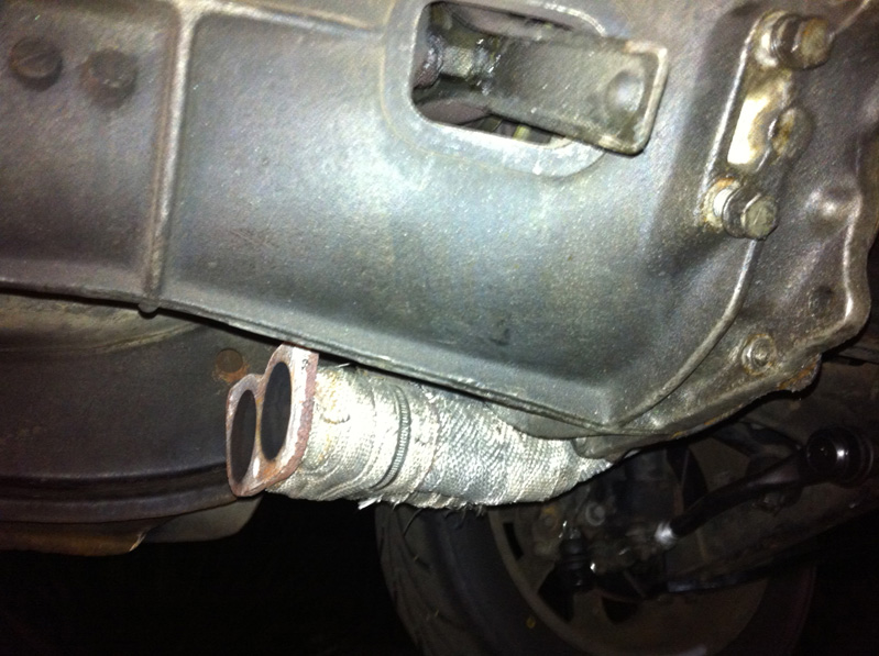

I made the decision tonight to pull the tranny and do something about my loud throwout bearing - better now than on the side of the freeway going up to or coming back down from NorCal in less than two weeks' time!

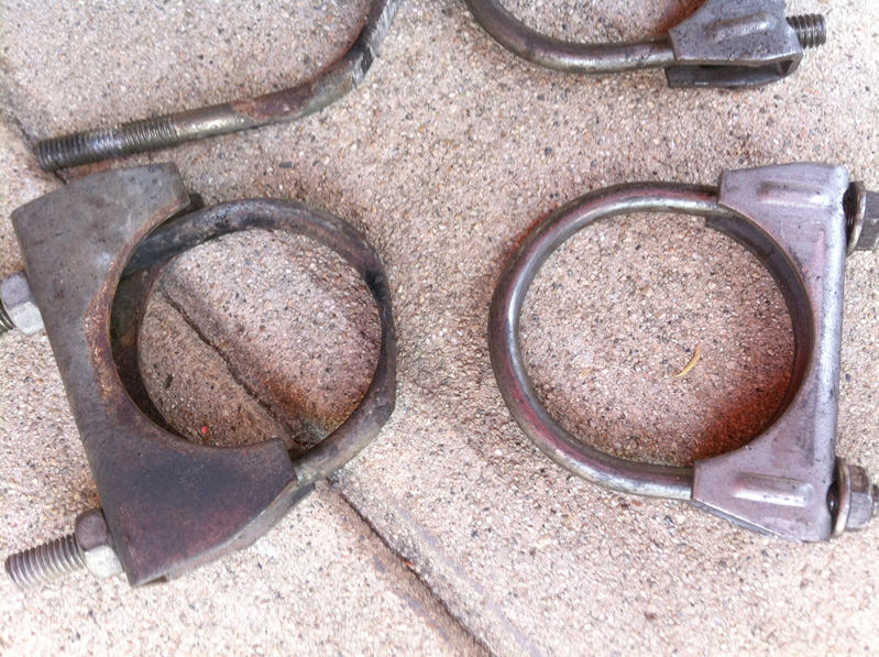

Pulled the U-bolts off of the exhaust... wasn't much left of them due to exhaust hanging low and car sitting even lower... this is the GOOD one on the left, the other one was worse. New 2" u-bolt from the local muffler shop on the right:

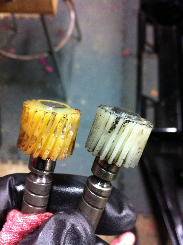

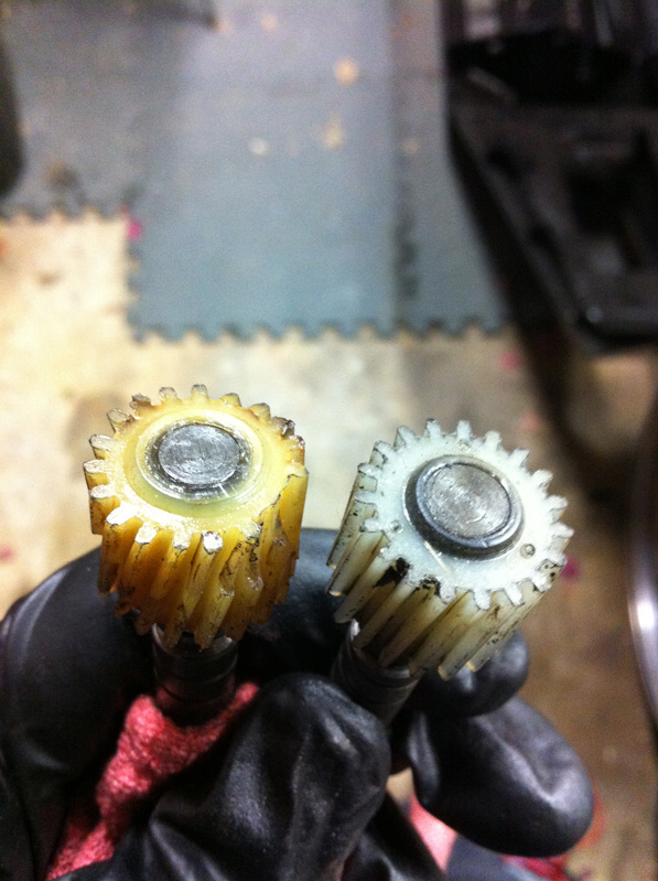

Pulled the speedo gear and boy did it look thrashed... surprisingly I had very little bounce at the speedo gauge... no outward signs that the gear was in this bad a shape - thankfully I had a used spare in my kit of parts...
Was very pleasantly surprised by the driveshaft bolts that are on the car... Check them out! The ones on the car had a nice oversized D-shaped head that makes installing / removing them a single tool operation... The shiny new one is what's commonly available for S30 Z here in the States at places like MSA... Requires two wrenches and is a hair short and can be a bit of a P I T A... New and old share the same pitch / thread! Score a WIN there!

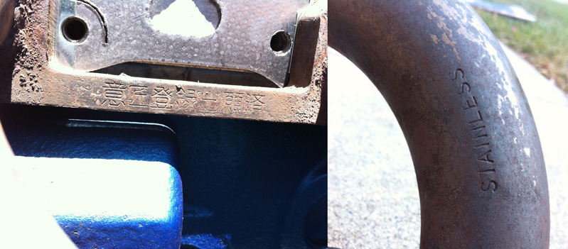

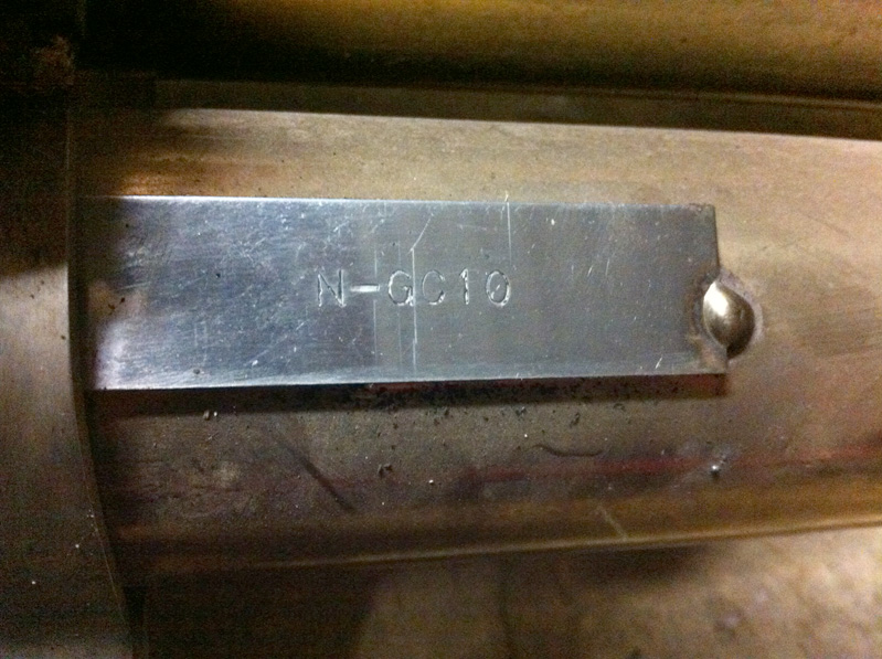

Someone had asked me for more details about the stainless exhaust on the red car... I looked all over and found only the marking below which basically stands for "Nissan - GC10 series" - not very helpful to ID brand... I can tell you it's two 2" tubes that run the whole way back to a muffler with two in / two out. No additional resonator.

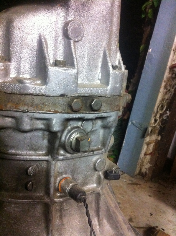

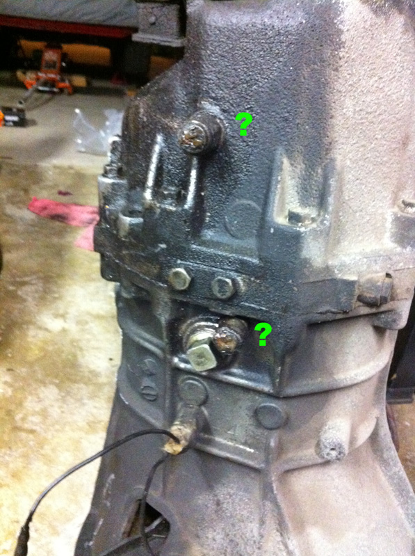

Car came with a 5spd.
Looks to be garden variety "two ear" 5speed from later S130 ZX car...
It looks nearly identical to the S130 ZX 5spd I have in the Z - comparison pics below where the clean one is the Z's 5spd, and the dirty one is the red car's 5spd:
Skyline mystery double extra reverse switches...
S30 Z - no mystery double reverse switches...
I want to pull the "extra" reverse switches and plug those holes cause tranny fluid is leaking from there... but I find it very very odd that someone tapped those holes and used old reverse switches to plug them.. Any thoughts?

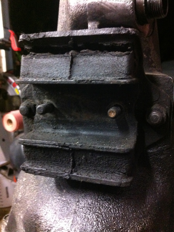

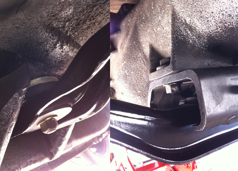

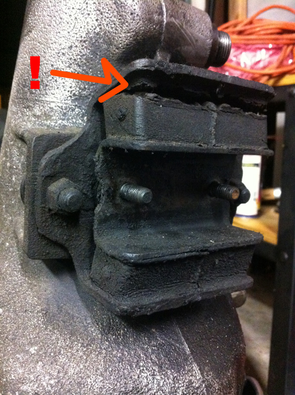

Tranny rubber mount is pretty shot.
Do any 510 or Fairlady Roadster guys on here recognize this mount?
It's not the same as S30 Z... S30Z has a single center bolt that attaches rubber mount to frame bracket
But Skyline has two bolts and obviously frame bracket is different...
Thoughts?
Thanks!
PostPosted: Thu Jun 21, 2012 3:48 am
Posts: 384
Location: Litchfield Park ARIDzona
Hey E, know anyone with a Fowdy??
all my S14's had a very similar tranny mount, MIGHT be the same, BUT don't just take my assumption LOL
i can get you a replacement for about ¥4000, give or take. they are all over the auctions.
i think my tranny only has the one reverse switch, its very weird!
PostPosted: Thu Jun 21, 2012 11:02 pm
Posts: 570
Tim is definitely on to something, S13/S14 rubber mount looks like it WILL work...

NICE! i was suspicious every since i pulled my tranny, wish i had thought about comparing that while it was out, I'm sure theres an SR tranny laying around the shop.

yes the trans mount will work curreNtly what is in my c10...yes you will need to lower mount bracket to get right angles on drive shaft ..althought depending on how high it sits might not be to bad i shimmed mine about 1/4 inche but i have rb20 trans aND RB MOTOR...
PostPosted: Fri Jun 22, 2012 11:15 am
Posts: 570
Cool
Thx for confirming

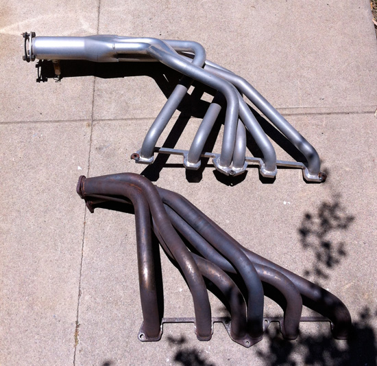

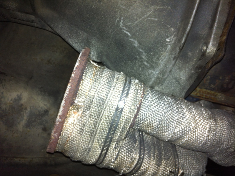

remember the wrapped header from the beginning of this thread? the wrap was so brittle and old that in places it came off like paper... why would anyone want to wrap something so good looking? the wrap unfortunately killed the finish on it over time... we'll see i might get it coated ...
can anyone translate the stamp on the header flange for me plz? I can do some hiragana / katakana, but no kanji...
simple comparison of US 240Z aftermarket header vs Japanese C10 header

I really wanted the S13 / S14 tranny rubber mount thing to work (other thread), but it didn't work for me... The newer rubber mount was just too thick and in my case put the top of the tranny right up against the top of the trans tunnel... your car might be different - didn't work for me... You can see I ran a couple thick 3/4" bolt washers (1/4" total thickness) to space down the bracket) and that wasn't enough... bummer...

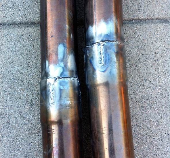

I was still having a hard time getting the mid-pipe and rear pipe to seal properly, so I had them welded shut... I did the same thing a while back on the Z to help get rid of exhaust fumes in the cabin ...

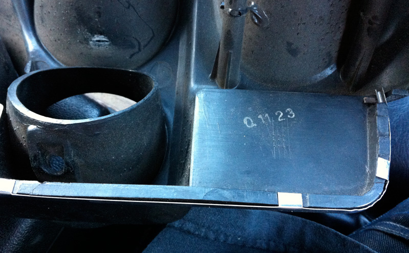

Pulled my gauge cluster to try and work on my nun-functioning tach, and discovered the closest thing to the car's birthday! The gauge cluster trim panel was made on November 23 1970 - I guess I'll make Thanksgiving, the car's birthday then... seems fitting, yes? :D
