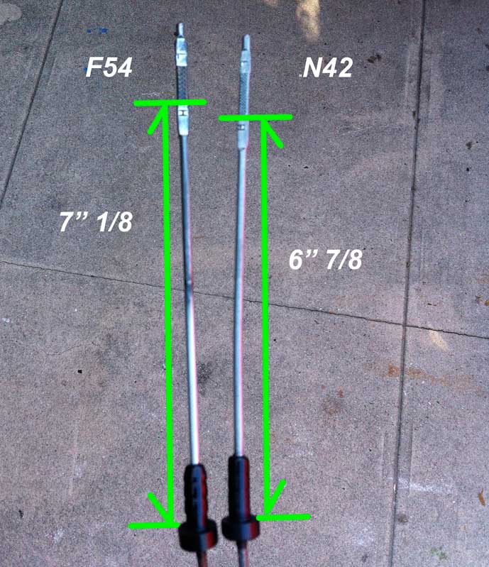

Can we talk about dipsticks real quick?
I measured the one in the skyline (N42 L28) vs the one in the 240Z (F54 L28)
From the lower lip of the rubber stopper that seats the dipstick in its dipstick tube to the top of the hash marks of the oil level
Skyline: 6" 7/8
240Z: 7" 1/8
If you accidentally used a f54 dipstick in a front pick up n42, your "full" oil level would be about a 1/4" low
On the Skyline it takes me about 5.5qts to reach the full level indicated on the dipstick
Overall length of the N42 dipstick from lower lip of rubber stopper (as before) to the far end is 8.5"
I'd be curious to hear what dimensions a stock L20 dipstick has and maybe also a dimension of how far back from the front cover it's placed...
 Post subject: Re: Hakosuka Parts Interchageability Thread
PostPosted: Sat Jul 07, 2012 5:16 pm
Posts: 2212
My N42 has the stick relocated to the front sump position, and the length is 8.5in (thats what she said).
And when I tip in the regulation 4.7L, the oil level goes waaaaay above the full mark on the stick, in fact way past the low to high lines, and about 2mm higher than the top of the "H".

A pic to better illustrate what i was talking about in case it was unclear:
