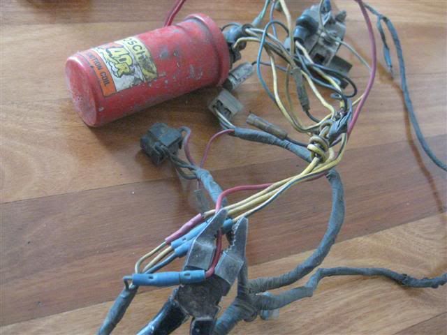

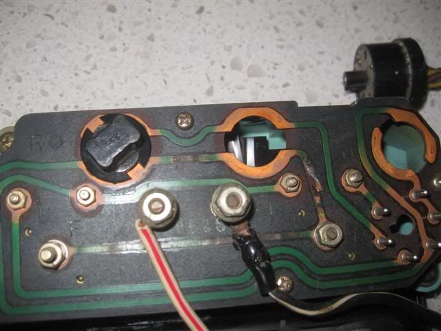

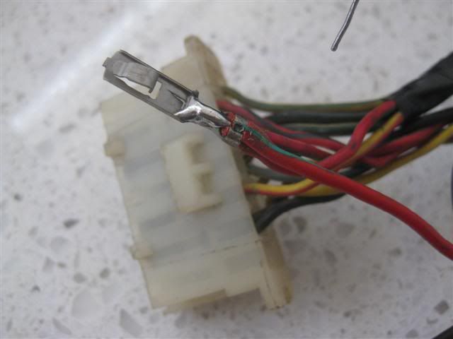

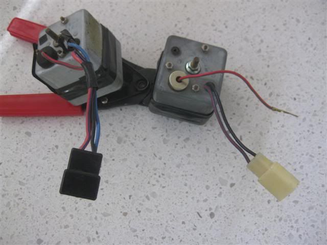

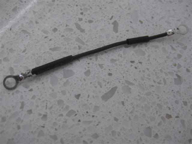

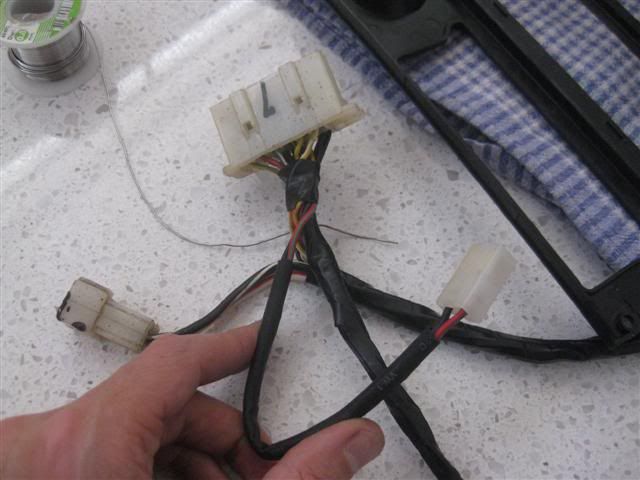

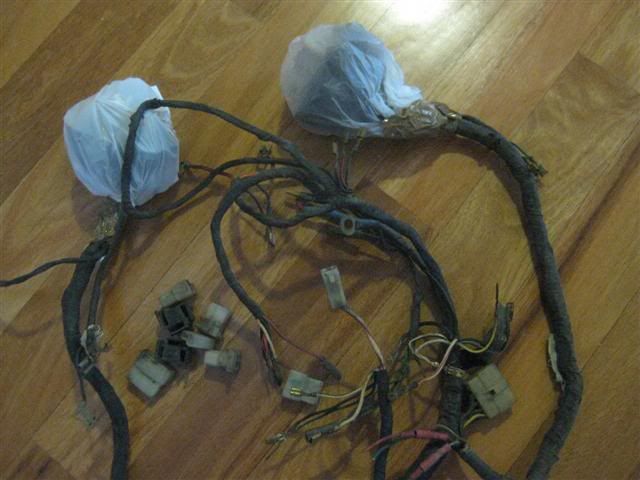

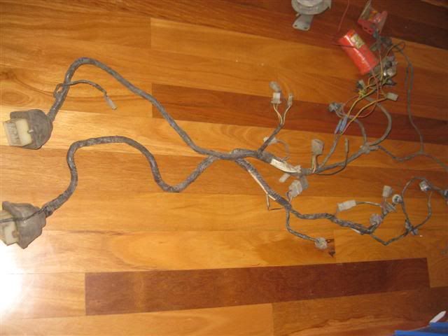

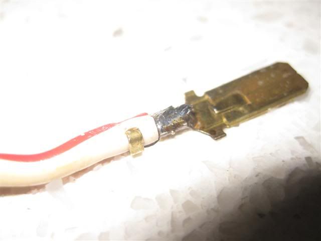

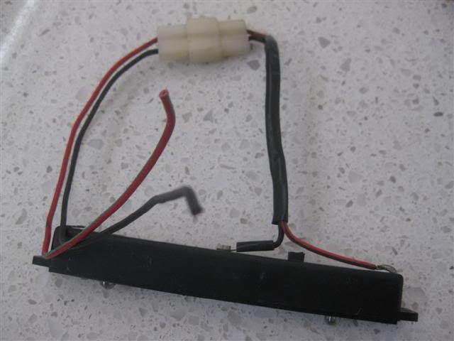

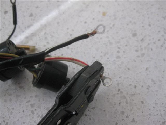

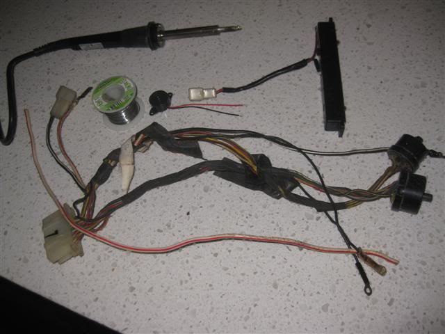

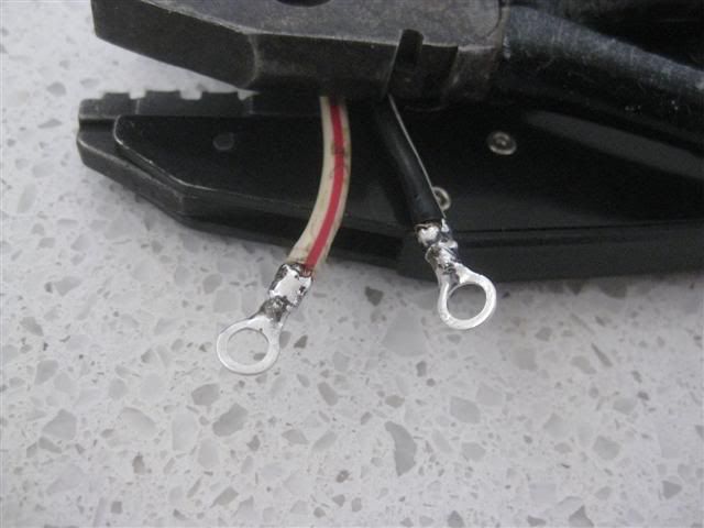

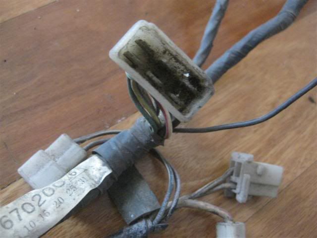

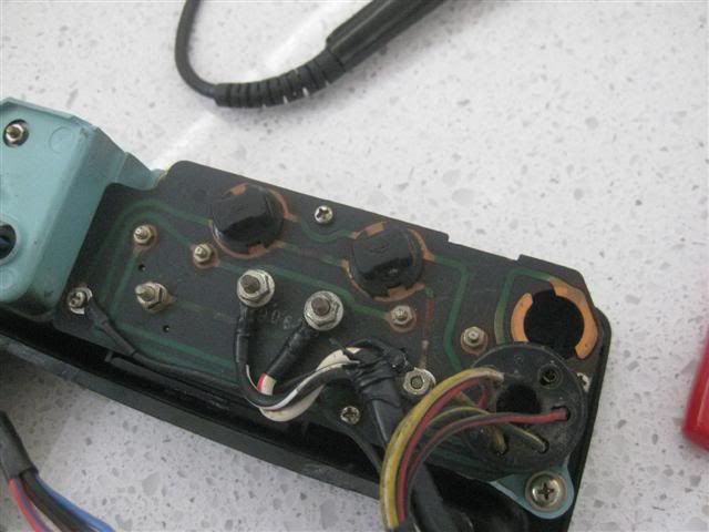

While working more on the harnesses and tracing various things I thought I'd show a difference between early model and late model cars. The late model engine bay/ firewall harness is larger and will not mount to early cars. My guess is the extra connectors are for Anti Pollution cars. So if you see the larger style harness in an early model car you'd want to do some thorough investigating ! Pic 2, bad photo, there is a white wire with a black trace coming from the back of the taco (one of three). This wire has a male bullet connector. There are no other connectors aside from the big round one. Does the W/B wire connect to the black only female bullet connect behind the dash ? The female bullet plug is right next to other big round one that connects on the back of the cluster running off the main harness.
There are no other W/B wires within the car and definately none that pass from the cabin (LHS and RHD) into the engine bay. Doing a quick trace of the circuit board at the back of the cluster it looks to possible an earth. Also there is no W/B wire on the ignition harness.
Image Image

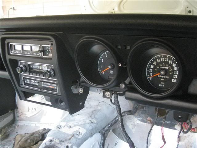

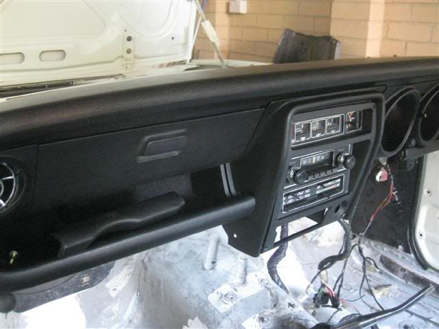

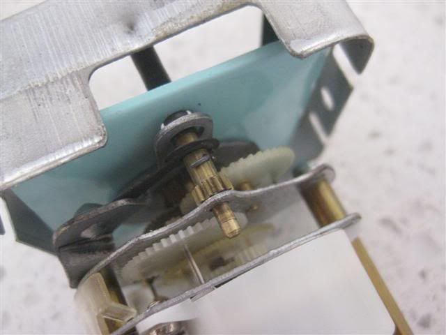

I had to make a little bracket to attach the ashtray holder to the base of the fan controls as the mount spot is in a different area to the original fan control unit. The original is offset, the Savanna unit is not. Pic 2, I think the center dash unit has been pulled apart and checked for the last time.
Couple more photos... all coming together. Cabin wiring should all be OK now. Waiting on some Mazda terminals to complete the engine looms, 1hr work max as most is already done. Not entirely happy with the rotary engine console badge so redoing it in a reflective chrome, aside from that its :tu: Steering wheel is same as an SP, late model 808 coupe or Savanna. I think they have a nicer feel than the fake wood plastic ones. Passenger door trim isnt finished yet incase you were wondering.

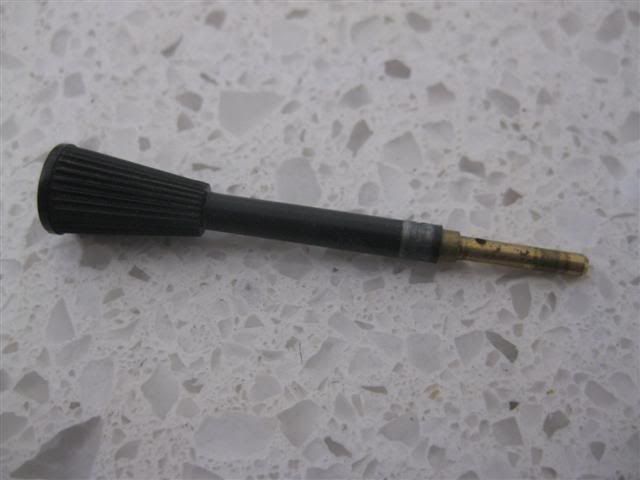

Front seat belt buckles are different to the rear ones. The plastic coating typically cracks unfortunately, they work fine otherwise.
The fix is easy, dual wall 24mm (when shrunk) heat shrink. Dual wall means the wall is really thick and durable, typically double the thickness of standard heatshrink would be my guess :) The inner wall of the tube is coated in hot glue. The stuff is available from Jaycar Electronics if you're chasing some. Cut to length and slip over the stalk.
Apply heat, the tube shrinks, glue melts and we have a new looking stalk again 8) Pic 2, I finished repairing the front windscreen brightwork. Thankfully I've almost finished the lot. I have the long stainless sill (rocker panel) trims to repair and polish, the shark fins that sit in front of the rear lower wheel arches and that should be it.
