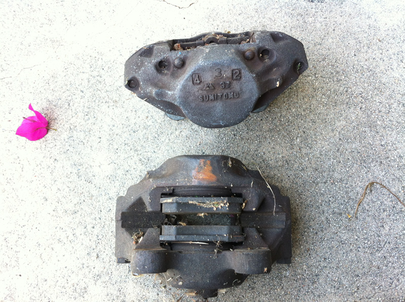

BTW Reid, here's a pic of a (dirty) stock S30 Z caliper.
Pad material measures 2" 15/16 x 1" 7/8
I would be very surprised if you can't use S30 pads on your stock GC10 caliper - please confirm...
Those look just like C10 calipers to me...

Posts: 8682
FWIW, they were also used on the Toyota Crown, as well as at least 20 other cars. :mrgreen:

john wrote:
The usual Datsun-upgrade Toyota pickup 4 piston caliper should just bolt on, I would think.
 Post subject: Re: DeRuX's GC10 skyline
PostPosted: Mon May 21, 2012 5:29 pm
Posts: 8682
Yes, it should. :tu:
