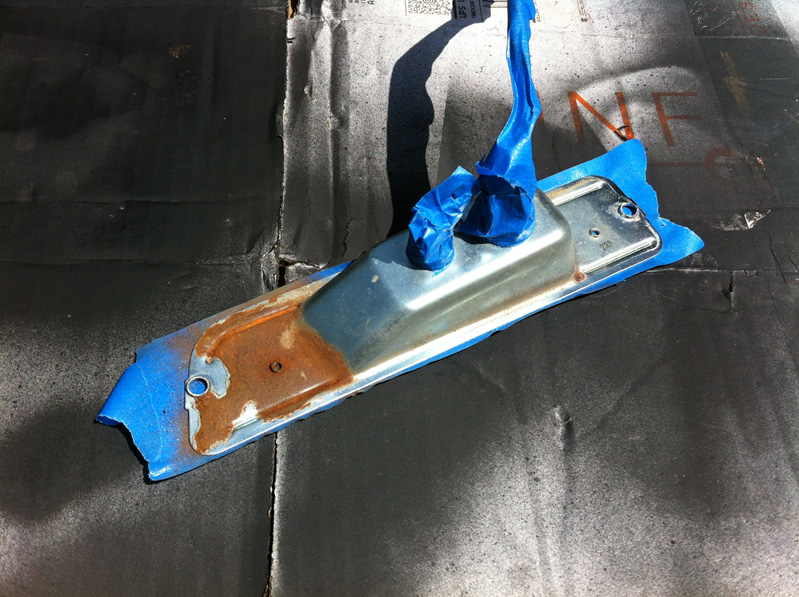

Pulled front lights, was looking for rust in the housing and found a bit on back side.
Treated rust and then painted back side with rust preventive paint - did both sides - and for good measure cleaned the wiring contacts and put a dab of dielectric grease in the housings:

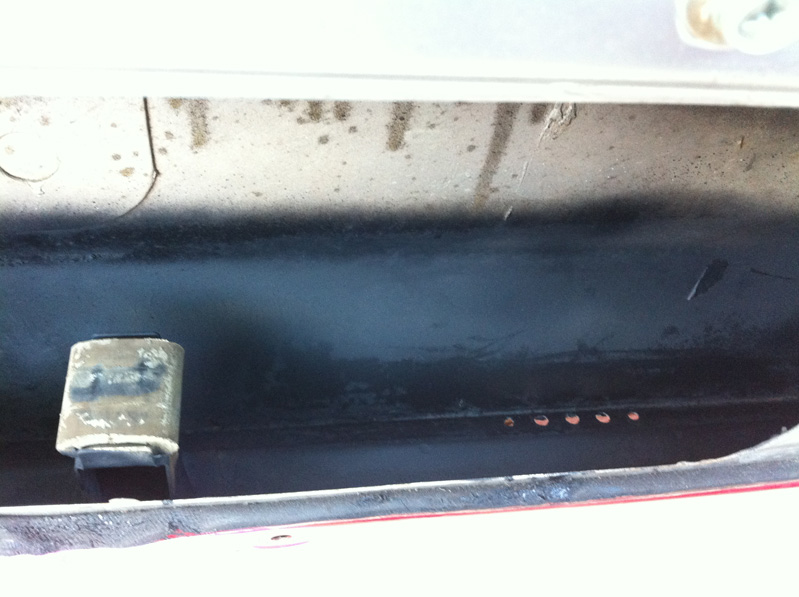

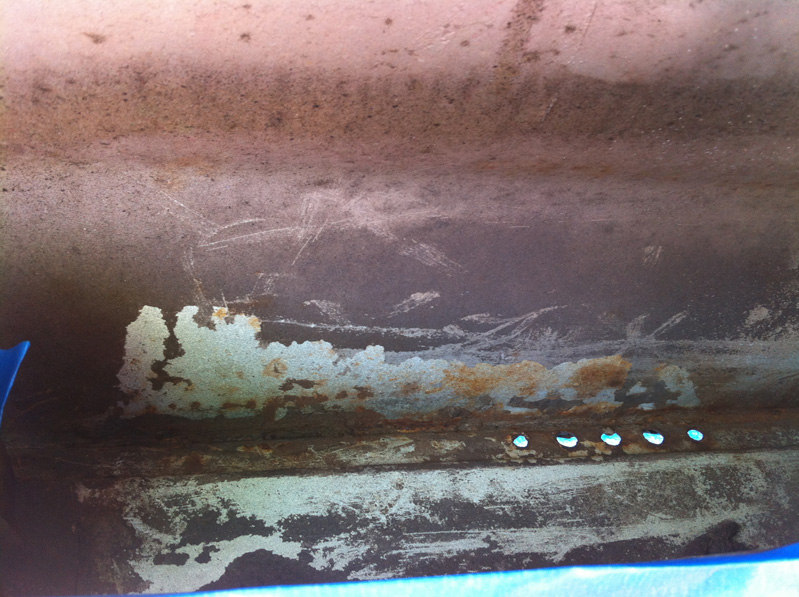

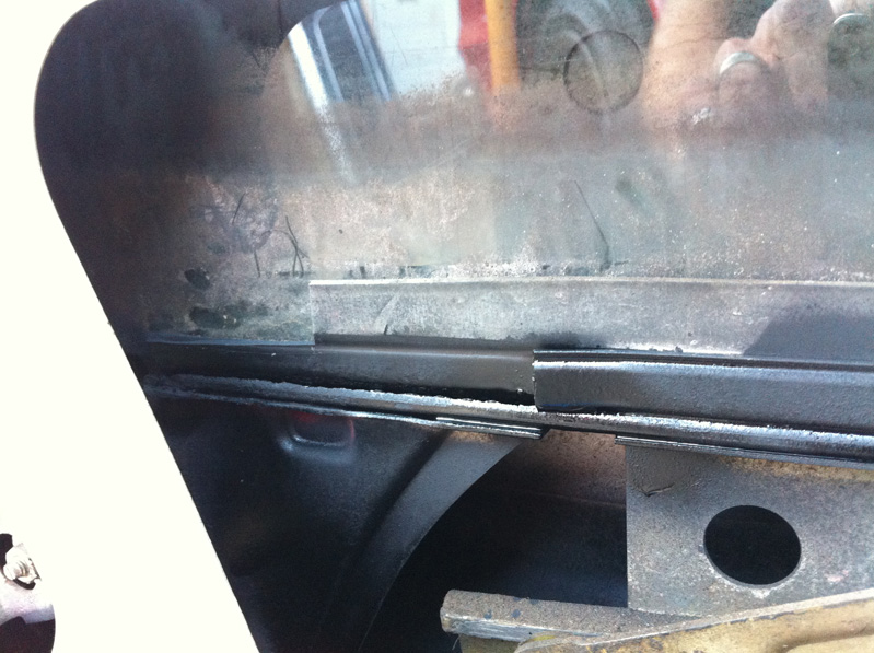

Passenger side window was sticking a bit on the drive down when you wound it all the way down and all the way up.

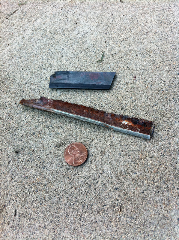

A portion of the glass flange had rusted so much that it was getting caught on the insides of the door when you wound it up and down.
Cut off the offending parts (smaller than they look), and treated rust to hopefully nip it in the butt.
Peeled the vinyl covering back, and thoroughly cleaned out the bottom inside of the door - there's always a lot of crap down there which clogs the drain holes, then you get moisture build up and rust bubbles aren't too far behind - the S30 has it pretty bad there.

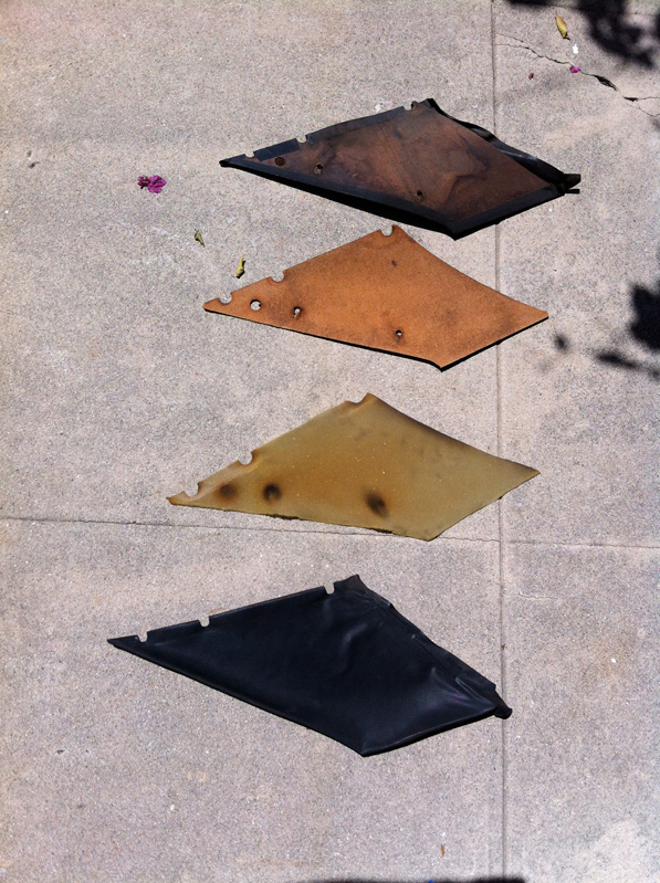

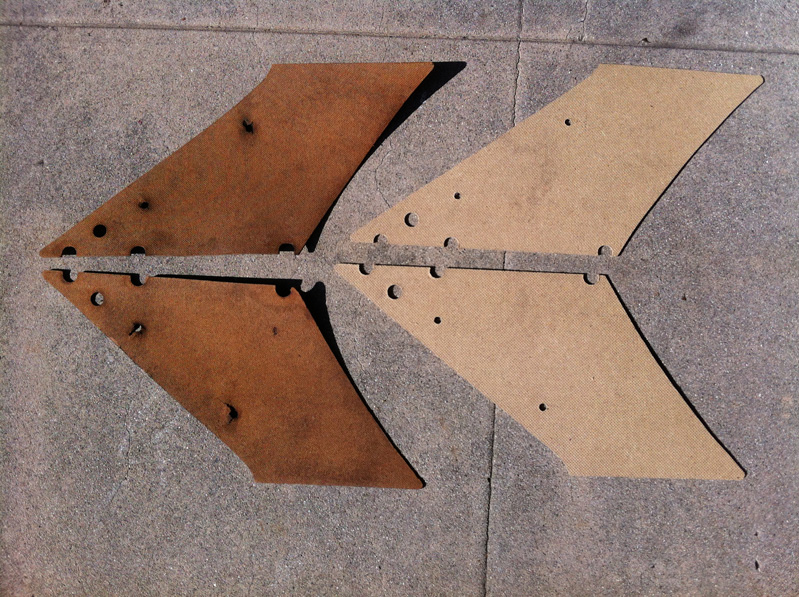

My interior c-pillar trim was flapping away on the drive down... Wait till you see how it's actually attached to the sheetmetal... But before I get there, I had to pull them off the car and boy were those pieces of wood warped... Carefully peeled back the layers as I wanted to re-use the foam and the square pattern vinyl of course.
Made templates, and cut new ones. Used some 3M Super 80 spray adhesive to bond the vinyl to the the wood - worked great.
Did both sides. I owe you a pic of them installed back in the car...

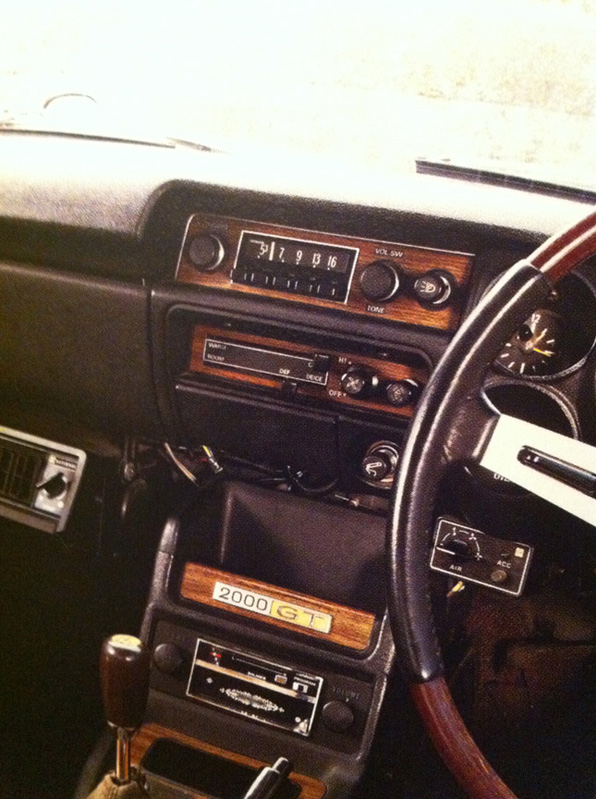

I have another question for you guys...
For reference, out of the C10 authority:
GT & GT-X
GT-R
I have two giant gaping holes where the radio should go, and where the 8track (GT/GT-X) and flip down cubby (GT-R) are located.
I'm also missing the upper half of the black plastic trim above the "2000GT" badge - I would like to fix all 3 issues...
My car's loud enough that a radio is nearly pointless.
The GT-R radio delete block off plate is a pretty clean solution but I'd be surprise d to hear it's even still available. Any one now?
But beyond that, IF I found this radio block off plate and didn't have to negotiate away any vital organs to get it, I have a further question about how it covers the radio hole: Is the stock GT / GT-X fake wood trim around the stock radio really a separate piece of plastic from the textured black plastic surrounding frame. I wonder if that's available too. ?
I'd like to get the GT-R style flip down cubby hole - I thought I saw one sale recently but don't remember where...
I'm also missing the top half of the center console trim that is immedately above the "2000GT" badge - anyone know if that is still separately available as a single piece?
And finally, I have the full complement of toggle switches in the front half of the center console (RearDefroster, Wipers, Washer, and a toggle labeled "F"). When I turn it on it seems to do exactly the same thing as what I expect the later "ParkingLight" knob that GT / GTX / GTR seem to show as available in their cars.
I think it used to be available as a repro a couple of years ago (I vaguely recall they were available when I first got my car) but is sold out. I'd like to get one too.
I guess we'll find out, when you trade some organs and get one :D
You could always jam a DIN-pocket in there from a modern car?
Let me get back to you on that one...there is a Yahoo Auctiosn vendor with a lot of stuff, I bookmarked it at my home PC

those top pieces for the dash (Where Kev was saying they put the AC systems) are on YAJ regularly, but they run around Y7500 used, so i have been putting off ordering one for a long time.
i actually installed a cd player in the cubby slot on my center console, as miune had a huge gaping hole it it too when i got it. it also had some half assed wired switches installed, and ALL the OEM switches in the concole were just gone. it took em close to a year to find two of them. still missing the WA switch. im working on it though LOL.
Here's one: http://PAGE21.AUCTIONS.YAHOO.CO.JP/JP/A ... J160933088
From the top of where the stock radio should be to the bottom of the ashtray/lighter is one piece and come out as a single unit. If it has been cut (this is VERY common, as many owners in Japan would put a triple gauge cluster there) you will need to replace the entire piece. Ensure you disconnect the heater core cables at the heater core itself, NOT at the switches. I did this to my Hako as well, I was lucky enough to find a complete piece with the original Hitachi Radio at the NISMO Festival back in '06. I will try to get a friend to source one for you if that is the route you want to go.
That particular item is very hard to find, I have only seen it for sale once in Japan, and it was very pricey. It is not available through Nissan Parts and reproduced replicas are not being made yet.
I am also missing the top half of the center console trim that is immedately above the "2000GT" badge - anyone know if that is still separately available as a single piece?
Again another non-reproduceditem, you'll have to find this NOS like the one mentioned above by NorCal510. To do a search on Yahoo Auctions Japan use this: スカイライン ハコスカ
You could kill 2 birds with one stone and pick this up (It comes with the top piece your looking for and the GT-R delete covers for the "Rear Defogger" and "F" switch:
http://page.auctions.yahoo.co.jp/jp/auction/153016410
