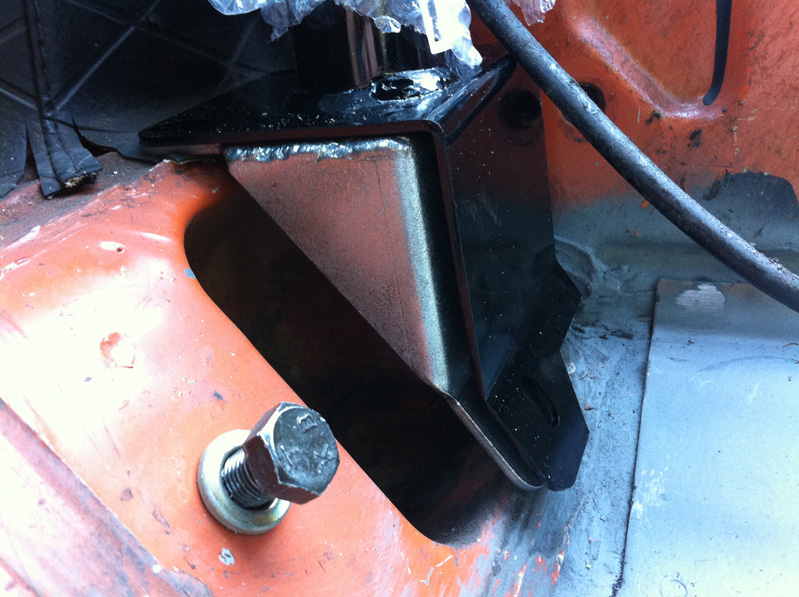

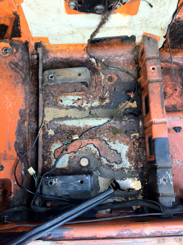

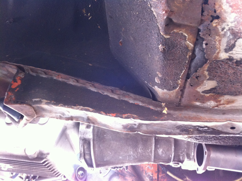

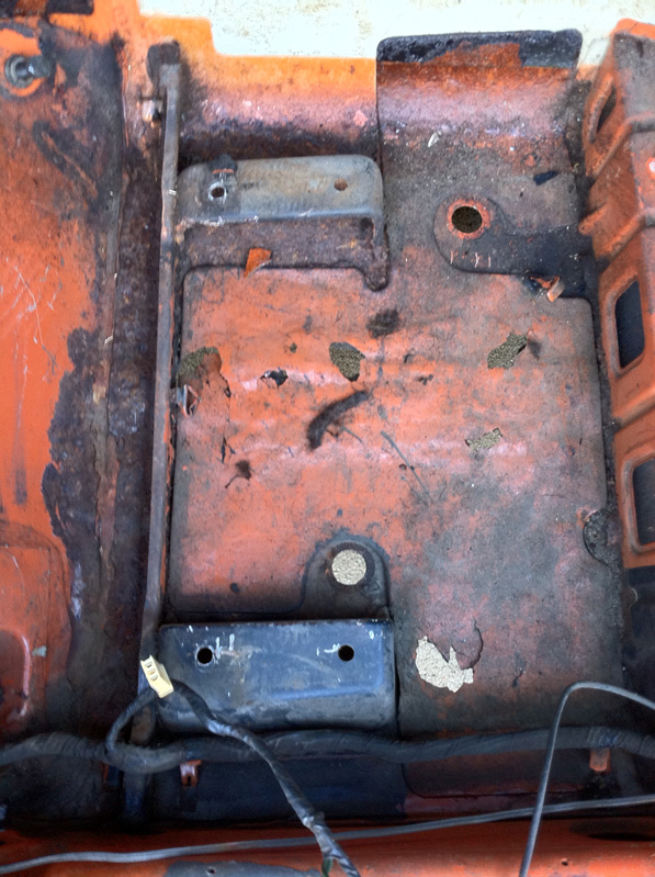

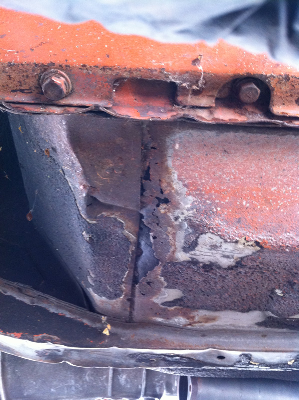

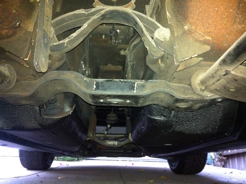

So my Z has ALWAYS been a SoCal car - it was originally sold from Universal City Datsun - I have the original window sticker, the original salesman's business card, and a whole bunch of invoices from the last 39years.... And I've always known that it needed some rust repair from day one... Yes, even SoCal cars can have it bad!
Peel back the old stock tar paper sound deadening and you get this:
Look closely, and you'll see my right shoe! lol...
Most of this under the passenger seat too, but not nearly as bad under the driver seat...
I opted for the repro frame rails from John @ http://www.baddogparts.com, and the repro floors from Charlie @ http://www.datsunzparts.com and picked a body shop in Pasadena to do the work
If you've ever dealt with body shops before, you know that they rarely finish on time or on budget.
I went to see Brett @ http://bobsbodyshoppasadena.com/services.html, and he called me on the dot exactly as promised two weeks after I dropped off the car.
I was stunned! Thank you Brett!

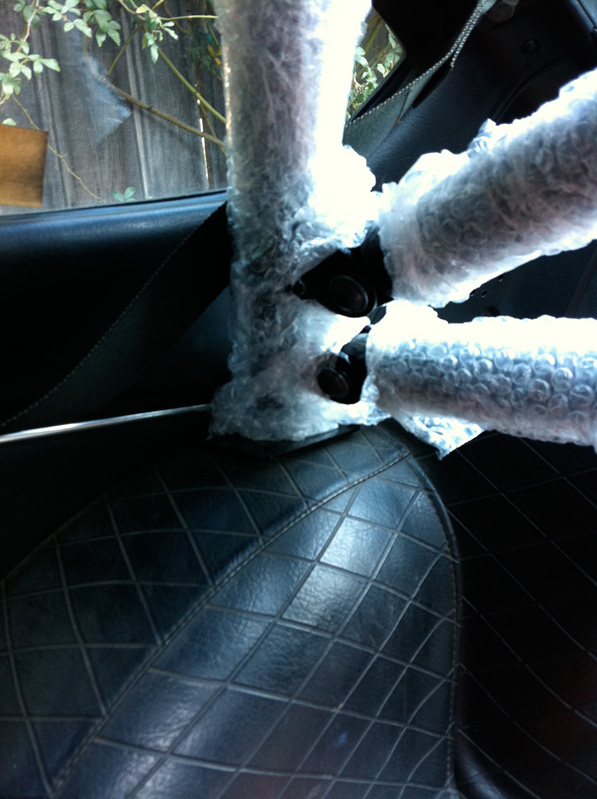

Safety21/Cusco cage needs some sorting out regardless of what the US importer says is "normal"...

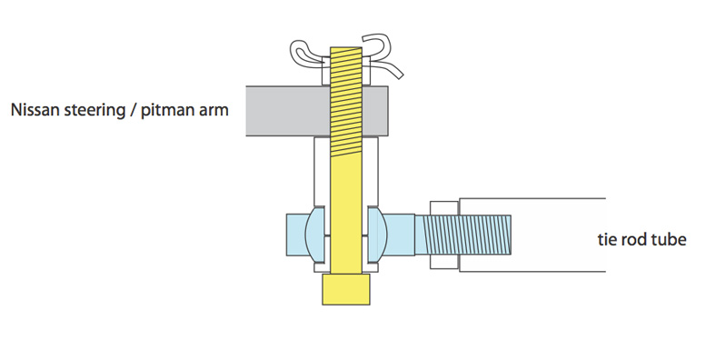

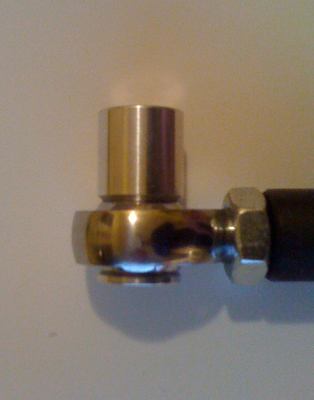

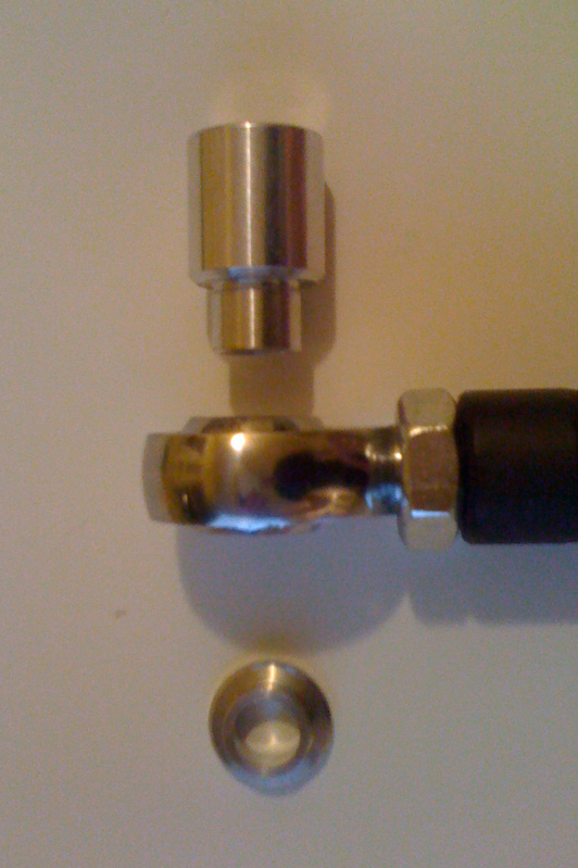

So I've bought a handful of parts from Gabriel at TTT over the past couple of years and have always been very happy. However when I got his rod end outer tie rods for my Z I wanted to make a small mod to them.
He supplies them with some beefy bolts that require you drill out your steering arms.
I have the old Nismo shortened steering arms on my car and didn't want to modify them in any way.
So I drew up a spacer that would make the TTT tie rods and the Nismo steering arms play nice together and had a friend machine them for me.
I've got 15"s and it works like a charm.
It probably wouldn't work with 14"s though.
