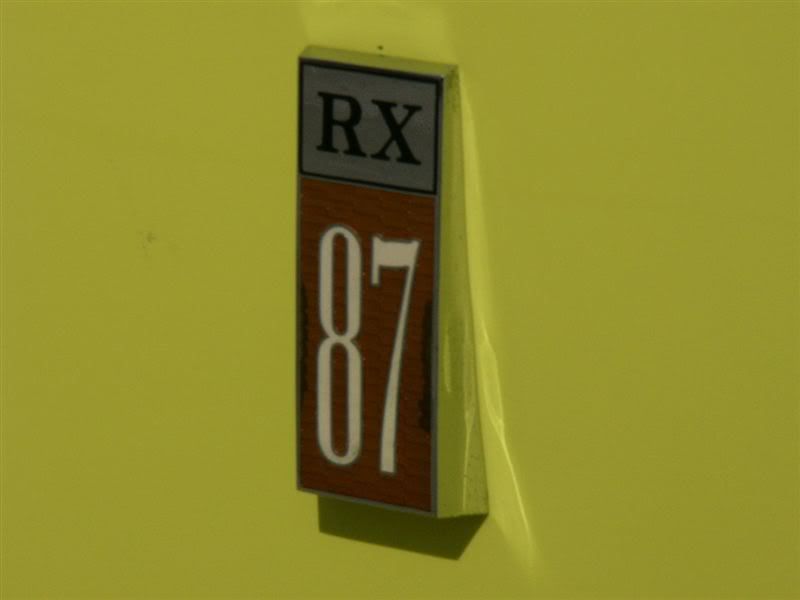

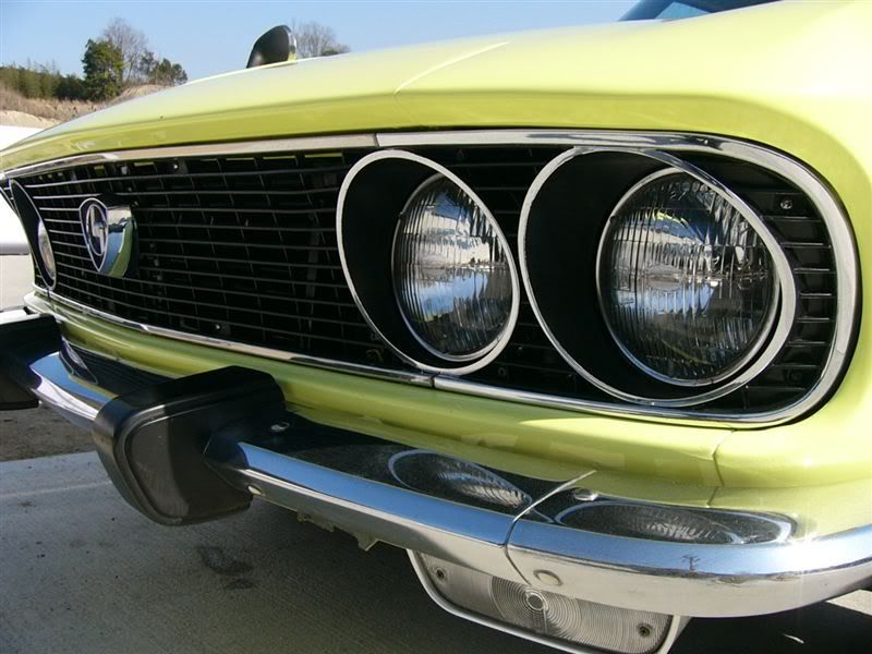

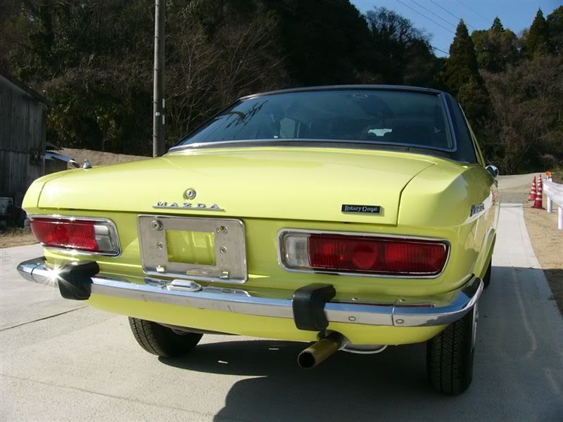

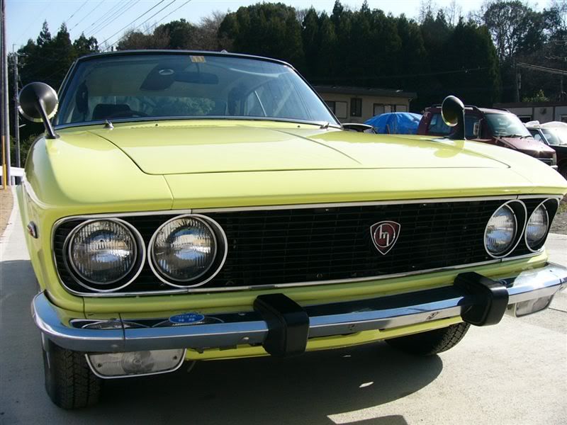

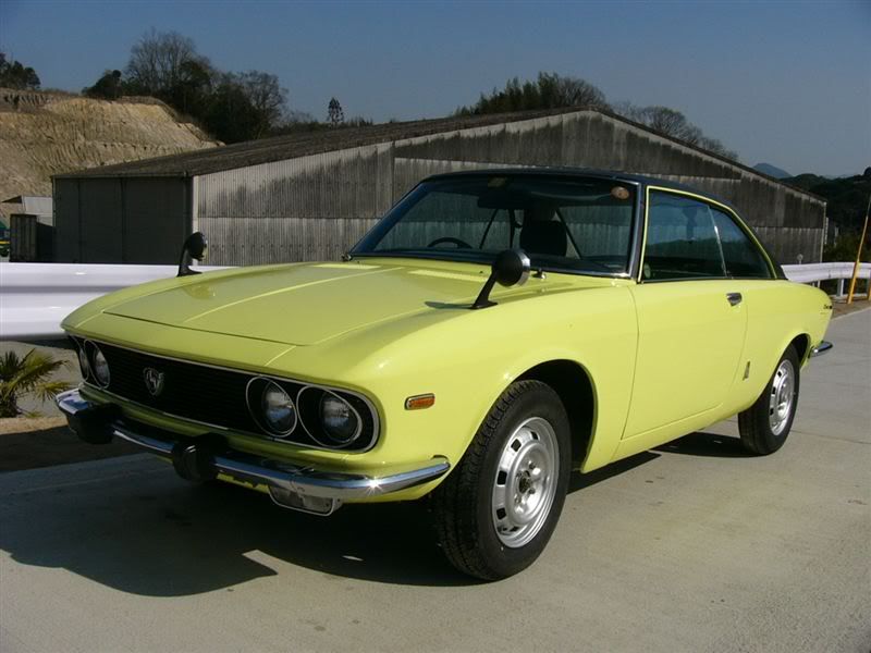

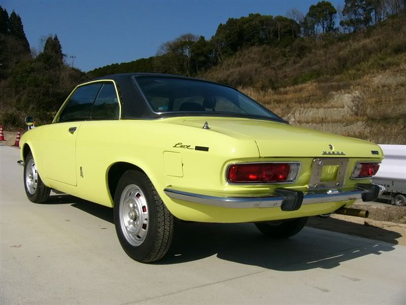

This is a beautiful RX87 that was recently given a freshening up in Japan these picks are post sympathetic restoration will post pics of what was done after...

Uh oh, that sounds ominous...
It's a beautiful car in those pictures...please don't break my heart...

Lol cam, nothing major just some small spots and a general re-spray and the motor was freshened too...

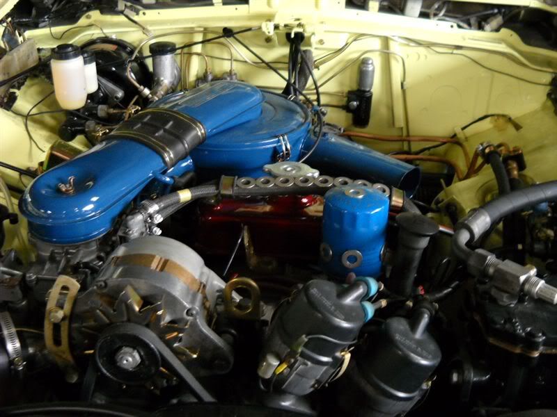

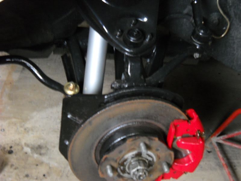

Engine bay and front suspension...Don't ask me what the washers on the fuel hoses and oil filter are for lol

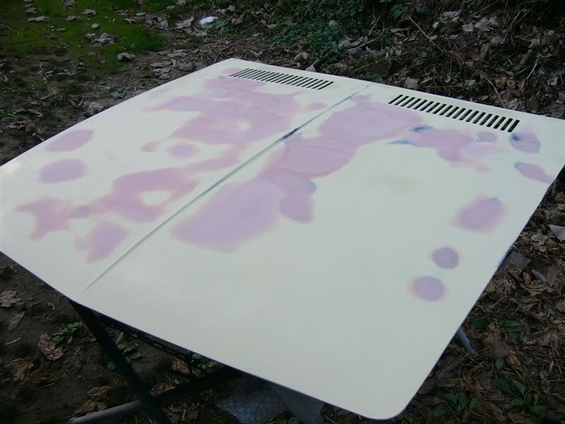

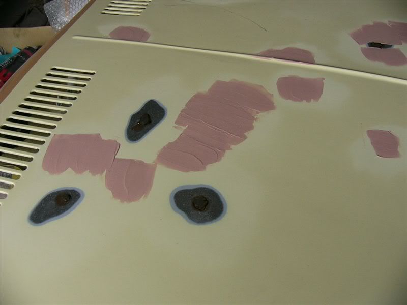

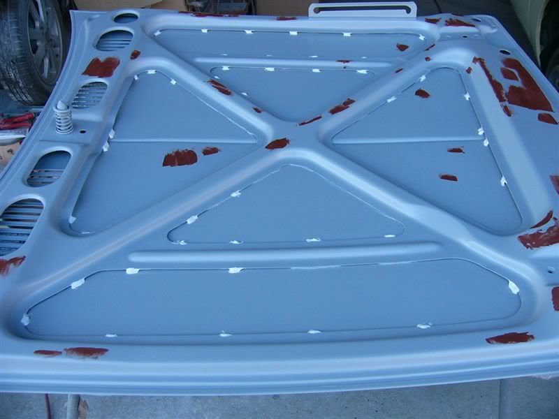

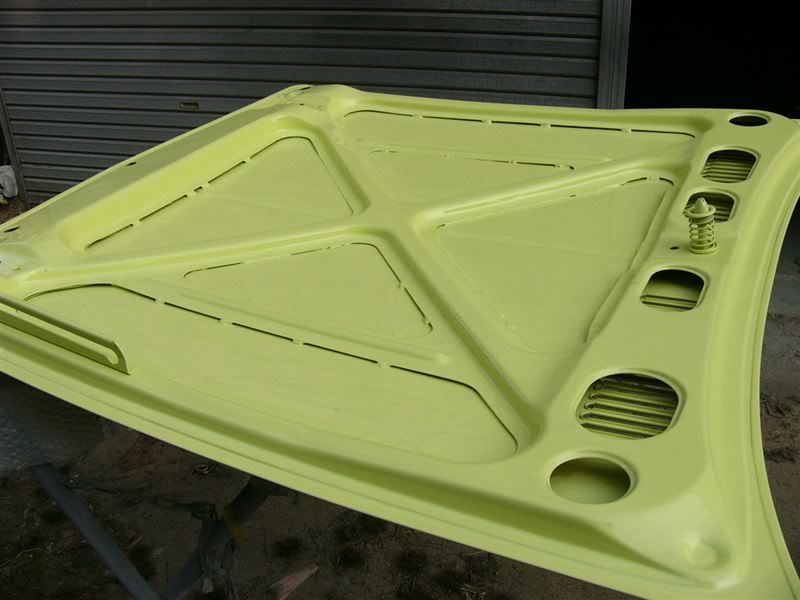

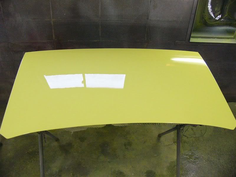

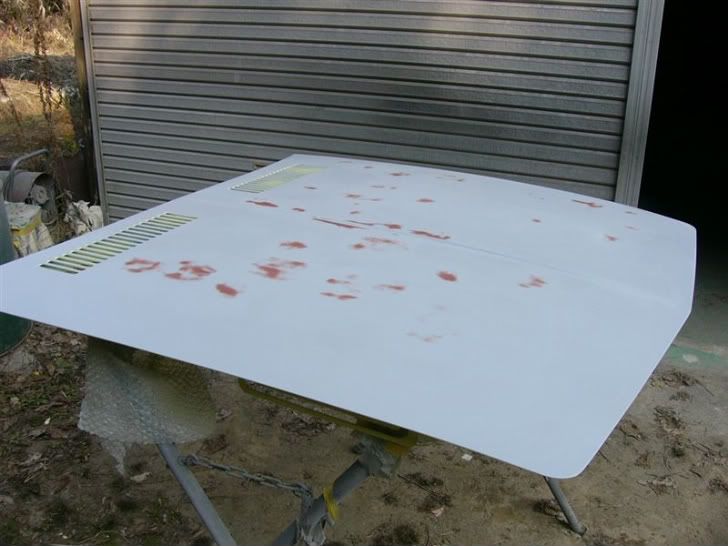

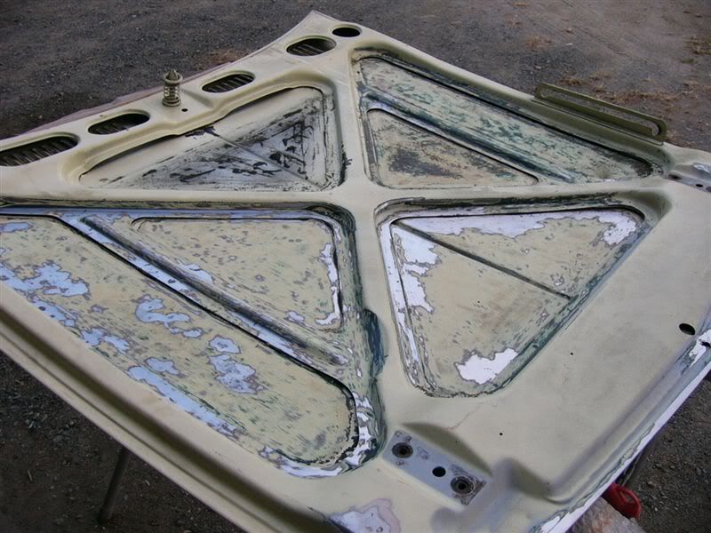

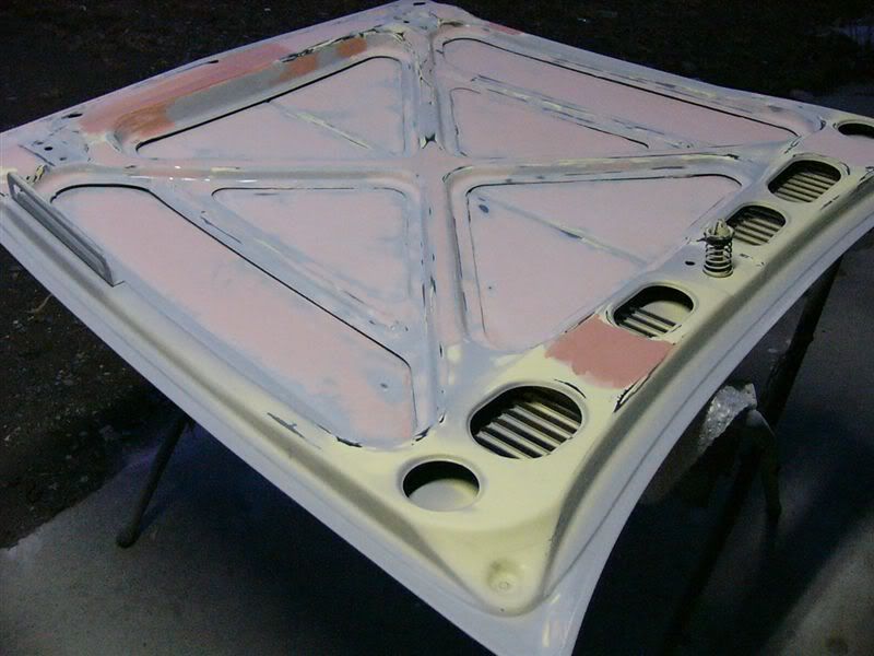

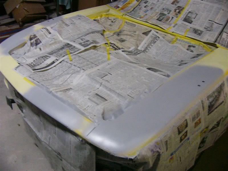

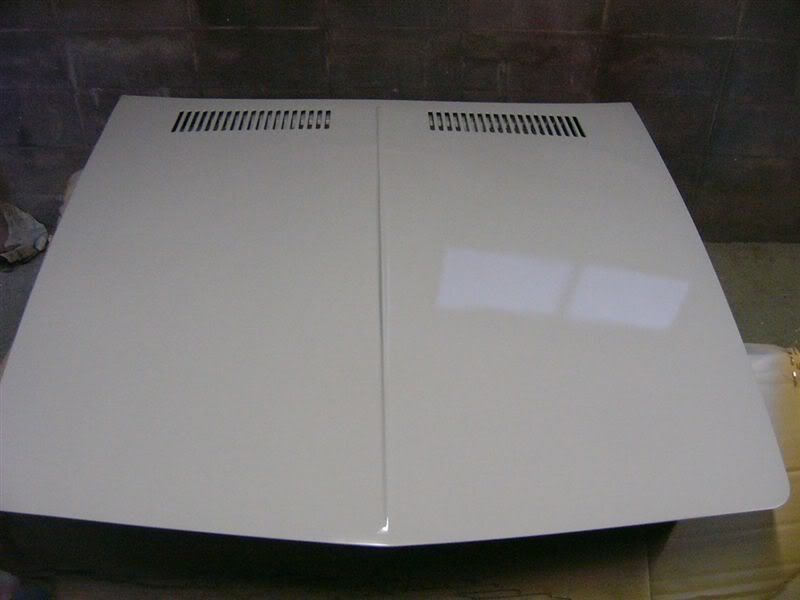

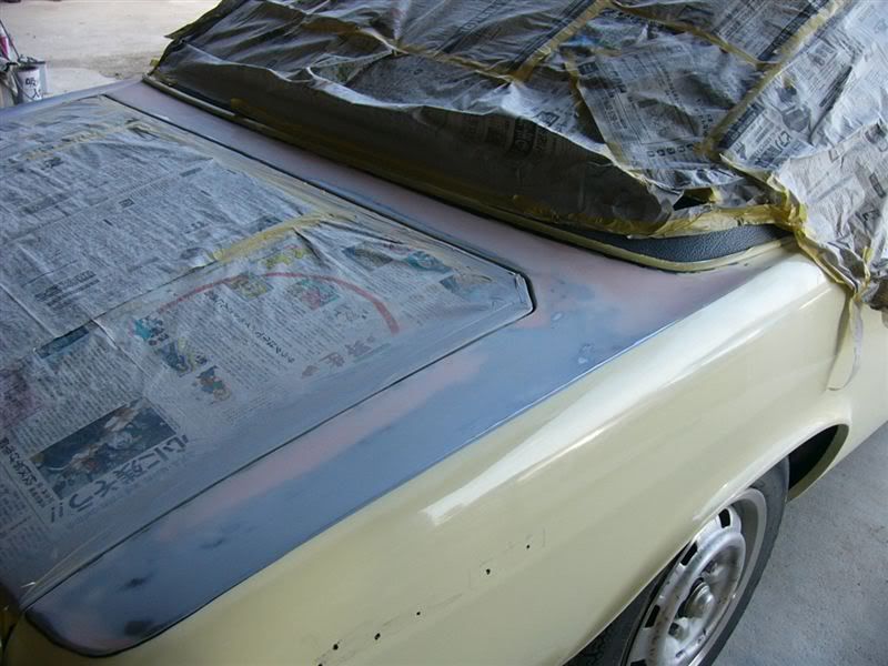

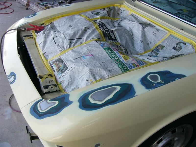

Work done to the bonnet...

I bet you those washers on the hose are to show how the engine runs with now vibration.

I reckon they're magnets! :mrgreen:

My guess probably magnets that attract metal particles out of fuel and oil. Maybe during break in? I don't know how the ones on the rubber fuel lines are staying put?

Could be right about the magnet thing lol makes sense...

C'mon guys, it's obvious they're for NVH!!!!!! :lol:

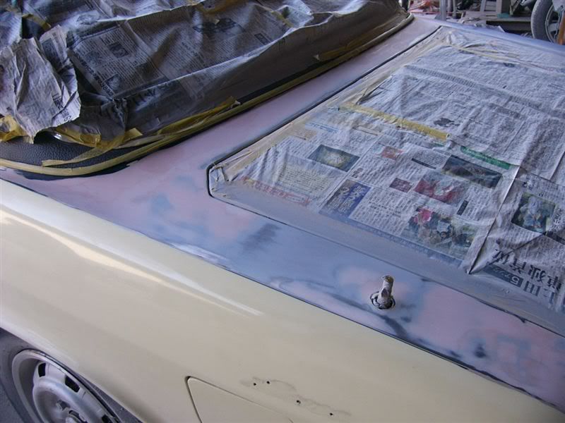

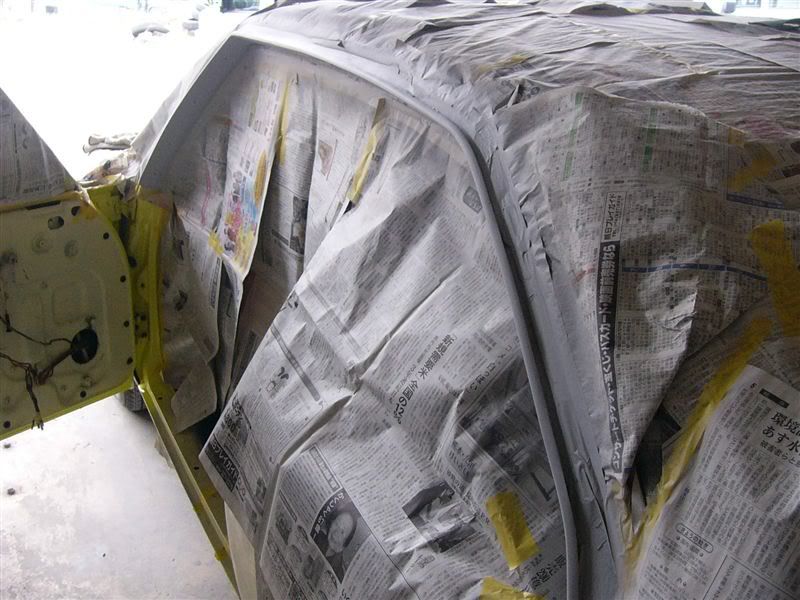

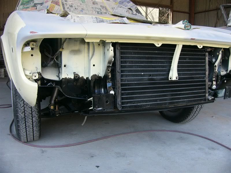

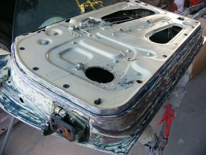

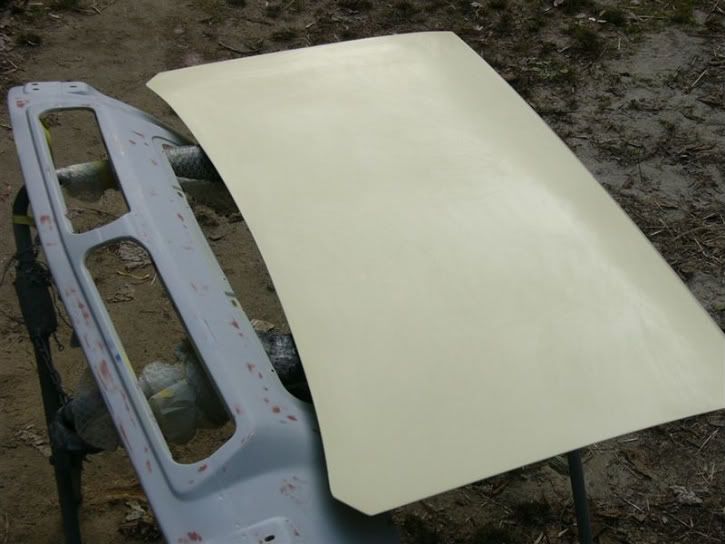

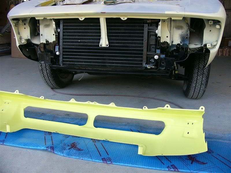

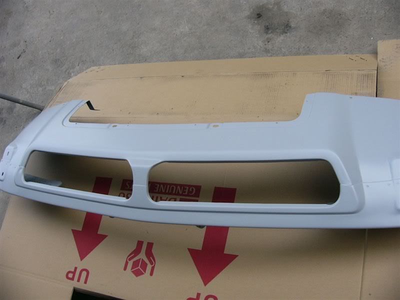

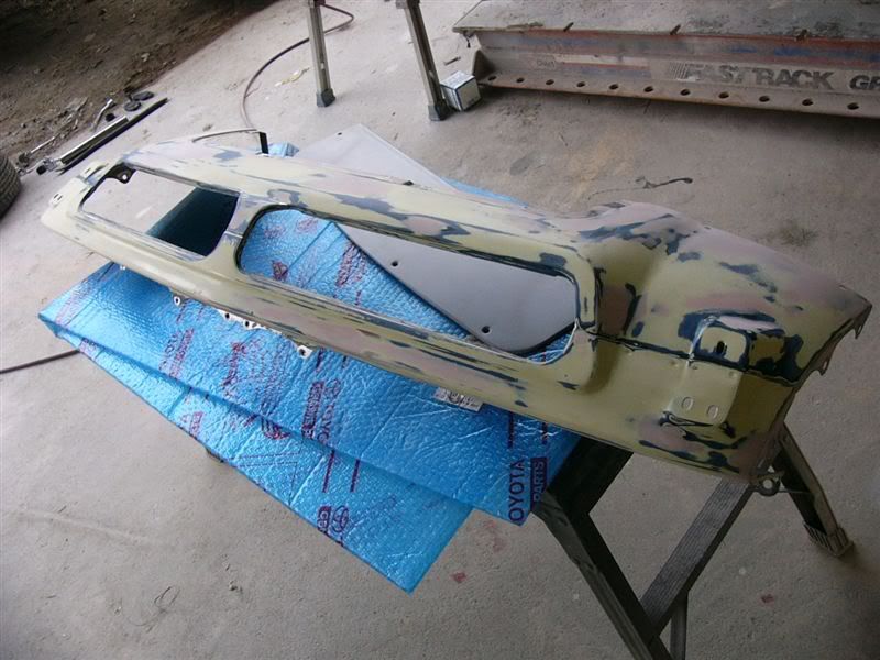

NVH for real lol...Body prep continued on the 87...

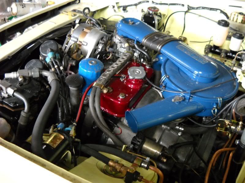

M13P getting more love...

What's the red reservoir on top of the engine for, and what is the pipe going off of it leading to?
I thought it might be a coolant pressurization tank, but it looks like there's one on the fender across the engine bay.

The tank on top is a coolant tank as the radiator is sealed and the other on the fender well is the expansion tank...bless

It's actually an engine oil cooler! ie. an oil to water heat exchanger concept like the series 3 RX-7 had except that it doubles up as a coolant header tank.

Forgot about the oil cooler part Danny thanks :)

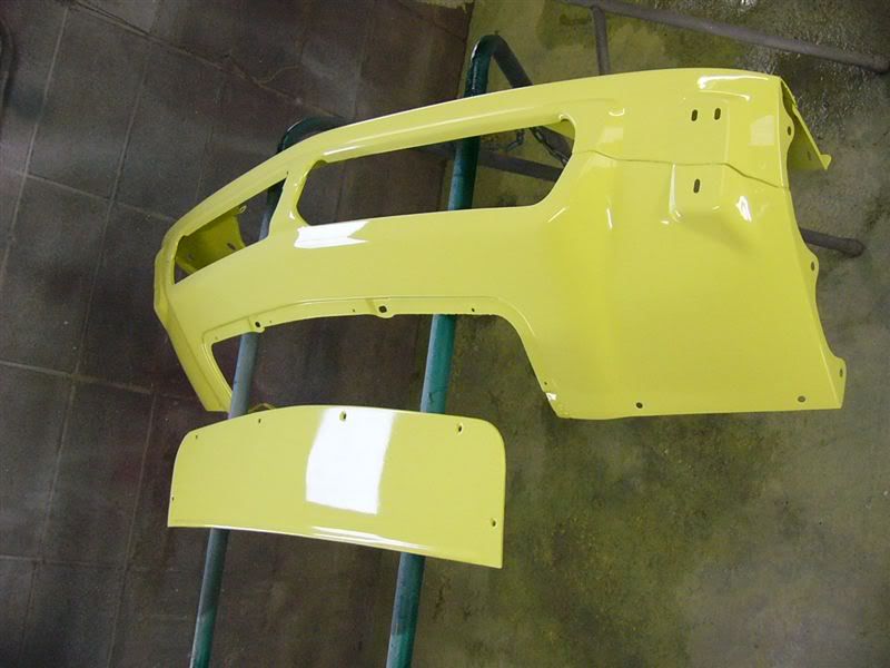

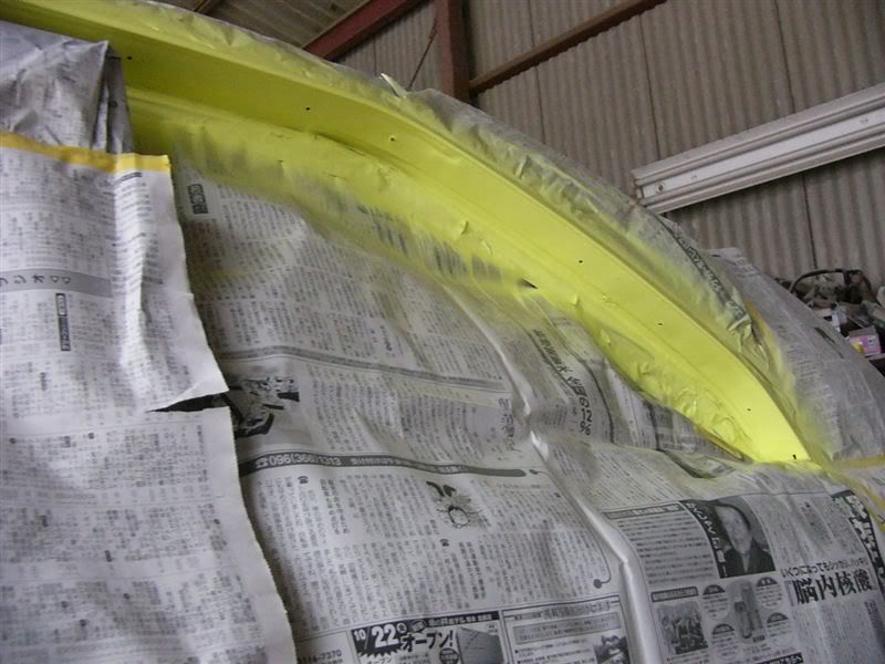

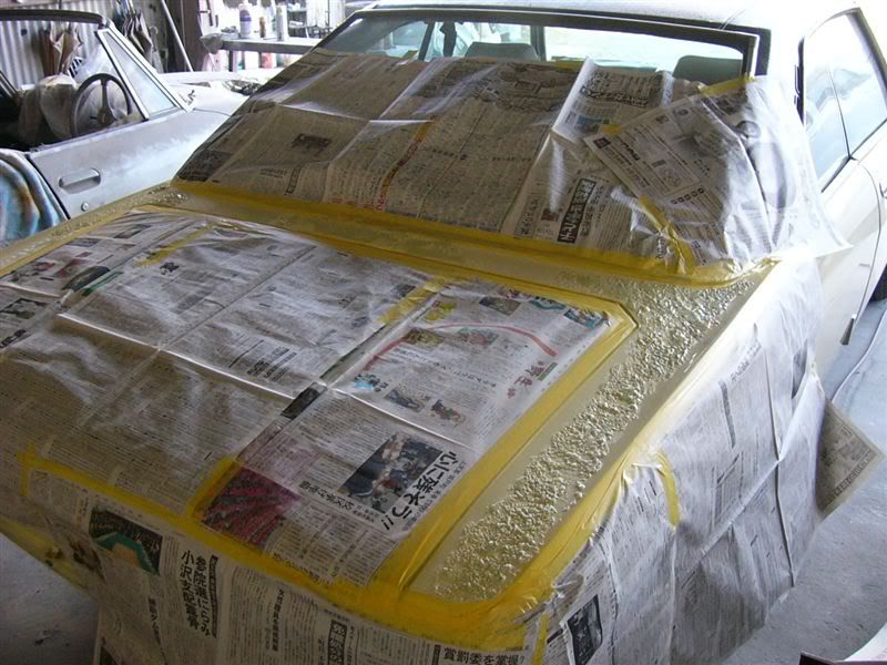

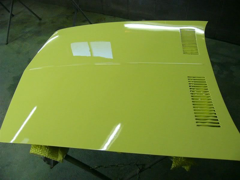

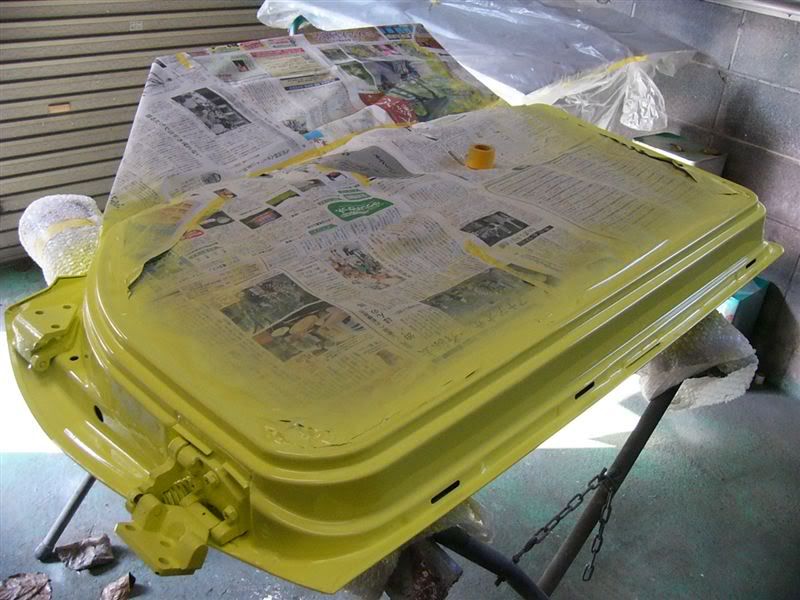

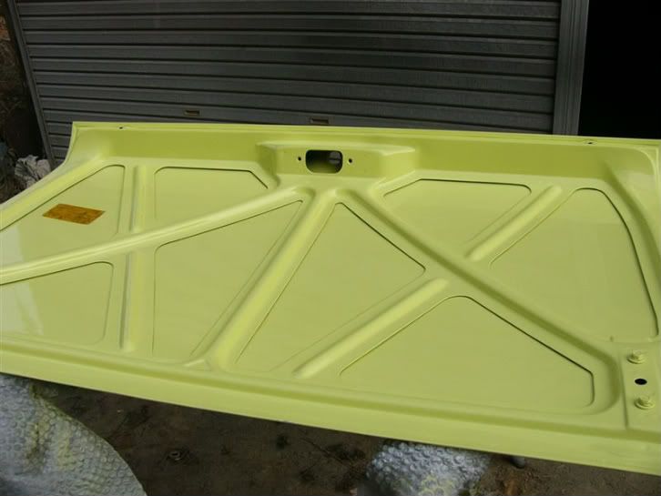

Color being applied...
