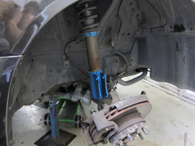

The passenger side caliper seemed to be ok, but I decided to be safe than sorry, and so I dropped both front calipers at Chatswood Brake & Clutch for rebuilding.
So that left me some time to work on the coilovers, which you will remember are shot at the front. I'd taken the dead shock and the spare shocks to a shock rebuilding joint to see if the guts of the spare could be put into the dead one. There was a notion that I might be able to disassemble them, and extract an insert that lives inside, and just swap them over. So the first step is to try to prise off the end caps to the old dead shock.
Turning them with a stillson/plumbers wrench didn't do jack, so I made this handy dandy tool, out of a strap of steel, with two bolts tapped into place to act as lugs on those holes in the end caps.
But the caps were screwed on so tight that the lugs sheared right off. Hmm...could be that they are corroded on. The coilover bodies are steel, whereas the end caps are aluminium. So over the years I think there has been differential corrosion and that powdery corrosion has built up in the threads of the end caps. So they are not coming off for nobody.
The idea switched to maybe using the longest of the spare shocks, which is a whole 4ins too short, but if I screw the shocks into the blue bit halfway, then it's only a 20mm ride height drop. Hmm...nah. Seems dodgy.

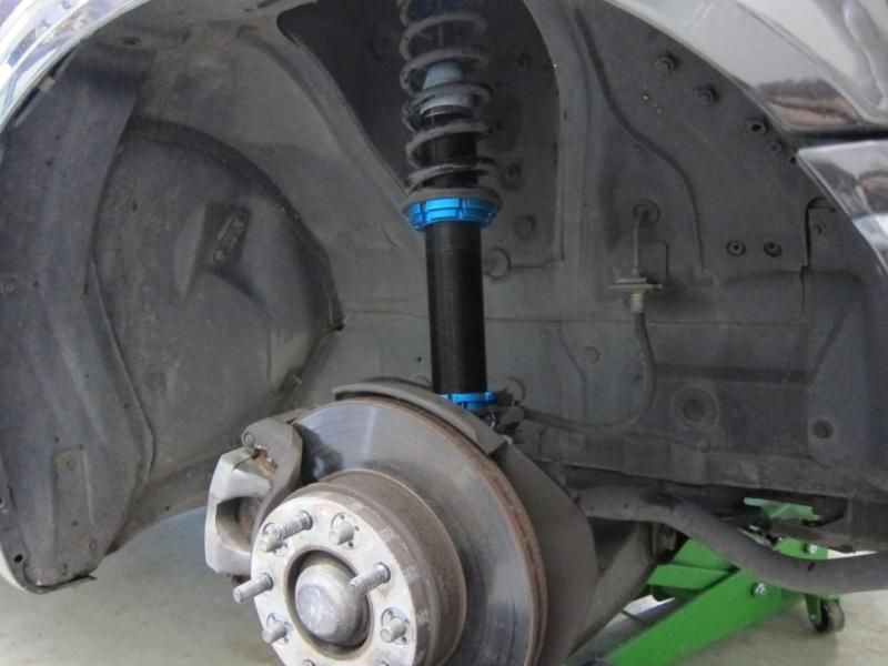

Finally...I found a replacement shock locally at K-Sport. K-Sport are made in the same Taiwanese factory as G4 was, so they are interchangeable, but are a black colour instead of chrome tho.
And they managed to supply me with the same 50mm "Type D" shock as the dead shock, so it's a perfect fit in the old G4 hardware.
So on it goes, with the new caliper and pads. You'll notice I also fixed the broken ABS sensor wire in the background.
With everything buttoned up, I ran a whole 500ml of fluid through the whole system. Yeech...better out than in I guess.

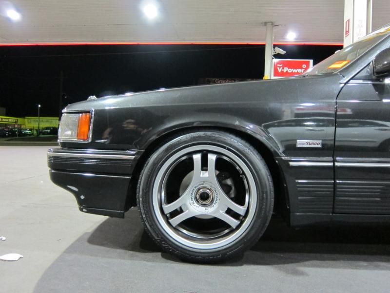

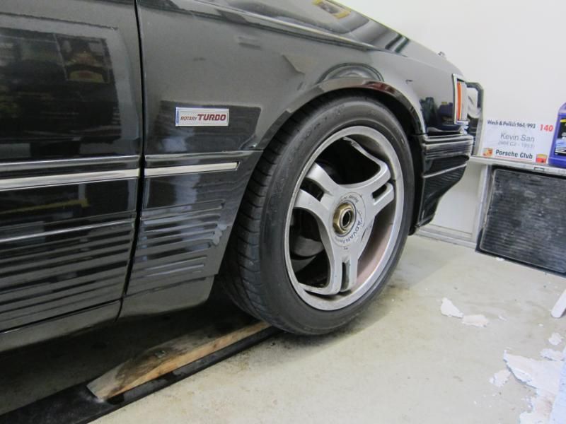

The new Michelin Pilot Sports, they're 205s on a 7in rim, so there is a tiny bit of stretch
Hmm...maybe the front needs to go down about 10mm?
But the great news is that Luce drives magnificently. The front end hasn't been so tight and planted in years, and no more front end clunks over bumps. And rather embarassingly, the ABS is working for the first time since 2007 :lol: (bloody hell it was as simple as a broken wire)

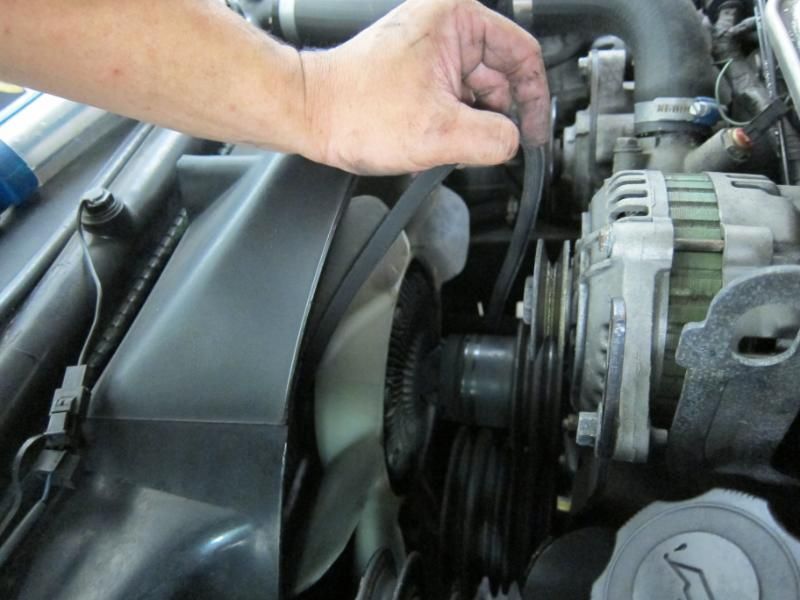

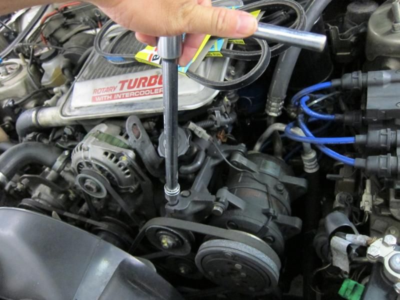

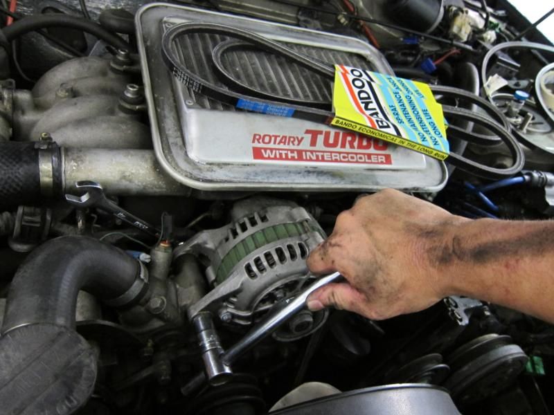

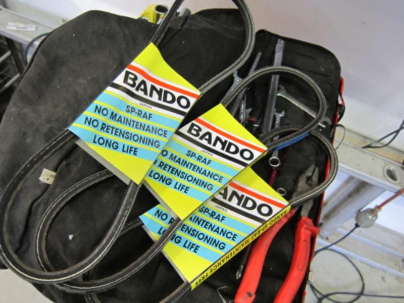

But a few days later the belts didn't seem quite so tight anymore, which means I think that they're on their last legs and are getting stretchy. So...new belts...JDM yo, Bando brand.

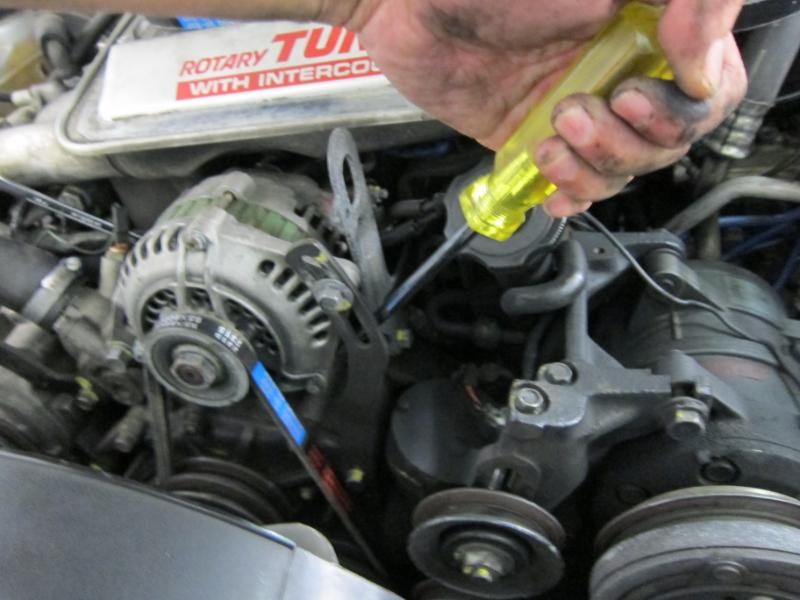

As you can see, the 13B has quite a few...one for power steer, a/c, alternator (which also drives the water pump and fan) and the air pump. Now the air pump is a weird rotary thing...it takes fresh air from the airbox and pumps it into the exhaust manifold. The official reason is to pump in fresh oxygen to help the exhaust charge get a more complete burn once it leaves the rotor housing, but in reality what it really does is inject fresh air to dilute the pollution in the exhaust, so the pollution readings aren't quite so catastrophic :D Some nice design there by Mazda: the water pump and fan are driven by two belts, the air pump and the alt belt. So if one snaps, you still get to limp home with a working water pump and radiator fan.
First, before I work on belts, I always unhook the battery. It's very easy for a spanner or something to slip off a fender and fall on top of the starter, and when that happens the motor will crank. Even if it only does 1/4 of a revolution, that's enough to trap your fingers in the belts.

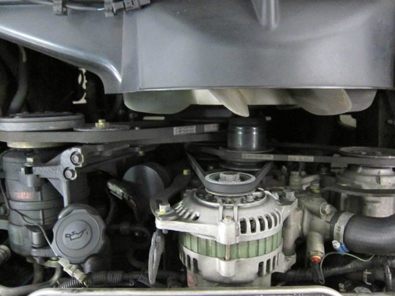

Now, there are two ways that belts are tensioned, and the 13B has them both. The nice way is a tensioner that is tightened/loosened by turning a bolt. Once the tensioner is lowered, the belt goes slack and can be removed.
Two of the belts look like they can only come off if the fan is removed, but in reality you can wiggle the belt past the fan blades.

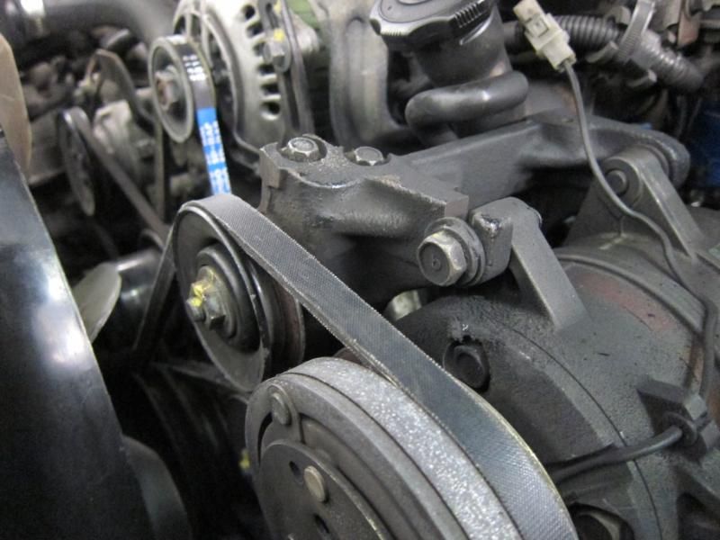

This is the other kind of belt tensioning...the alternator is on a sliding bracket, so I use a long screwdriver to lever it upwards (and make the belt tight) while I tighten the fixing bolt.
With this kind you also have to loosen/tighten the main mounting bolt on the other side.
Et voila...new belts! For the record, they are all the same as FC, except the power steering belt is shorter. I guess there must be less clearance in a Luce, so the power steering pump and a/c compressor locations are swapped compared to an FC.
Next job is to replace the other front shock. The other day, I replaced the really dead shock on the passenger side, but the driver's side still looked good, with no leak. But if you went over a speedbump, you could tell that there was a little bit of a difference from side to side...I dunno if this is due to the driver's side being worn, or because of differences in valving between the G4 and the K-Sport. But anyway, I'll change it so that the front end is a matched pair.
Struts are easy to change :)
Roughly 45mins to get to this stage.
