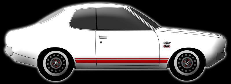

Rendering of finished product, made by a member of sigma-galant.com
