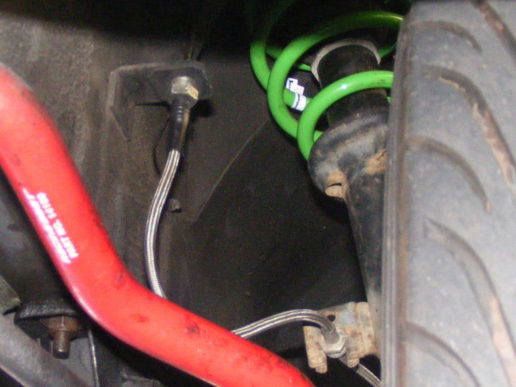

First job was to upgrade the suspension with Racing Beat sway bar, urethane bushings, better springs, steering components, and a strut tower bar. The previous owner installed new shocks so I did not worry about those.

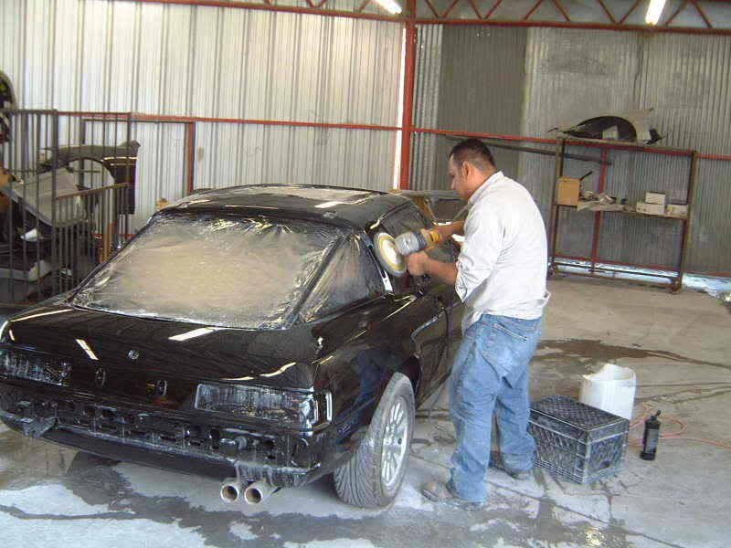

Next project was having it painted...

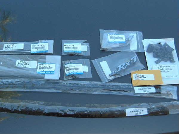

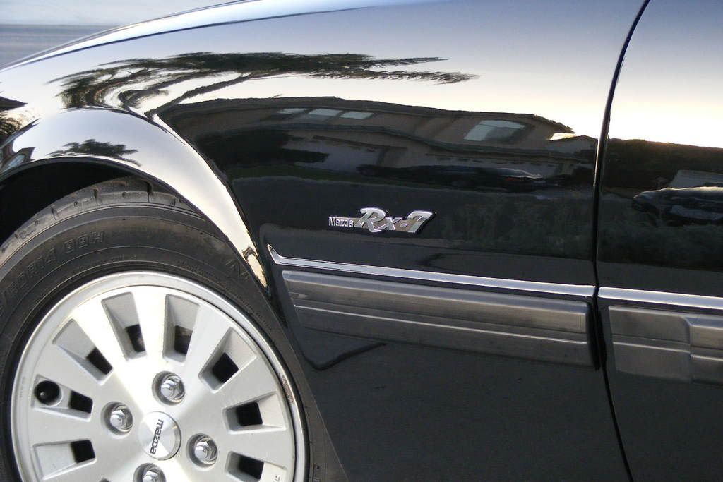

Cannot paint it without replacing all the badges, etc...

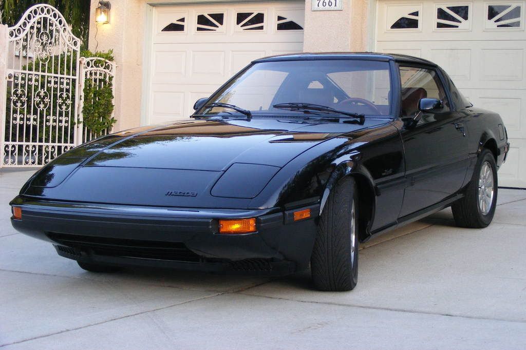

Exterior done:

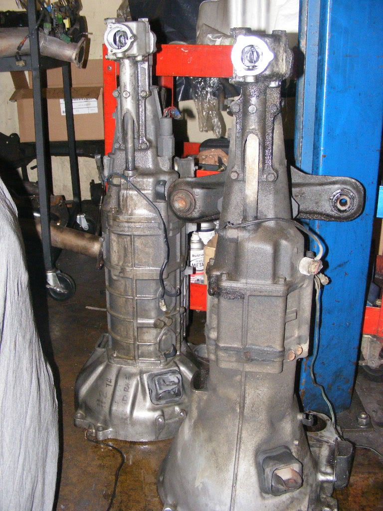

Old transmission on right - new S4 T2 transmission on left:

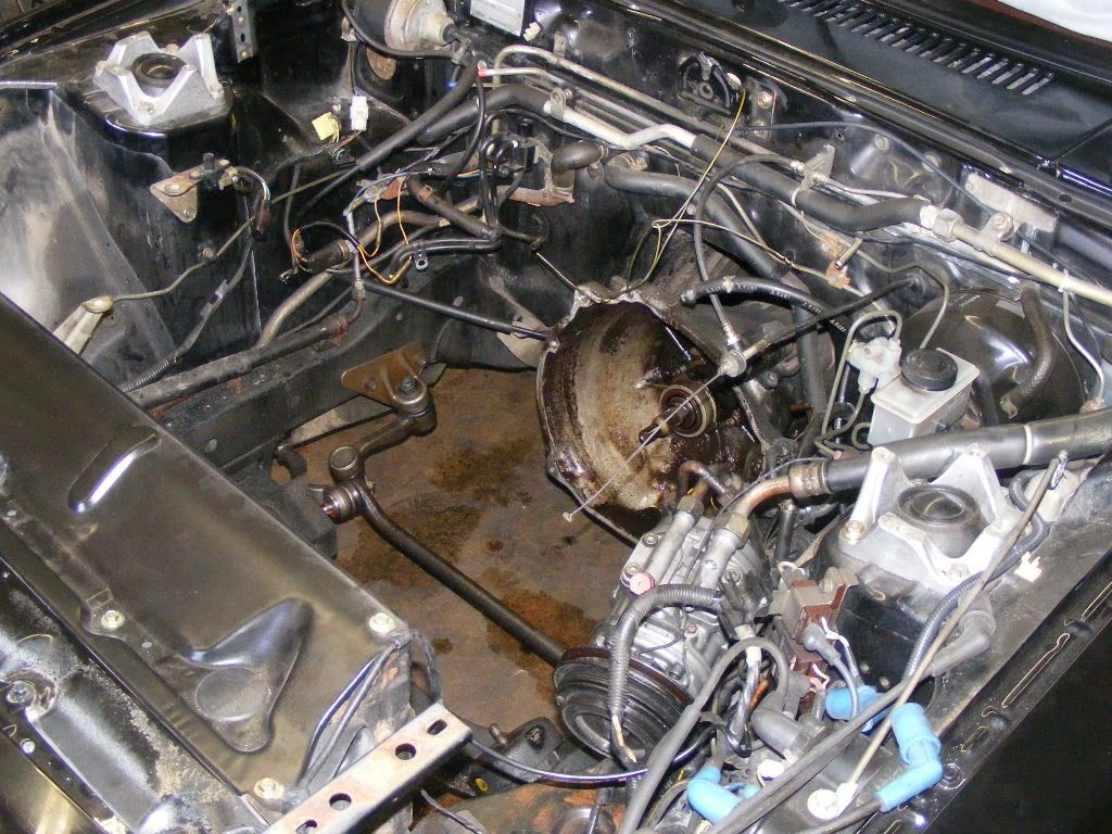

Nice mess in engine bay with old motor pulled.

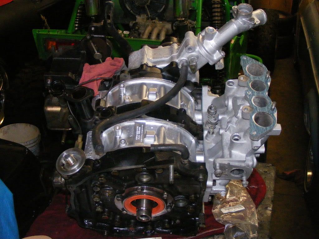

New engine:

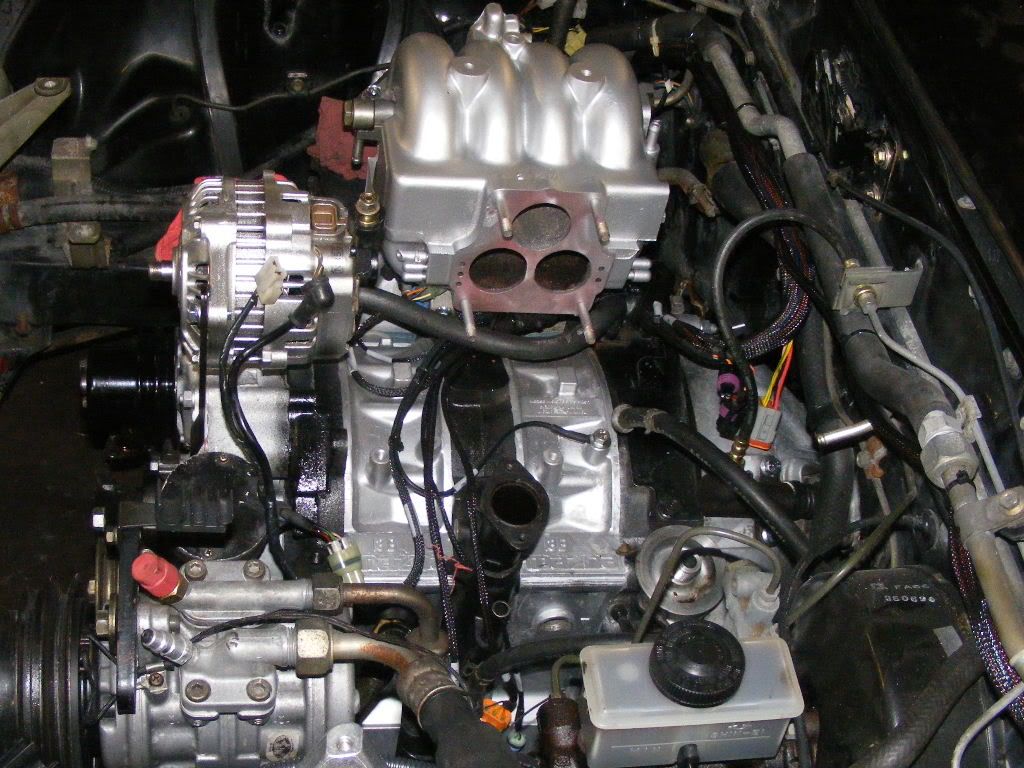

Engine and transmission installed:

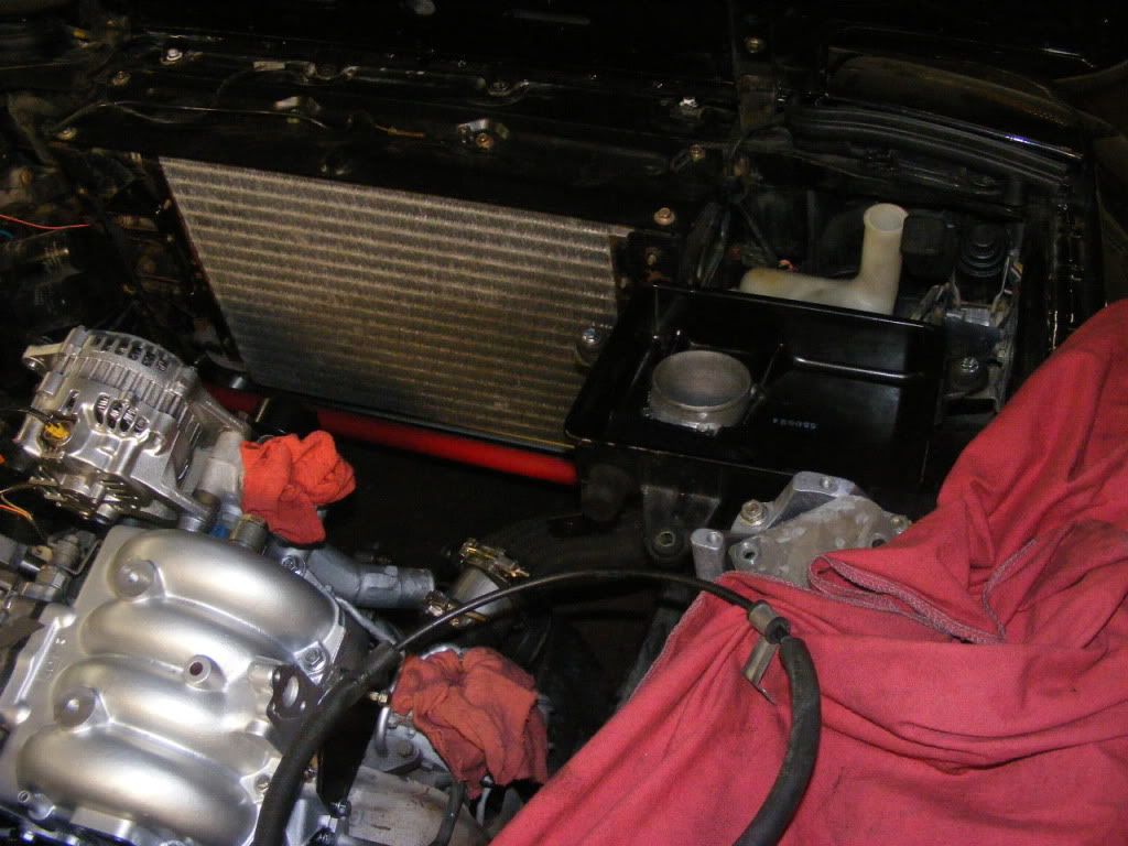

Modified the stock air box to feed the turbine:

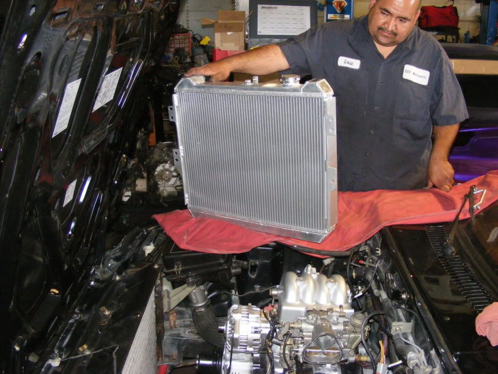

Will need a better radiator, this one from Champion Cooling Systems was a great deal. $220 US with a 16" electric fan:

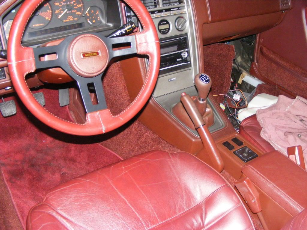

With transmission installed, old shift knob looks like the stock:

How will you be feeding fresh air into the intercooler? Will you be grafting on a Turbo II scoop?

We are going to try and get by with water injection to cool the charge. In the picture of the engine bay, the water reservoir for the windshield washers is visible. Except that I have no window washer nozzles, in reality the reservoir is being used for the water injection system. There is a controller that varies the amount of water injected depending on the amount of boost.

@Cam: Well, the engine is installed and I am breaking it in for 900 to 1000 miles. The water injection just is not enough to cool the turbo air, so we are going to have to graft a 2nd gen hood scoop on my hood to provide fresh air flow.
