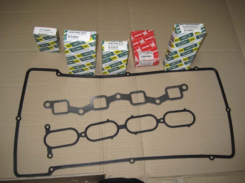

More of my parts have arrived, and progress is possible again.
I was waiting for the bearings to send the crank off to the machine shop.
While ordering and waiting for the bearings, I got a little education. More on that later.
Gaskets and bearings.
Random gaskets + tensioner O-ring:
Some of the chains/guides/slippers:

Regarding the bearings,
The block has been at the machine shop for a while now.
As such, I was feeling a little pressure to get bearings here soon.
So, I ordered a second set. Smart me (sarcasm) does his research after ordering.
I'm not a noob, I just don't have experience selecting bearings for a motor like this. My experience has been limited to selecting the correct size.
Bearing material has never been a consideration.
I either used OE Toyota bearings, or the motor has been for a low power application like a Tercel.
What does this all mean?
Well, my second set of bearings I ordered were Bimetal.
I sent an email to the bearing manufacturer to ask about their suitability for use in a turbocharged application. The following is an excerpt from the reply:
It is important that you use a trimetal connecting rod bearing in this
application, and you should be able to obtain such from one of our competitors.
Well, I guess this goes under the "glad I asked" category.
I asked another manufacturer (Mahle/Clevite) about using their CB1270P and MS1456P in a turbocharged application. This question elicited this response:
They are of sintered trimetal construction. Not quite as good as the 77 material, but still a pretty good bearing. If you're going to crank up the boost, I'd suggest having them coated for extra durability.
Now as I'm not cranking up the boost to a crazy level, then these would probably do the trick.
As it is, I believe that the bearings I have pictured are made from an appropriate material.
Hopefully this helps someone in the future.
