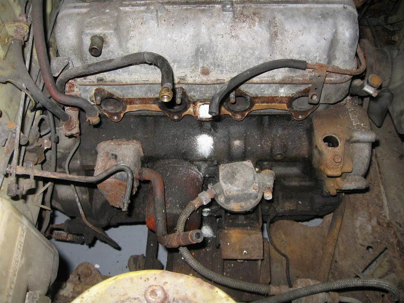

Engine is ready, rebuilt the rotted 2T with a donor 2T-B engine so increased the power some, but not enough for me, some further mods should achieve 130HP or so. Increased CR and valve-lift, enlighted valve-train, improved the mechanism, added 2 mikuni-solexes and manifold from a 2T-G engine.
Here a before-after of the engine:

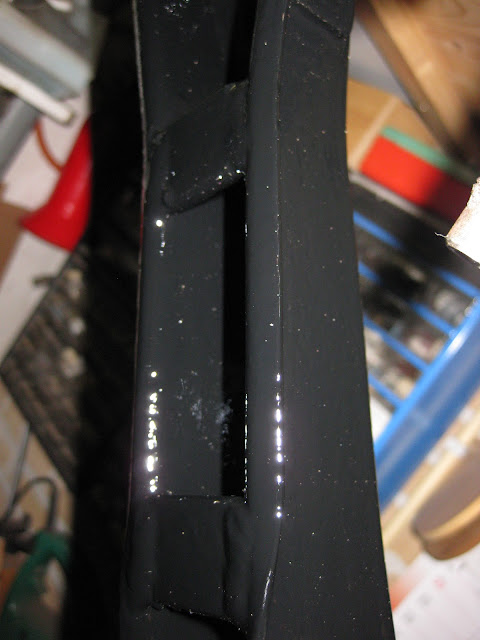

Lamp brackets:
Sand blasted them, painted in Zinc primer, painted with a bristle in high-gloss black, polished the Stainless rims.

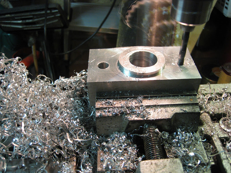

I am rebuilding it with lowest budget as is possible, so do allmost everything myself. Mikuni's with manifold where only 80$ or so, and had to fit it to the 2T head.
Have a 6mm aluminium sheet for amplifier front projects left over, and jig-sawed an adapterplate for the manifold to head. A mikuni to 2T-C manifold can be purchased on the web, this would rise the costs, the adapter works very fine.

Yes educated as fine metal machinist indeed, but stopped after only 2 years, have two jobs now, in medic and in a para medic/commercial sector.

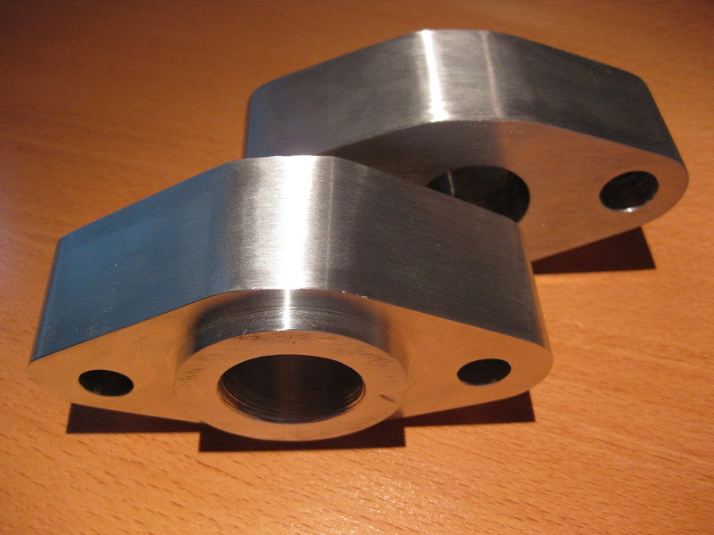

Have a small lathe in garage and drilling machine, with X-Y support for small milling products. Milled on that machine 2 roll center adjusters.
For the carb adapter a saw for wood is used, but with metal saw. After that the holes are drilled and chamfered for bolts, allen key boltheads are lathed to fit. Big holes are drilled with a big wood drill. The outline of adapter is machined with a cabled dental tool i have, sort of Dremel hand drill but with a lot more power and two quick change chucks.
The source for raw materials is the metal scrap yard, they know me there by now, for a few bucks a 70cm block alu, round material for the head clamps can be had.

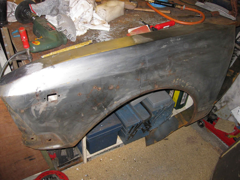

Thanks. Now busy with lead-loading of different panels, eg front fenders, doors, front valance, rear bonnet. Not easy but with practise it evolves somewhat.
After leadloading only a thin layer of putty has to be used to get a nice flat surface for final color/clearcoat, 1st layer of paint will be epoxy 2 pack, after a phosphorous treatment of the steel surface.

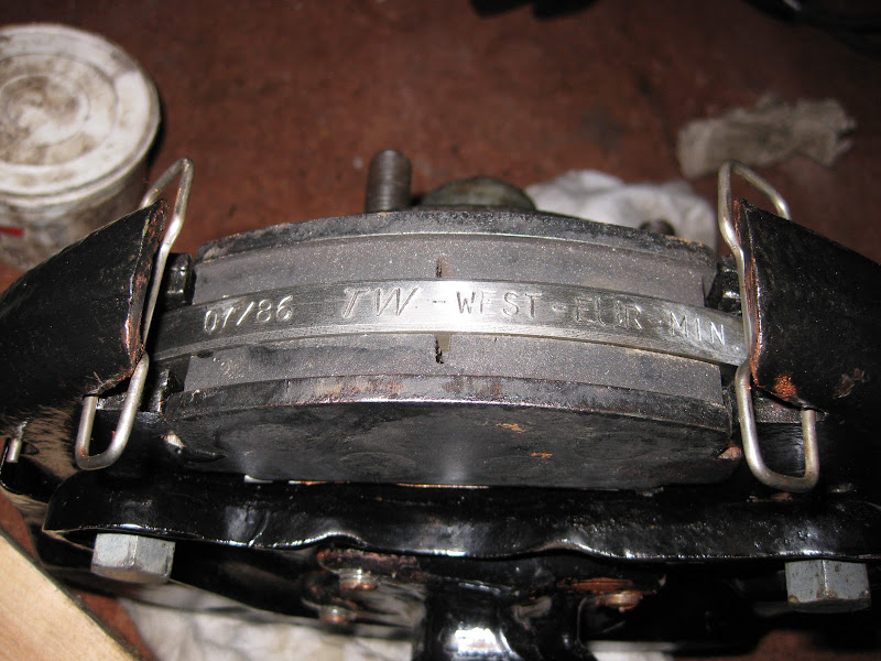

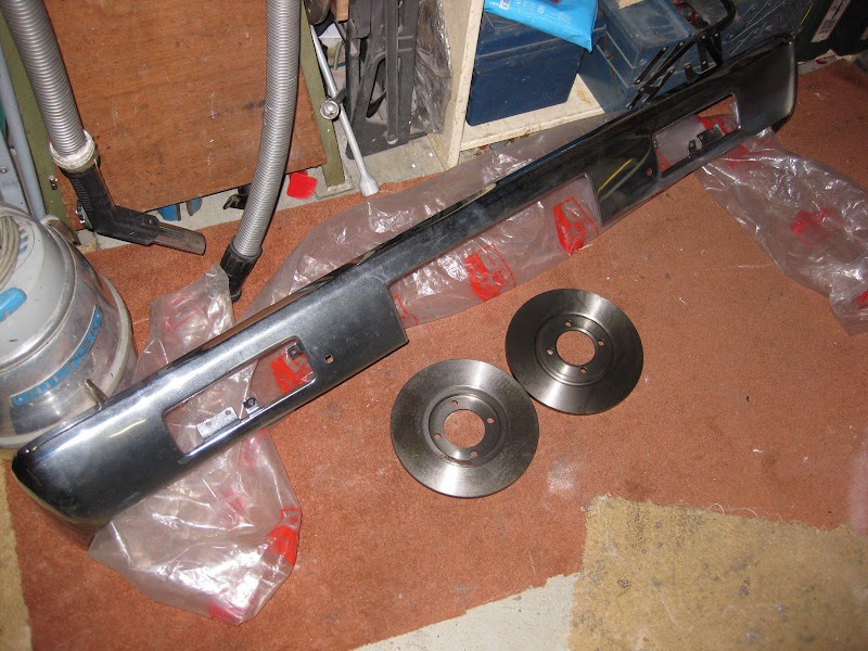

New brakes, rear bumper

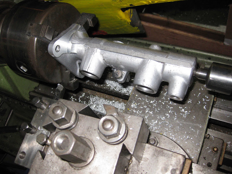

Carina E Masterbrakecil with 2 way made fit on the booster with a clamp, after lathing the mount surface
