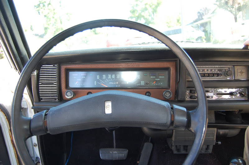

All original from what i know. The odometer is frozen up at 9600, which seems common on these old Toyota's. Its got a 3RC with a Toyoglide 2 speed on the floor. The transmission doesn't leak at all, but doesn't seem to like being in low gear very much. Not sure if there are adjustments on this? The engine does not run very well which i am 95% sure is because the distributor is not advancing properly. As well as not running right its leaking oil pretty good too. Should be a fun little project.
This thing has been really fun just cruising around town and what not, getting a lot of attention and questions. I hope that i can daily drive this little beast and eventually upgrade the engine/tranny to something with around 150-200hp.
Let me know what you guys think.

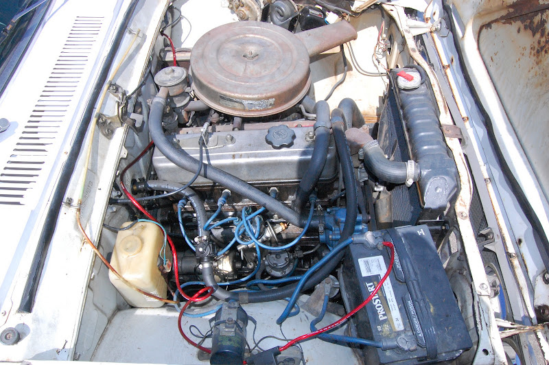

The timing does not work properly which i determined to be the vacuum advance. I took the vacuum line off from the carb to the distributor and found a nail that was shoved up inside the tubing to block the airflow. It was all hooked up and looked as if the vacuum advance would be working just fine.
Now answer me this. Why would anyone ever block the vacuum line to their
vacuum advance on their distributor?

What is the tiny diameter hose coming off the emissions canister? mine is hooked up to nothing and i think is what is probably the source of the vacuum leak

i had that same problem! it would pop off when ever i would start the car causing it to die at low rpm's i just used small hose clamps to keep it in place.
you had the same problem as the tiny tube coming off the smog pump/canister thing above the intake/exhaust?
im trying to find where this hose even goes... its currently dangling getting torched by the exhaust manifold, but can't seem to find where it plugs into.

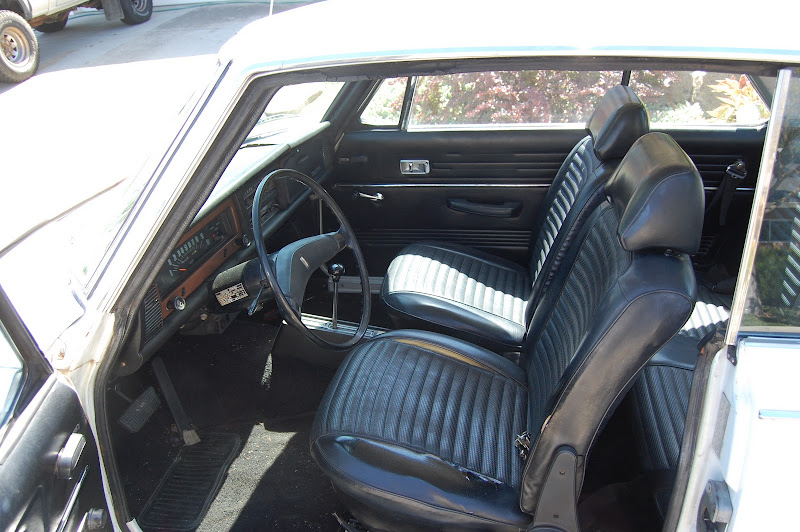

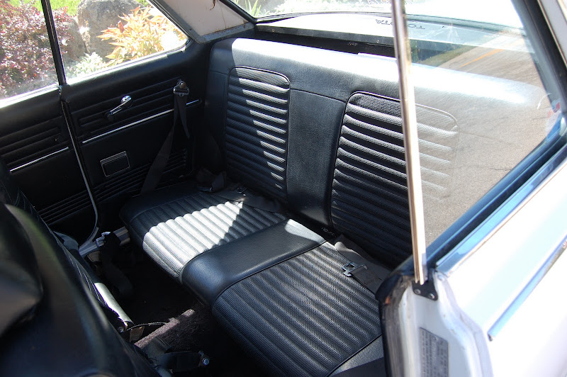

Here are some images of various areas of the vehicle. Plans are to keep most of this as original/stock as possible. I know people enjoy pictures so here are some for peoples reference.
