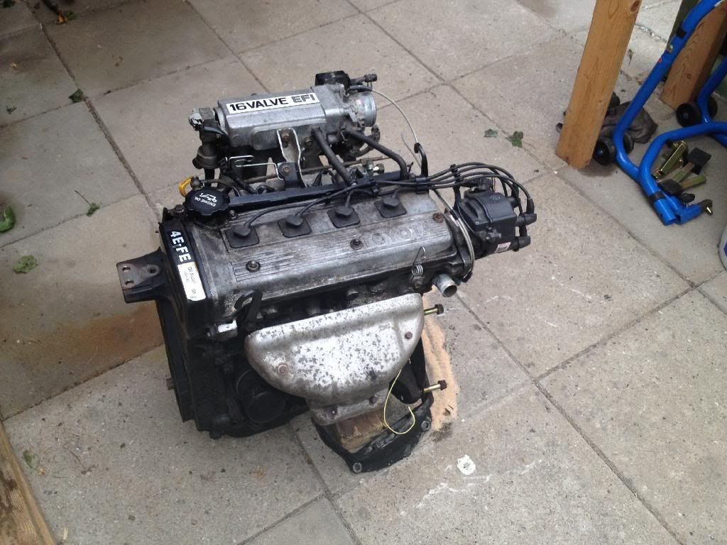

Here's the engine i'm gonna blow up with huge amounts of compressed air :)
The setup will be:
H-profile rods
Forged pistons (Wiseco is on the wishlist)
WEPR exhaust manifold
Td04L or TD05 turbo (from a subaru forester 2,5 XTI)
Lightened flywheel
Custom cams
Ported and flowed head
polished valves
Maybe custom plenum with 70mm throttlebody
AN fittings for fuel and oil breathing with custom hidden catch tank
My big dream is to get rid of the distributor and get some MSD coils for wasted spark, but then I need to customize a trigger wheel and add a cranksensor to get the trigger to the coils, quite a big investment just to remove the ugly black clumsy thing on the right, but we'll see what happens.
Off course painted and polished outside for the last 5+ eye horsepower ;)
And the gearbox is this one. There's a lot of different trannies for this engine, and I don't know which type this is. would like to get the big one, and then fit the rings and LSD from a supercharger box, but I don't know which year they are produced, so if anybody can help me with that, I'm all ears :)
