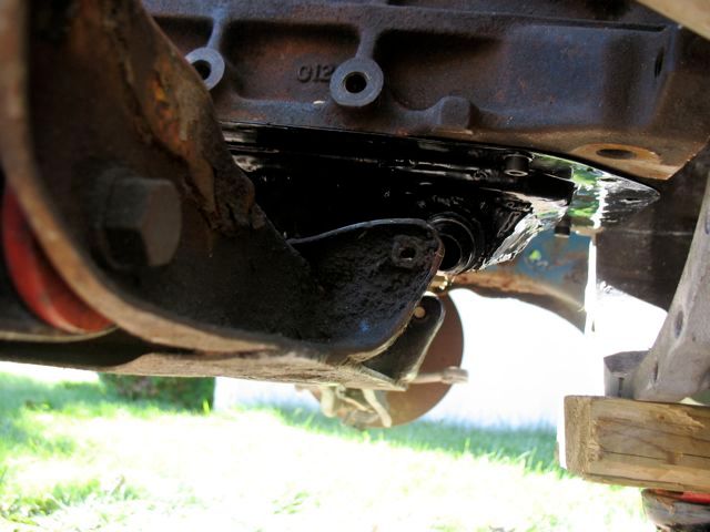

I redid the oil pump bracket. Old one was not cutting it and since I intend to build motor mounts from scratch, might as well use that bracket for both purposes. Made it out of 1/4" plate so I can tap M8 for the 3 bolt holding down the pump and not worry about thread engagement and crap... and it should hold the engine and the oil pump without flexing ;)
So this is what the front should look like ("should" if nothing changes again). I modded the pump pulley (which is also why I needed to change the bracket since the offset was changed by 3/16").
And bonus, welding skills are slowly getting better
Got some big time help from the little man to pull the pan... soooo many M6 bolts in there ;)
To make room for my new home made drysump :
Shallow?
It's now drying outside... decided to dip it in unthinned eurethane paint to add a thick layer of protection and I couldn't paint inside the gutter any other way. Did the trick but takes forever to dry.

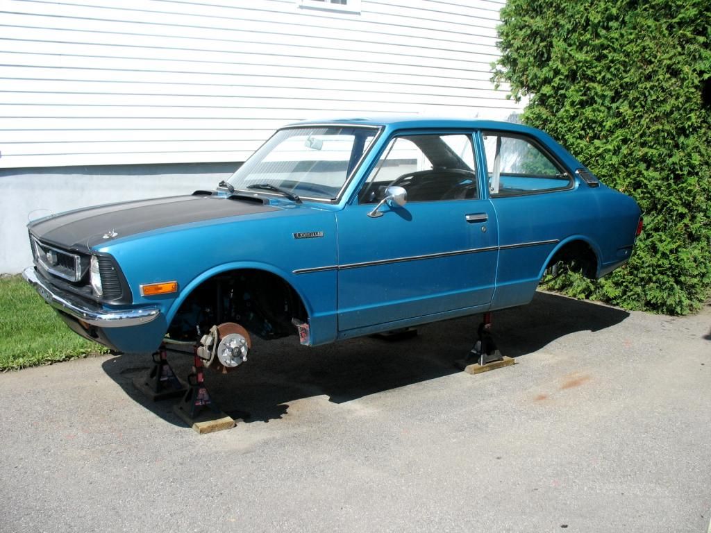

Work also happened on the shell
Did that without a cherry picker... alone... thing is heavy but not "that" heavy. All that's left in the engine bay is the BMC and the steering linkage. Now I'll be able to take care of the rust, because the frame rails are looking bad!!!

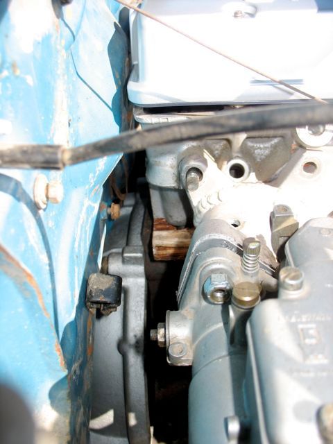

Thanks for the advice although there is not a lot of place for such a seal to fit on the case. I've heard that o-ring could held up but I do agree that it's not a perfect solution :?
Everything fits like a glove
Except : being LHD, guess where the rack pinion goes? So I might have to trade my awesome rack for a stock one if I want it to stand a chance of fitting it along that silly engine. Or it may be time to find a clean RHD shell somewhere... ;)
Got the cam cover painted as well... turn out nicer than expected
Now can't wait to show up in a garage and ask for an oil check up lol
So here it is. Everything is fitting perfectly except for a couple little things on the coolant side that shall be tweeked a bit... so time to rip it apart, get the crank/flywheel/clutch balanced, chop the rod bolts, electroplate and paint what has been fabricated and throw it all back together... for the last time before startup.. I hope!

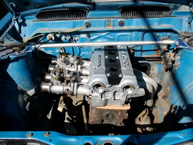

Well, for now the crank is sitting next to the engine bolted to the flywheel awaiting a trip to the machinist... and the engine is literally in pieces, quite a sad picture lol
Meanwhile, finally got my hands on a head that fits my home made DCOE manifold :)

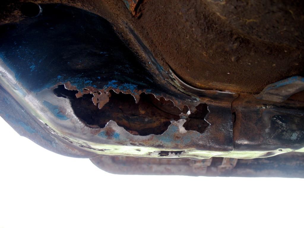

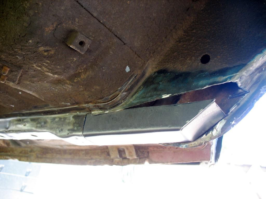

Alright, got off my butts, engine is on the backburner awaiting reassembly but I need a shell to throw it in so this happened

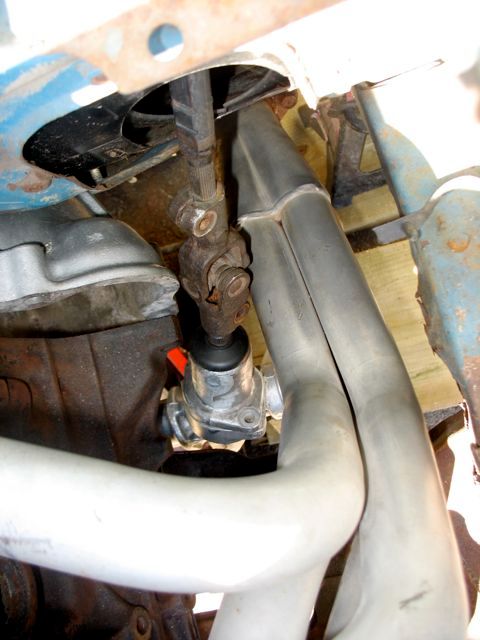

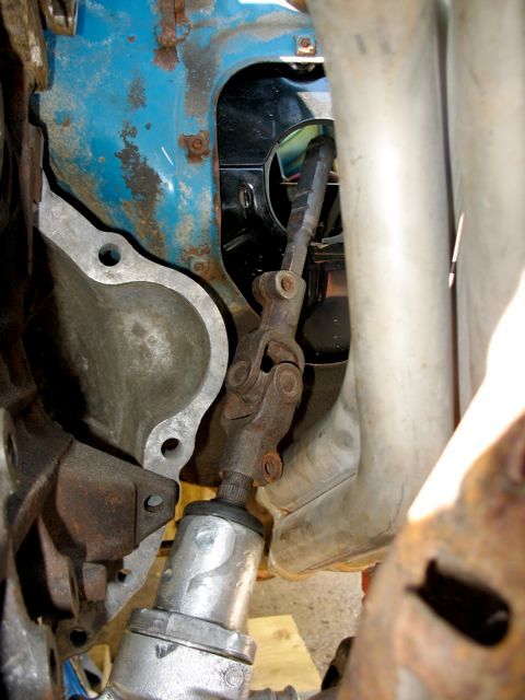

Tore the steering box away from the column... litteraly cut it off as it's the most retarded steering box I've ever seen... anyway all the steering linkage is out as well as what was remaining under the car : hand brake cables and the exhaust...
..which is rotten to oblivion... but anyway who would use that?
So the painful art of welding on my back upside down began...

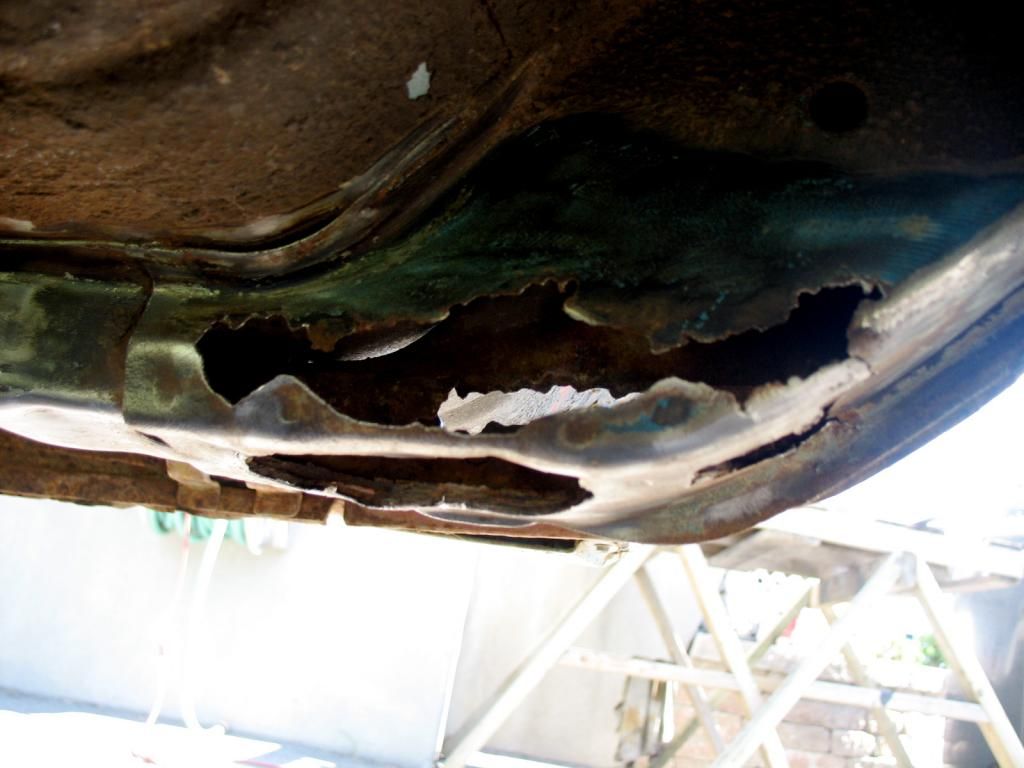

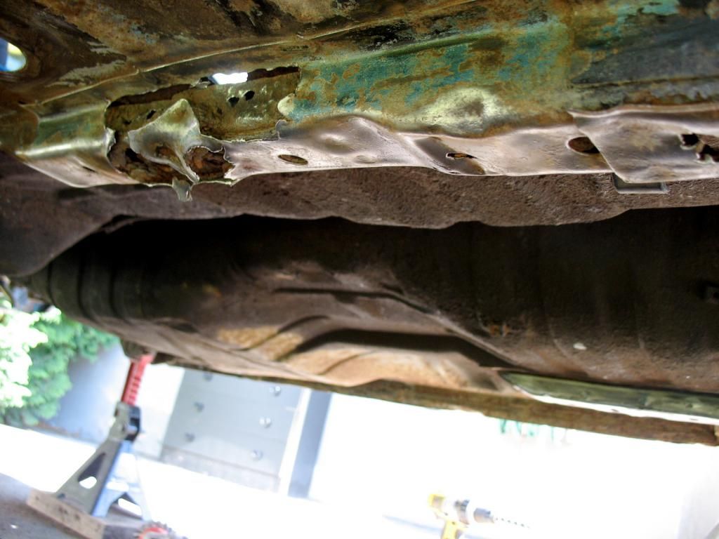

Here is my amazing frame rails... when you can see right through it before hitting it with the wire wheel, you know you're in for a lot of crap...

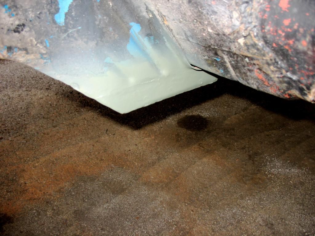

Yeah, it's bad... so bad that I couldn't remove the crossmember as there is no place for the axle stands anywhere else... and this is not a good place for them right now lol

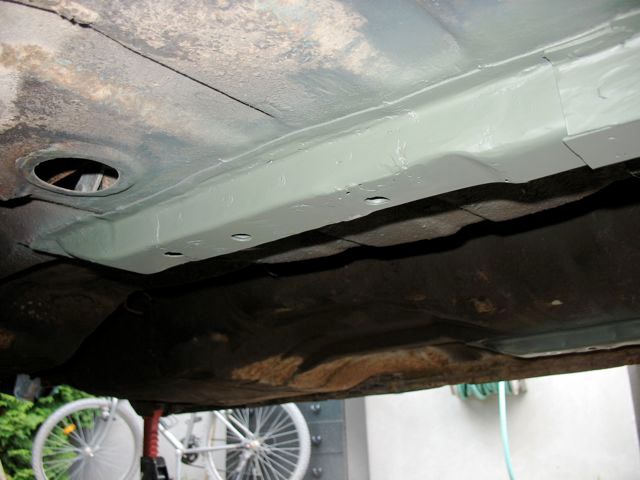

Luckily, the back section is mint
Remaking the front section after cutting out the rotten part
and reskin on top... I redid them as toyota did 40 years ago... I have some plans to reinforce the chassis but I first want to bring it back to stock specs before modding it.
Yeah, I've got a driver side frame rail !!!

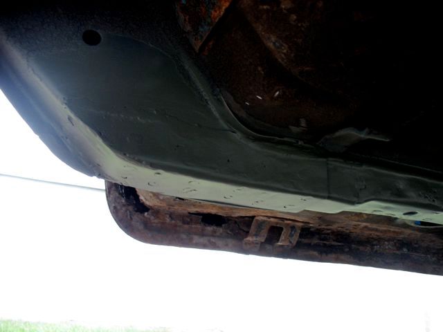

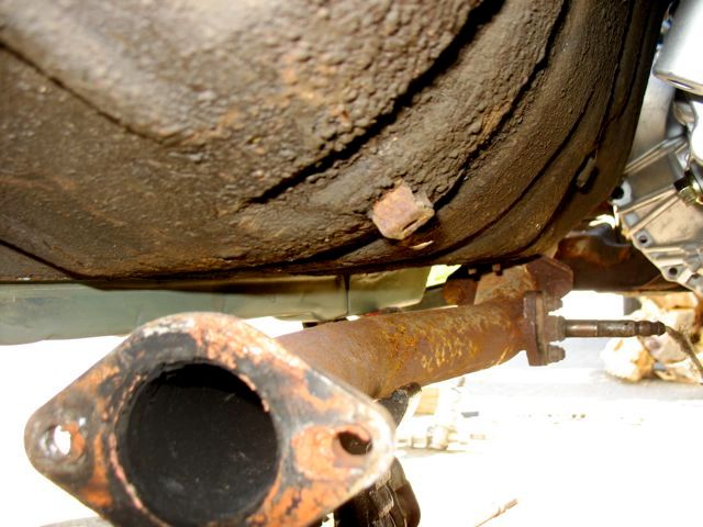

Now on to the much worst passenger side
Well the passenger side was a real PITA... got tired in the end so welding looks a bit crappier... but it's all very solid and above all : rot free :D

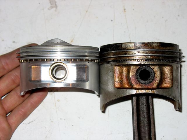

reduced compression height for even looooooooonger rods hehehe

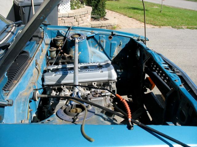

So while the engine is stripped all over again awaiting the rods and all, I scrambled together a little mockup in the engine bay while the crossmember was still in there before attacking rust on the frame rails
Oh yeah! Decided on a 4° lean to the driver side and 4° lean backward to help put the oil drain at the lowest point. You've got to love the 3/4" plywood between the head and block to serve as a deck spacer to get the old bluetop block deack height at around 210mm (the 7A is 206mm but I figured an little extra clearance shouldn't hurt)

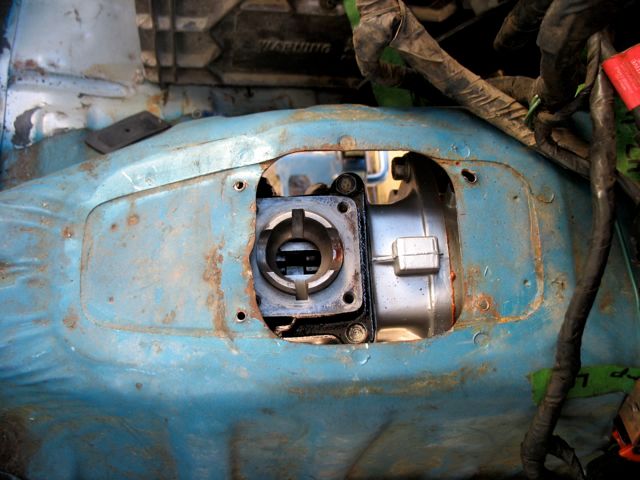

So I slammed it in the firewall

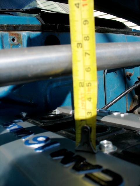

The head is not inline with the block : I need to shave the bump in the firewall for it go where I want it to. Clearly visible on the picture.

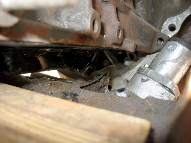

And thank god I used a short tail housing on my late T50 tranny because even then, it's a bit too far back. Longtail housing would've been on the handbrake or too close for confort. The whole motor/tranny assembly is a good 40mm back compared to dropping it in the 3K engine mounts
So I dropped the engine until I got 1/2" clearance between the pan and the crossmember... lots of room on top ;)
Once the steering lock brackets will be cut, the oil fitting will clear no problem
But my biggest fear was the interference bettwen the oil pickup and the rack... but it clears with room to spare. Check the clearance with the crossmember ;)
Fits like daddy in mommy ;)

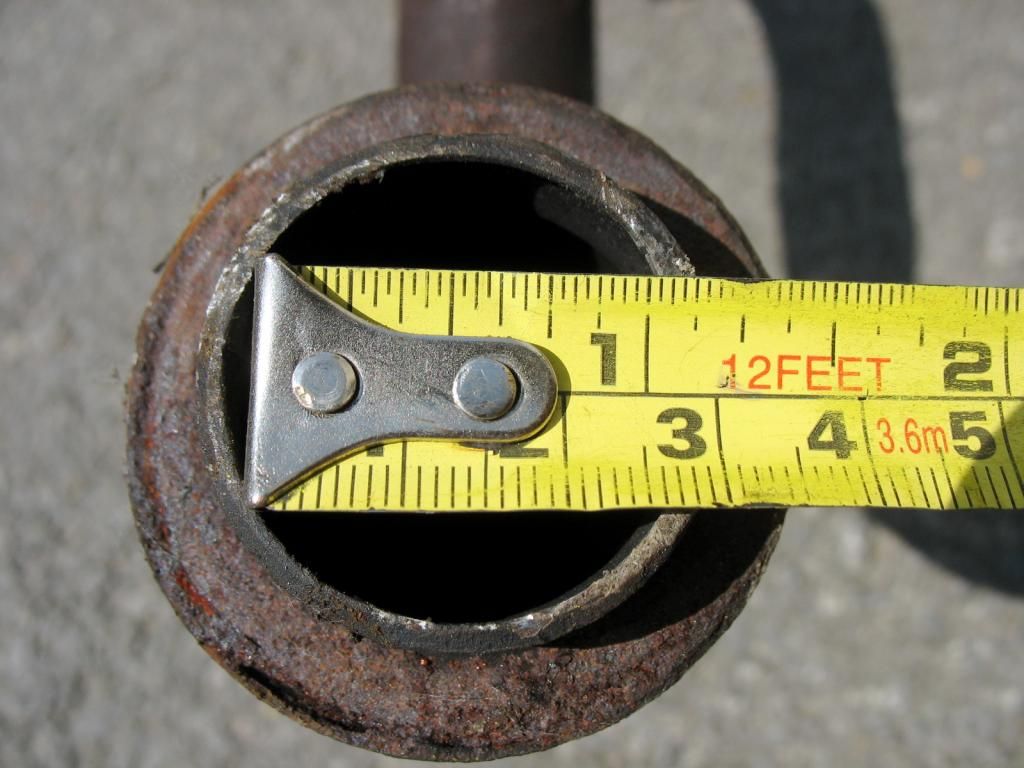

Even the darn header is litterally bolt-on, the flange connecting the front pipe bearly hits a heat shield bracket on the floor, but nothing a grinder will not cure... and lets not forget about the extra 4mm clearance using the real engine.

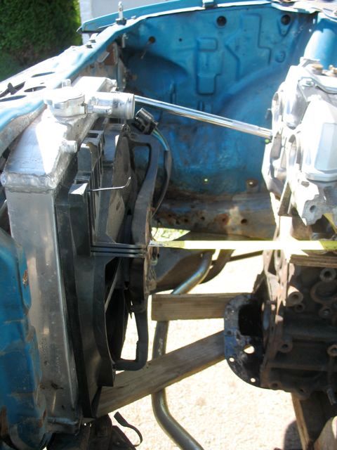

I also mocked up the rad to confirm that I had almost too much clearance
So no major hurdles with that. I'm also stoked that the AE86 header fits so nicely on that chassis... using a taller block.
So stay tuned, lots of good things are comming!

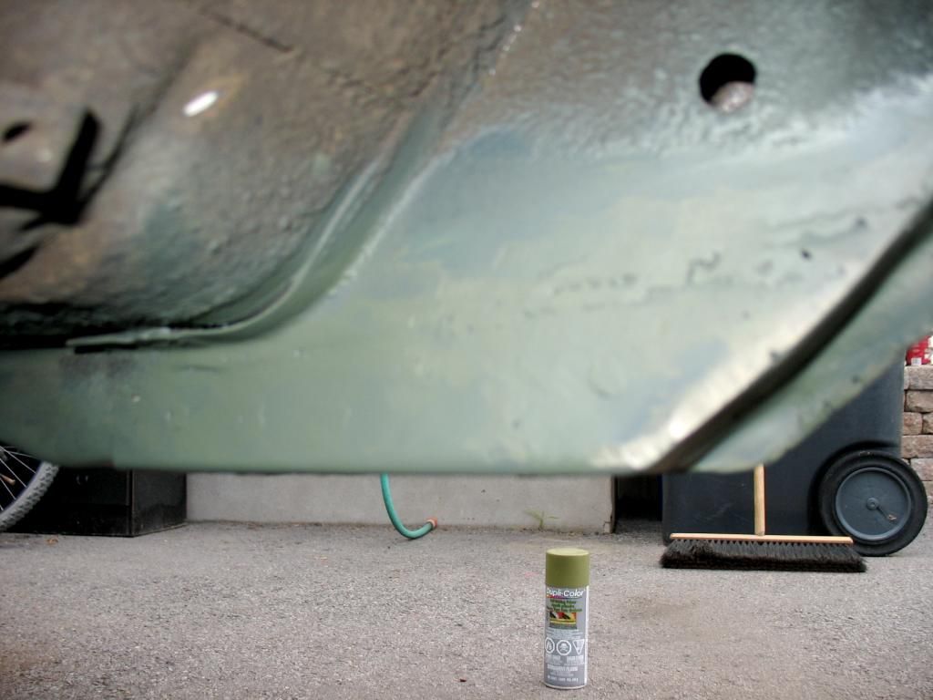

For the frame rail I just redid it the way toyota did it at first... I cut the whole section that was rusted but manage to keep a section of it in place so no question about placement and things, it's where it's supposed to be. Just be patient, try and bend a single piece to replace what you cut and weld all the seams where your cuts where made and spot everywhere else where you overlap two sheet. It's not fun but it's pretty rewarding.
