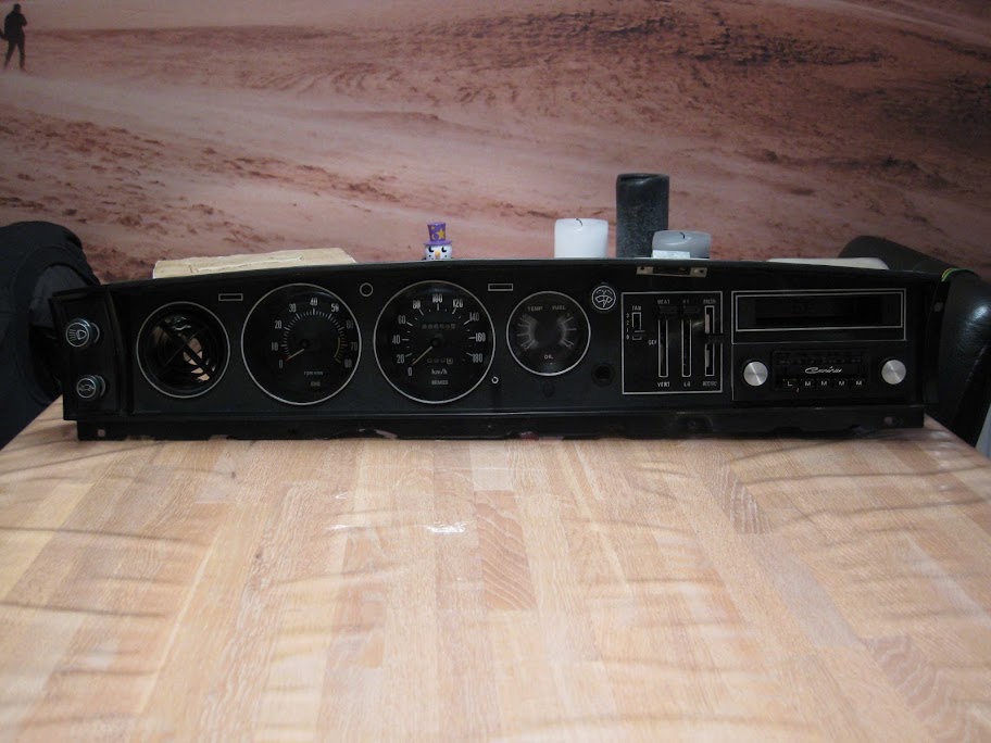

Rebuilt Dash with radio in it: Including tachometer and replaced combination meter:

I like your DIY work. Your radio has me thinking. I may have to find another one in the parts yard.
