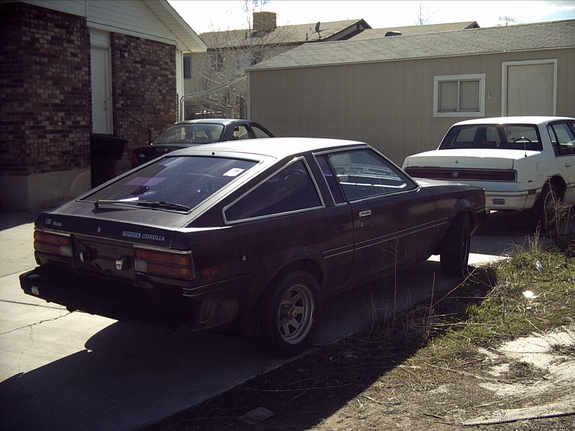

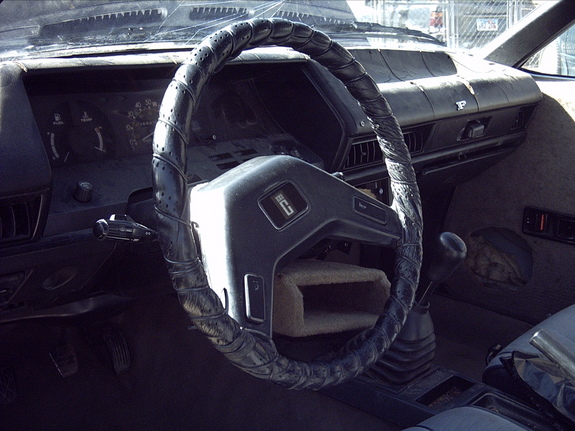

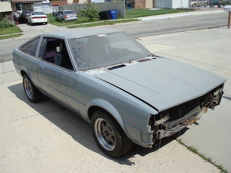

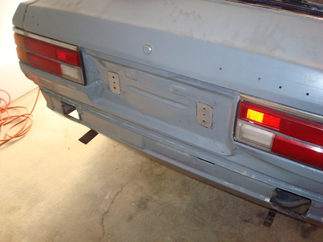

So, figured I would post my main project here just to show and get the inevidable advice :)
My main project is my 1980 Corolla hatchback. The first one I ever owned was suppose to be a temp car till I could find a car I wanted. I liked the body but that was about it. Ended up loving the car. A year later had to get rid of it and decided I would buy one later when I could learn how to work on it and have a place for it.
Well, the time came to buy another one in 2005 or 06. Found one in Wyoming for under 500 with a mostly straight body and almost no rust. Drove up, test drove it and bought it. The car made the drive back to SLC with a shot carb and stuck caliper.
Here is how I received her.

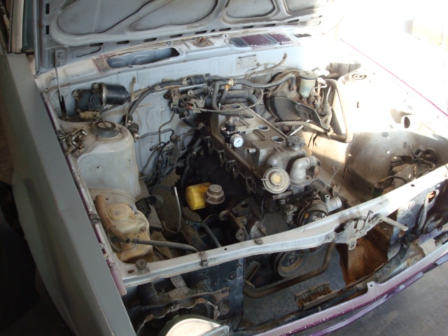

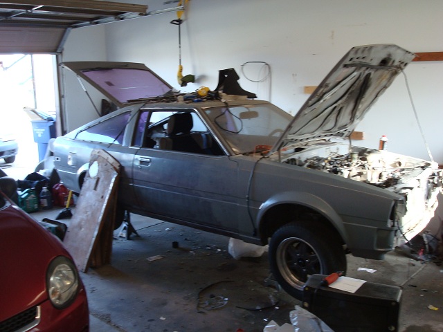

Taken from my 3tcgarage thread. This was right after getting my house in July of 2009 and the only stuff that had been done is taking things apart.
So, I have had this car for years and bought it only as a project......so no need to rush. After buying her she has mostly sat until the last year where I have been taking things apart and gathering parts. I have acquired almost everything needed to have her running with EFI and edis. Just need new injectors and to quit being afraid of breaking something. She will be running a MS for fuel and spark. I have started running 3/8's fuel line and have a Walbro to supply it when I get her running.
The overall plan is to get her running NA and learn how to tune. When that is done I will get a turbo and exhaust and tune that. All will be done on the original motor. I hope to get the tuning down well enough before blowing the motor :) Once the engine blows, or figure I have a good hang on the tuning, I will be rebuilding the motor and stripping the whole car down. Figure I want to have fun with her running before taking her back down.

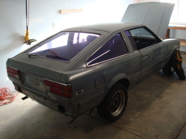

Here are some current pics of her state................I have neglected her for way too long.
Where I am going to learn how to do body work.

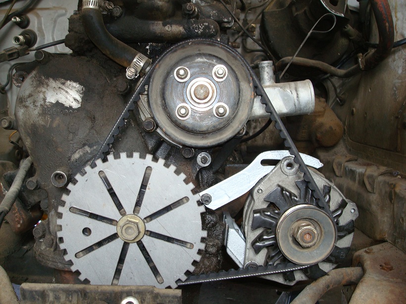

More pics of progress I had made setting up EFI, alt upgrade, etc.

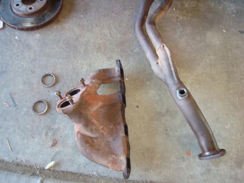

The exhaust about to be cleaned up a little after having the o2 bung welded on.

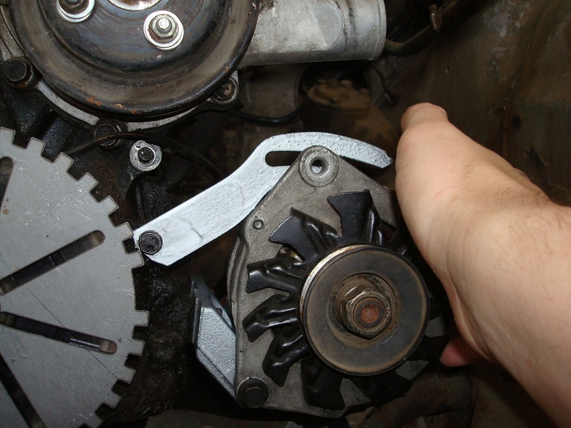

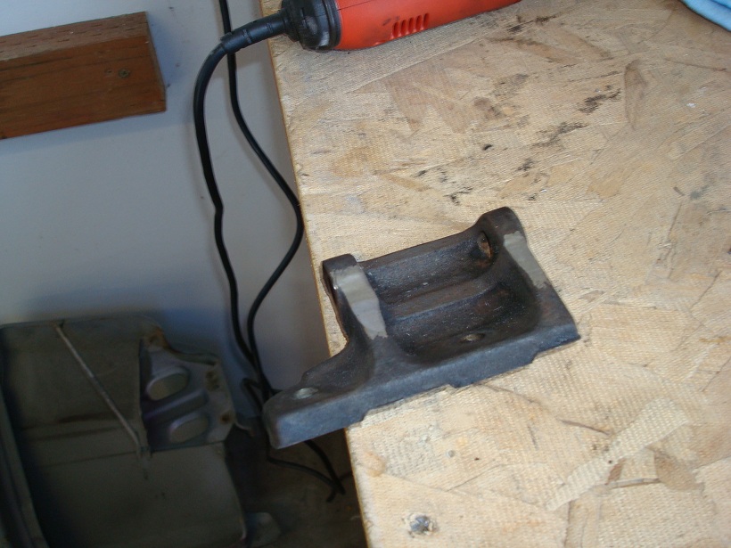

Modifying the alt bracket.
The furthest I can move the alt in now.
Belt on. Plus I had finished the wiring for the alt at this point.

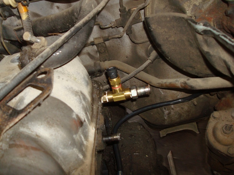

Coolant sensor location.

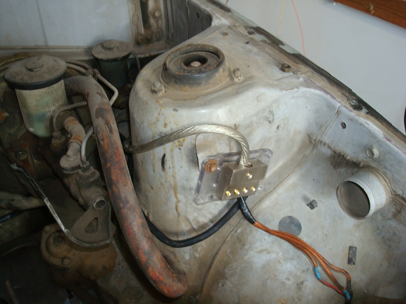

Power distribution.

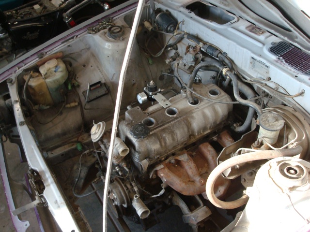

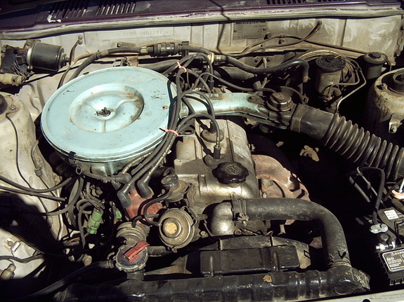

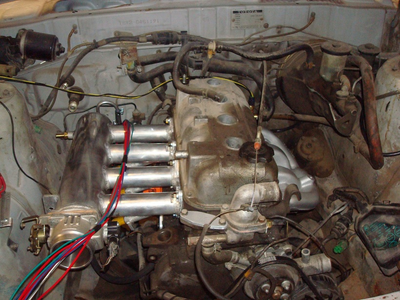

How her heart currently looks.

So, here are the pics of how her motor sits. I realized after trying to route my wires that I really screwed up my wiring. It could have been so much better. Oh well, I will address it when I blow up the motor or tranny (which ever comes first).

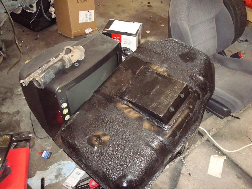

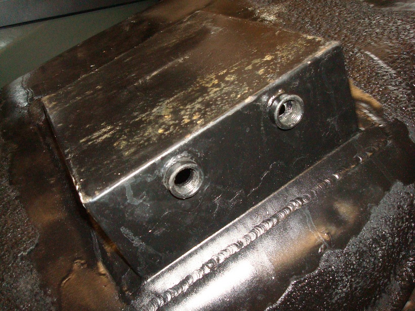

Here is the modified gas tank.

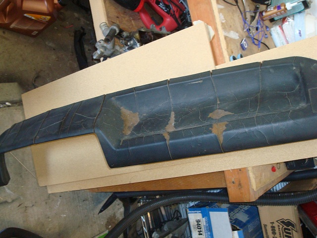

Repair/Replace my door panels while adding 6.5 speaker rings.

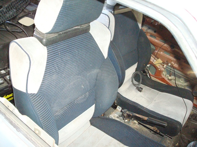

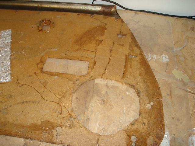

I have the driver side bolted down and the passenger seat needs a couple more tweaks.
Started figuring out wiring routes for the front door speakers I will install.

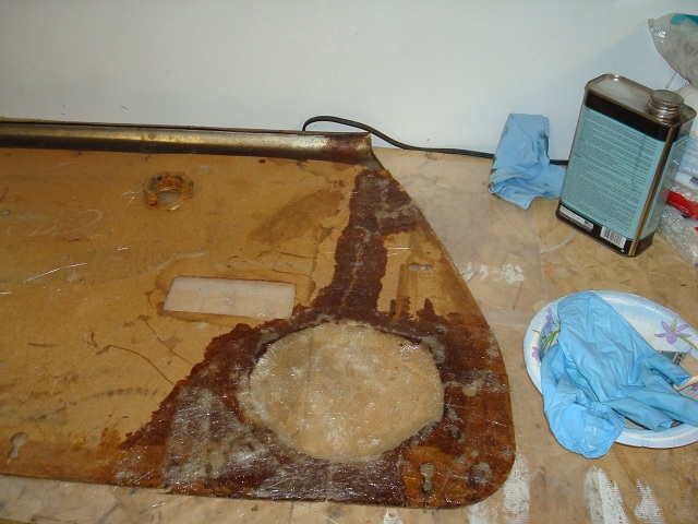

Started messing with fiberglass to reinforce the old door panels.

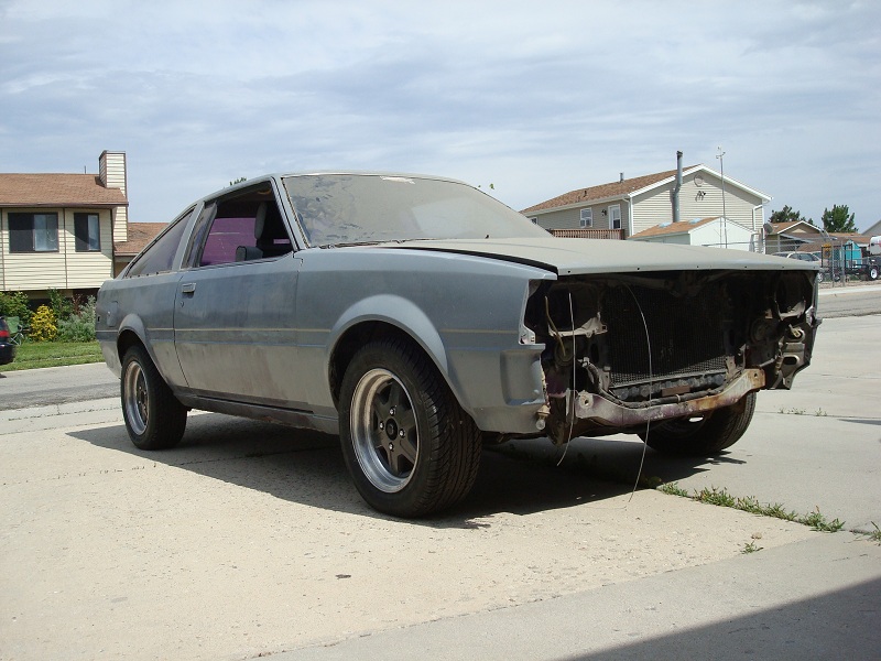

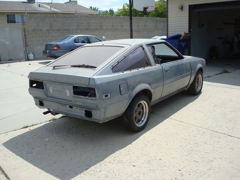

Well, she finally moved out of the garage today under her own power. Still haven't installed my radiator fan, so I didn't let her run too much. That and I screwed up the soldering on my relay box so she didn't always want to start. Found out it is the main power relay socket, so one more thing to address.

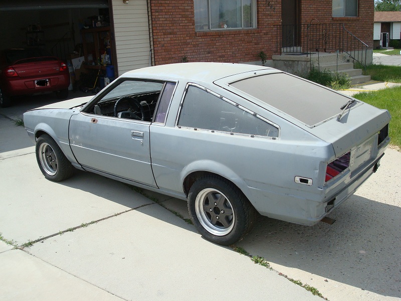

Proof that she left the garage today lol.
