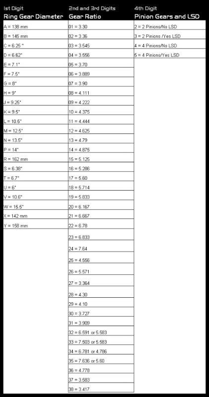

PostPosted: Thu Feb 16, 2012 5:52 pm
Joined: Thu Feb 16, 2012 5:33 pm
Location: NC
whit wrote:
is F302 lsd equipped?
F is your ring diameter
30 is your gear ratio
2 is LSD or open
in your case 2 is NO LSD
Usually a good rule of thumb is odd number (3, 5) is LSD

 Post subject: Re: LSD code for 81 supra ma47?
PostPosted: Thu Feb 16, 2012 6:48 pm
Joined: Fri Feb 15, 2008 11:16 pm
Posts: 670
Location: Saratoga N.Y.
Thanks for posting the chart,I will print it out.
