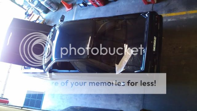

Step one, jack up the car......
....so we can fit the jack under it ( :roll: )
And remove the under tray.

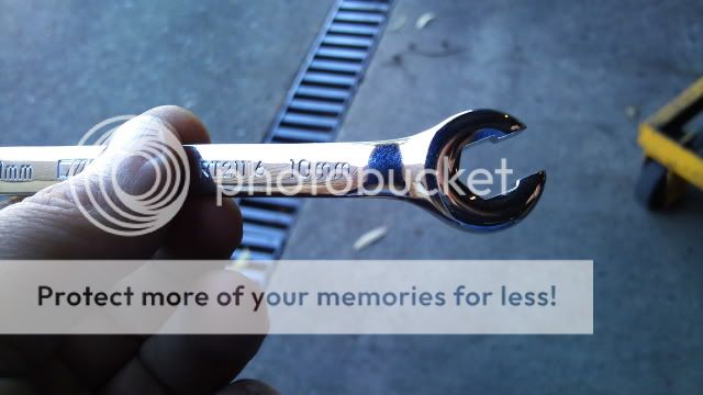

Time to remove the drop link. two 14mm spanners will do the trick.
Remember, they been there for close to 1/4 of a century, a couple of well placed swear words should see them undone
The joint in my drop link was dry and a bit rusty so I put a bit of kerosene in it and blew it out with air and then pushed a heap of grease into it

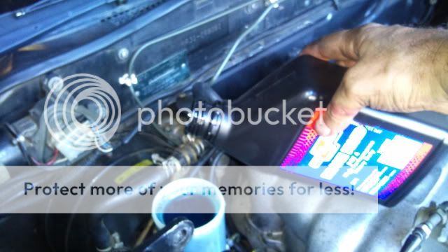

Also Got some brake fluid.
Really good stuff this. $15 a bottle from Austrack Motorsports/ Revolution Racegear in Minto NSW. (Ph 9820 4255. Australia)
I can't speak highly enough of this fluid.

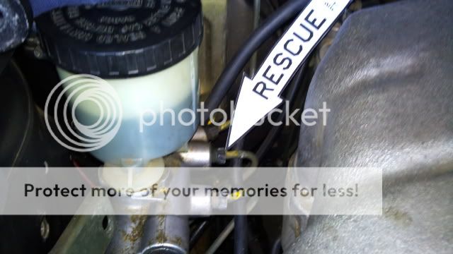

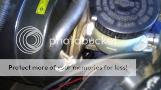

Got an early xmas present
Leaking master cylinder.
I have a few leaks that need fixing now;
Brake fluid from the master cylinder
Coolant from the turbo line around the rear of the head.
Gearbox oil from the rear gearbox seal.

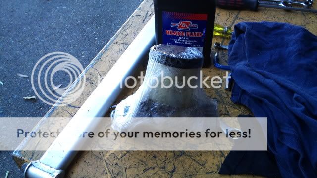

Time to change my leaky brake master cylinder.
Got this one from a friend of mine, He likes to keep his parts fresh
It's off an R32 GTST Skyline so it's slightly different internally. Externally? exactly the same.
The difference is the bore is 15/16ths for the R32, 1" for the R31.
It should work well with the brakes I have put on.
The twin pot brakes have a smaller volume than the standard single piston ones.
I will now have better brakes with better feel.

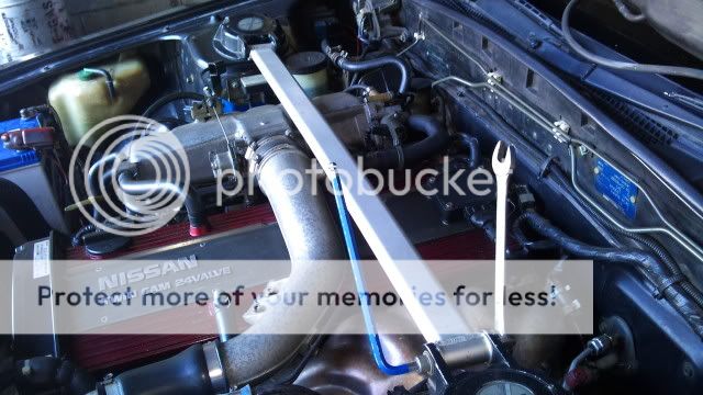

First up, gotta get all the paraphenalia out of the way
Strut brace..
Master cylinder brace..
Boost sensor, related brackets, etc etc...
Trap for young players.

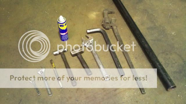

Flare nuts.
These are bastards to undo.
Best to invest in one of these...
Flare nut spanner.
If you use a standard 10mm open ender on these, chances are you will round it off 95 times out of 100.
The reason is that the nut is quite thin, and if it has been there a while it won't want to undo.
So what will happen is the nut will deform, then you start swearing, go out and buy a flare nut spanner and that won't fit because the nut is bent out of shape and rounded off.
Then it'll be time to get some more serious tools...
And then some even more serious tools...
then call some professionals...
Or invest in a flare nut spanner for about $10.
Here it is again
Trust me, buy one.

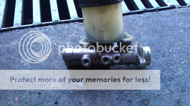

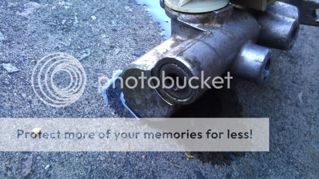

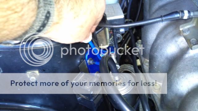

So, once you have those little bastards undone, undo the 2 nuts the hold the cylinder to the brake booster
and off she comes
Looks like she was leaking from the front.
Fitting the new cylinder is pretty much the reverse of the above.
Just nip the flare nuts up, the flared seat provides the seal.
Don't do em up too tight or you will be back in the shitter next time.
And here's a trick, get the flare nuts started before you bolt up the cylinder to the booster.

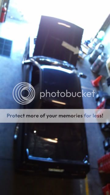

Aaaanyway, start with the wheel furthest from the master cylinder.
That means; if your car has a steering wheel on this side...
...you start with this wheel...
...and progress to the next nearest, which would be this one...
...then this one...
...and lastly, this one.
But....if your steering wheel is on this side...
...you do this one first....
...then this one next...
...then...
...and finally...
Got it? furthest to nearest.
Okay, first top up your master cylinder
