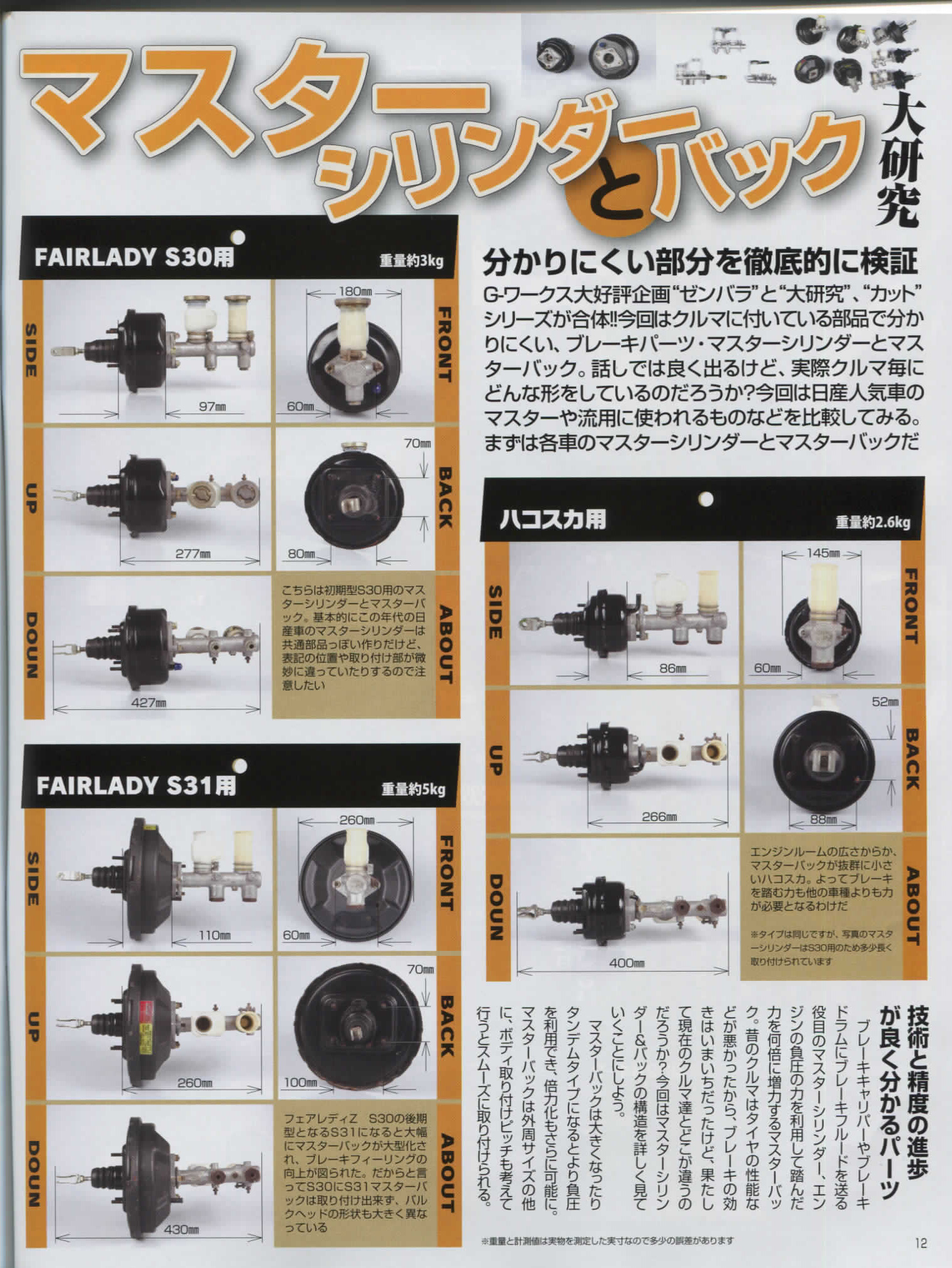

Dave (sennavsprost) happened to pick up the latest issue of GWorks a couple days ago, and inside he found a full article about the different master cylinders - with dimensions... talk about timely...
If you need a higher res version, download it here:
http://www.ericgbauer.com/JNC/MC_high.jpg
