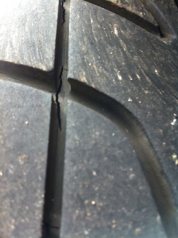

The Bridgestone Potenzas that came with the car had some issues... The rears were 10yrs old and tire shops refused to balance them because of their age, the fronts had cracks in them all along the grooves and it turned out the majority of my wobble at freeway speeds was from them:
So goodbye Potenzas...

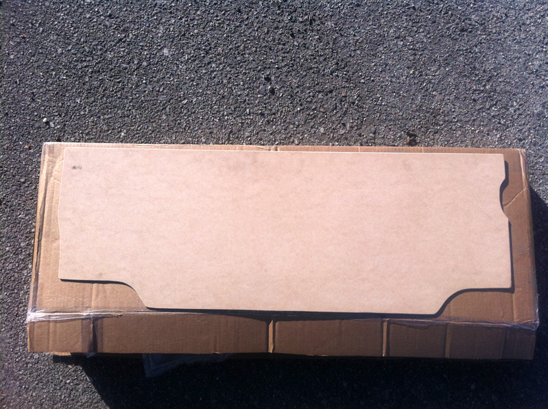

So when I met up with Eric ("ImPo") at Cars & Coffee Irvine last month we were comparing / contrasting his 4dr and my 2dr. I saw that he still had the trim piece in the trunk that separates the gas tank from the rest of the luggage space. I asked him if he could trace out the pattern on a large sheet of paper and send it to me so I could make one for myself (my car didn't come with one).
Well I got a large surprise box at work today, and instead of sending me a large roll of paper, he sent me the actual trim piece he had just made up for me...
It's really nicely finished and I'm super stoked on it.
If your car didn't come with one, or yours is damaged you should consider hitting him up and see if you can buy one from him...
