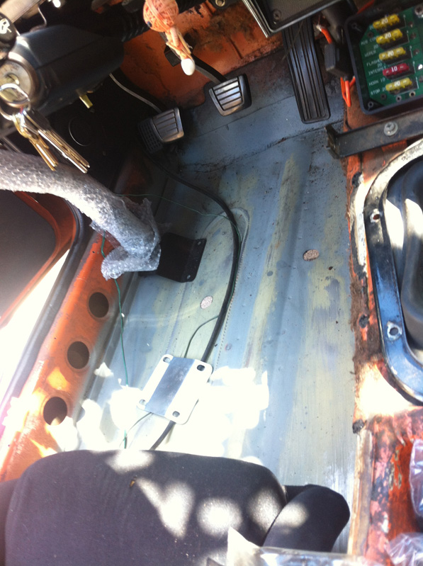

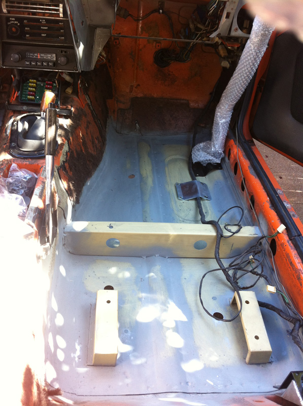

Some pics of the completed new floor pans from inside the car:

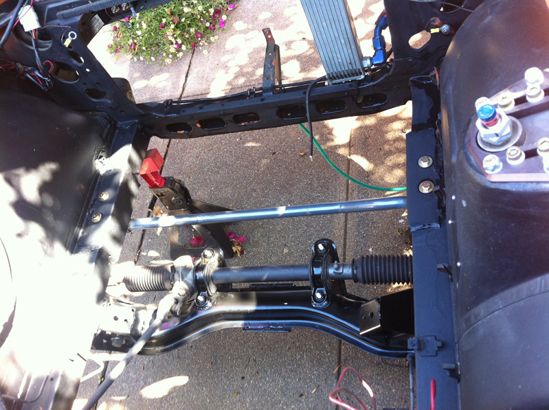

Also got the front sub frame, trans bracket, rear diff bracket re-powder coated black & back in the car:
For those of you with lowered S30 Z's, you might want to consider relocating the pivot point for your front lower control arms
It'll help your front end geometry along quite a bit - John @ BETA Motorsports did my front sub frame before I had it powder coated. Came out real nice & definitely helps to get some angle back in the FLCAs on my lowered track car...

Did ya tell me what that bar/brace is in front of your front X-member?

The gunmetal bar forward of the front subframe is just my front sway bar
