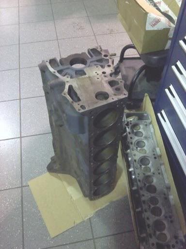

I also sourced out a F54 turbo block and matching P90 head online for a great price so I picked it up in hopes to one day rebuild it with some power and swap it in.

Yeah that front body kit bumper definitely took away from the sleek line of the car. My clutch master cylinder seal just started leaking recently and I have the replacement but I broke my collar bone last month so I haven't been doing much. And yes I'm still running the stock injection system. I'm not trying to do much while this motor is in the car. I want to build the F54 and P90 with a decent turbo to make a safe but fun DD. I want to go with a distributorless setup using this bracket from zccjdm.com
