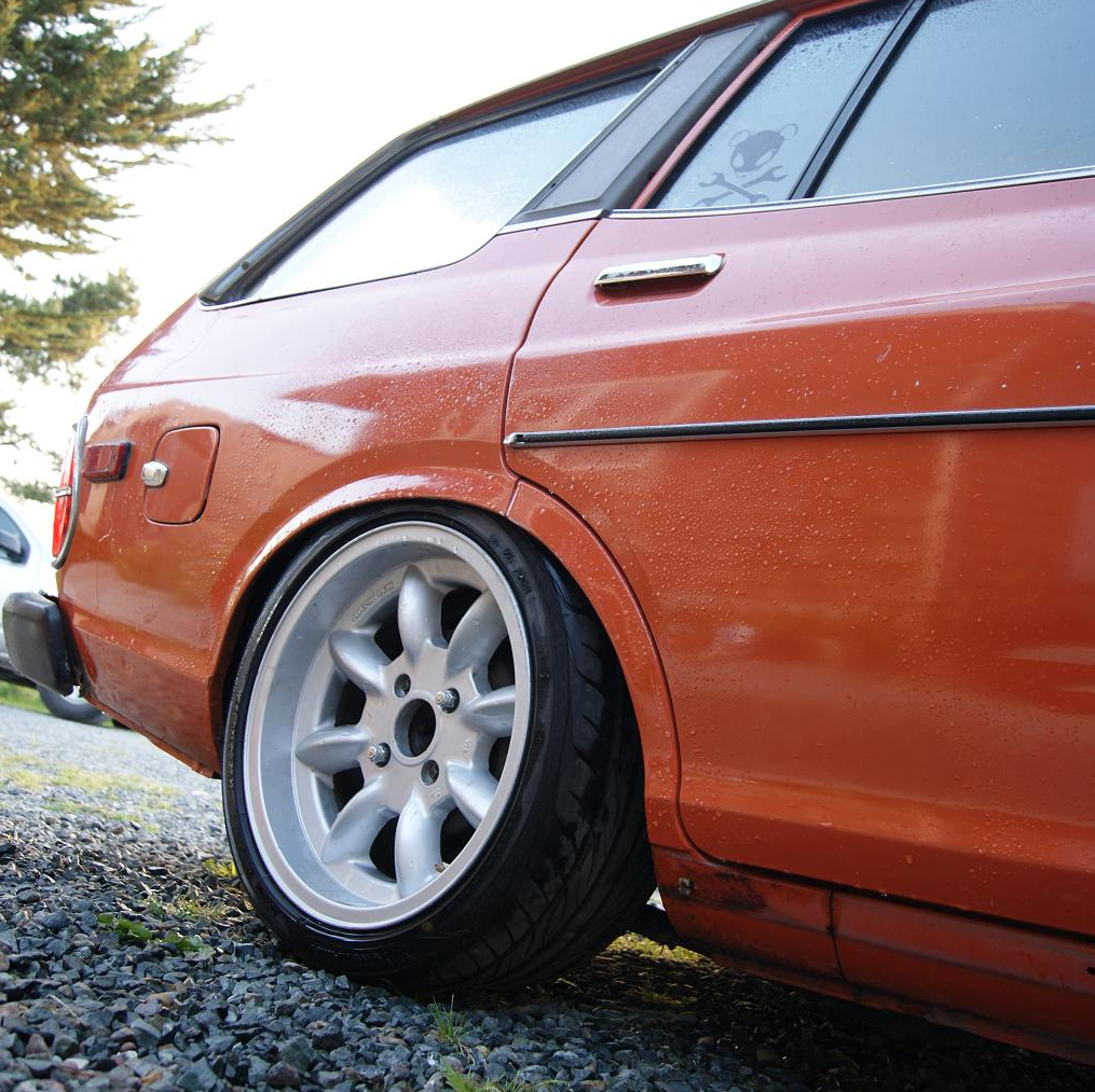

Front: 16x7 +0mm ..... 195/40/16 Yokohamas
Rear:
16x8 +12mm ...... 215/40/16 Yokohamas .......... rolled fenders, .... 3" blocks,,, stock leafs/shocks ...... 300lbs of concrete in the back,,,, tires rubbing badly..... :D

Nice low you have over there :)
