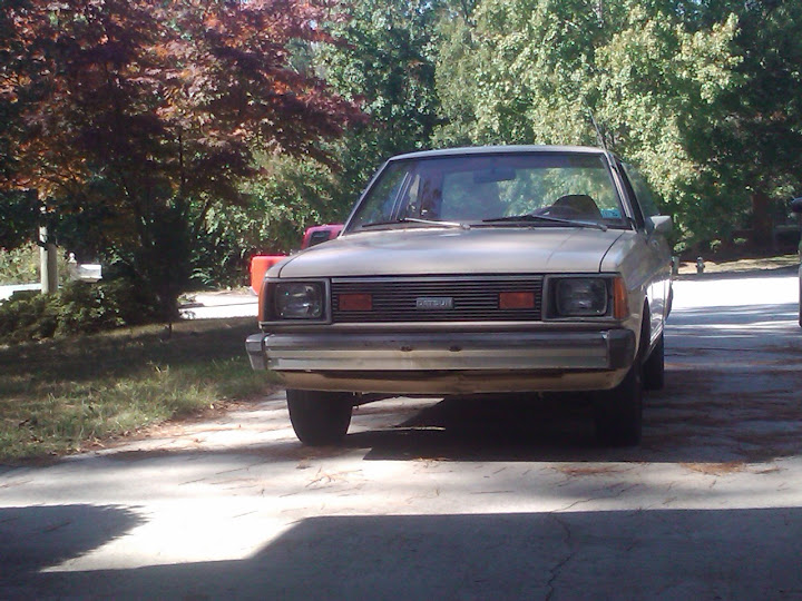

So I just bought a little Nissan 210(B310) and am going to get it running and then let the rally/safari conversion start.
Its a nice little rust and wreck free car with a straight underbody.
I'll post some pictures.

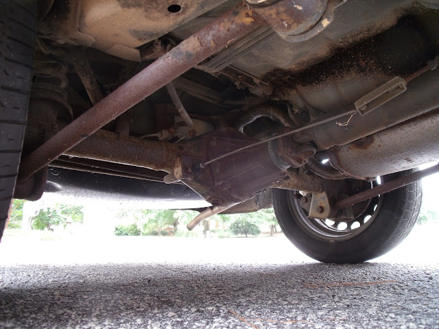

4 link is a huge bonus!!!!

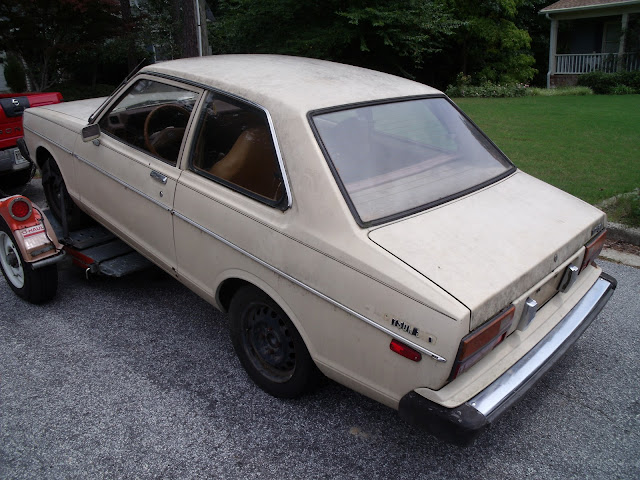

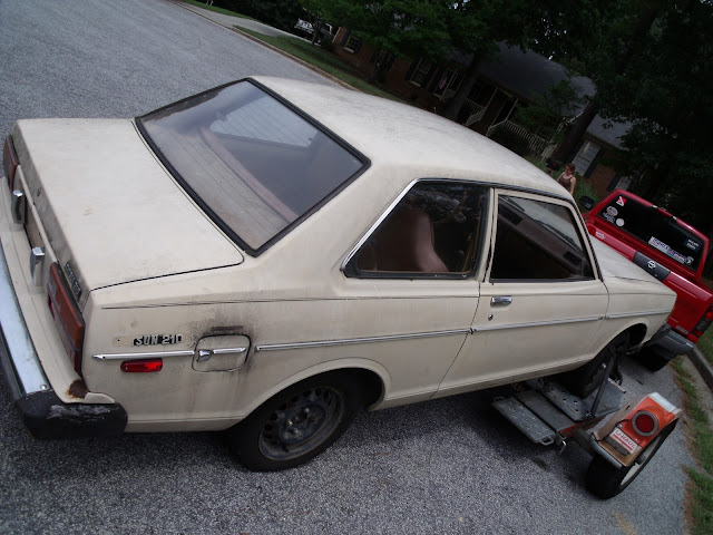

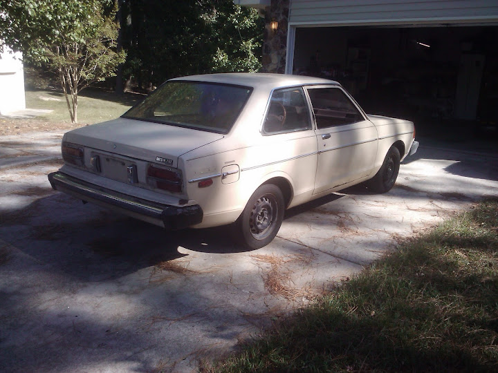

YEP! Already started:
The 310 sitting out behind the race shop:
dash has issues....

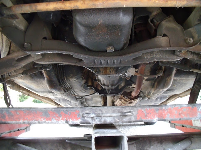

Started stripping the tar off of the floor with a chisel and hammer... got the driver's side. Getting it ready for seam welding...
test spot on the roof cleaned up nicely with a flat can of coca cola and a rag:

87-93 fox body mustangs had an 8.8 rear axle with 4 on 4.5" bolt pattern.
I did not know the 200sx had a solid axle... I'll have to look into that as the 8.8 is beefy enough for ~300hp(more than I need) and then room to spare... offroad driving at speed has a tendency to wear stuff out way faster.
This 310 has the world's tiniest differential.. 145mm ring gear smaller than a legends car differential. LOL!

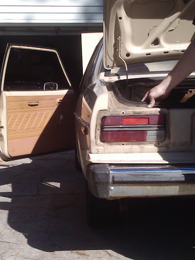

I've been really busy but the last few days I got some work done on the car. I actually got insurance and a tag today and drove it 55 miles!
I pulled out the old tail lights and started looking at the hole in the back of the car.....
Looked really close to the 240Z tail lights I had in the basement so a little trimming and here is what came out.

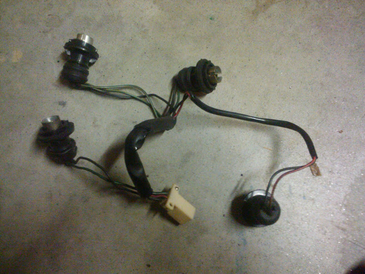

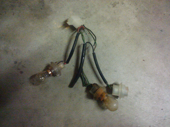

I took the 210 tail light harness connector out and pulled out each of the pins. With the help of my service manual I was able to wire in a 260Z wiring harness(better condition than the 240Z light harness) into the stock 210 connector so no cutting at all is required on the body harness.
210 3 light harness
260Z light harness

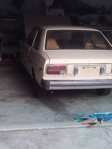

Before:
After:
