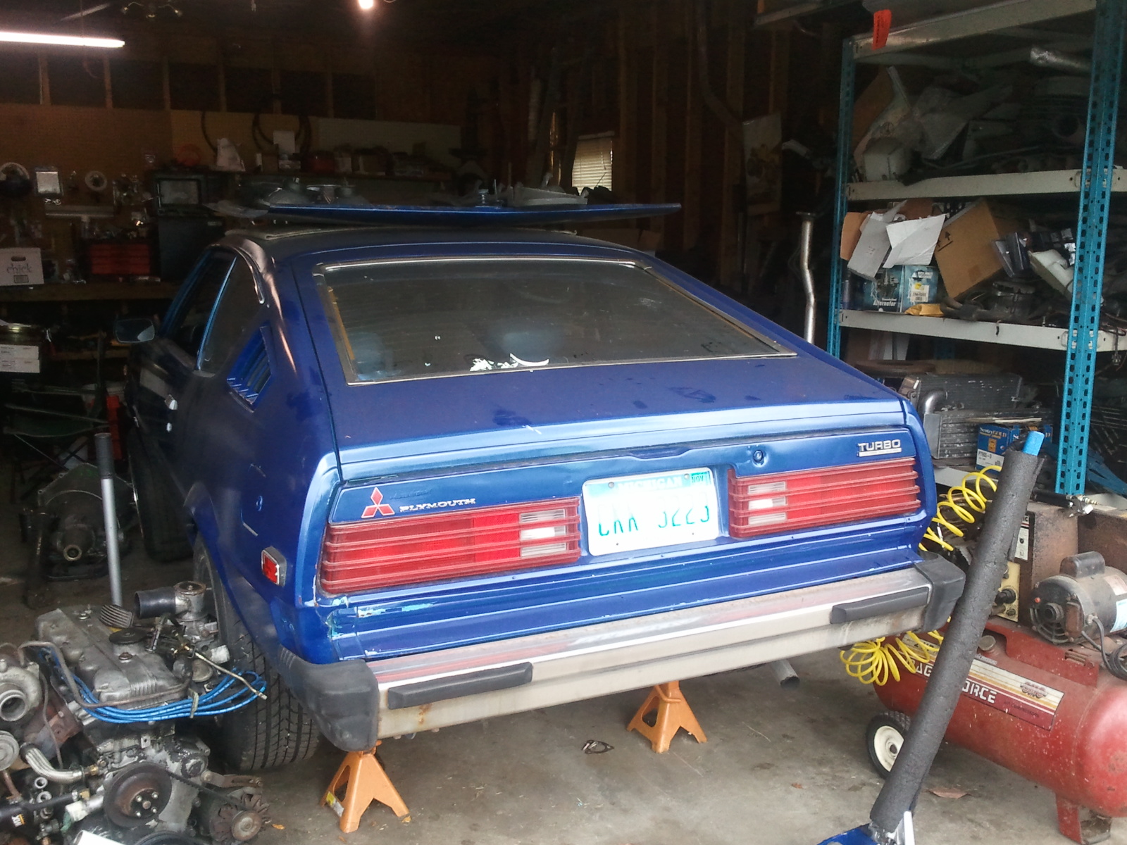

I replaced the og emblems, and added a few.
one being the front plymouth emblem, another is the Turbo electronic fuel injection emblem on the rear, and maybe a mitsu symbol on the IC.
I can remove my cas without much trouble now that I moved the brake line and then massaged the firewall a little. I used a pipe with a rag wrapped around the end, and a bfh.

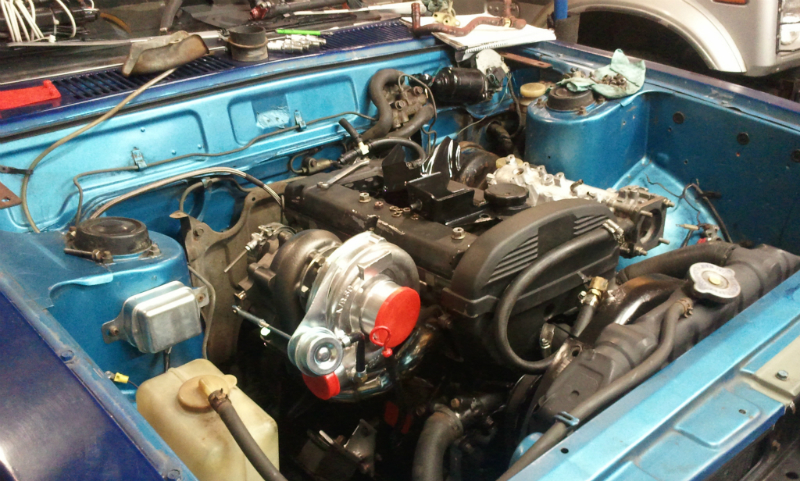

what if I changed my mind a little bit...
Maybe this can be just as fun.
I slapped a hydraulic turbo cam/rockers in, and it looks like my flange will serve as an adapta-plate.
now I am strongly considering megasquirt for this with a 36-1 crank trigger wheel, still distributor, but tbi.

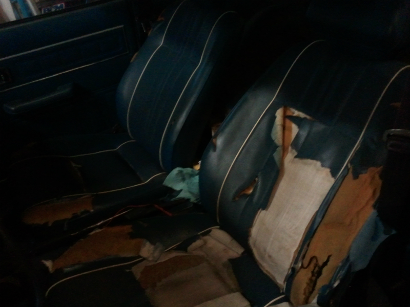

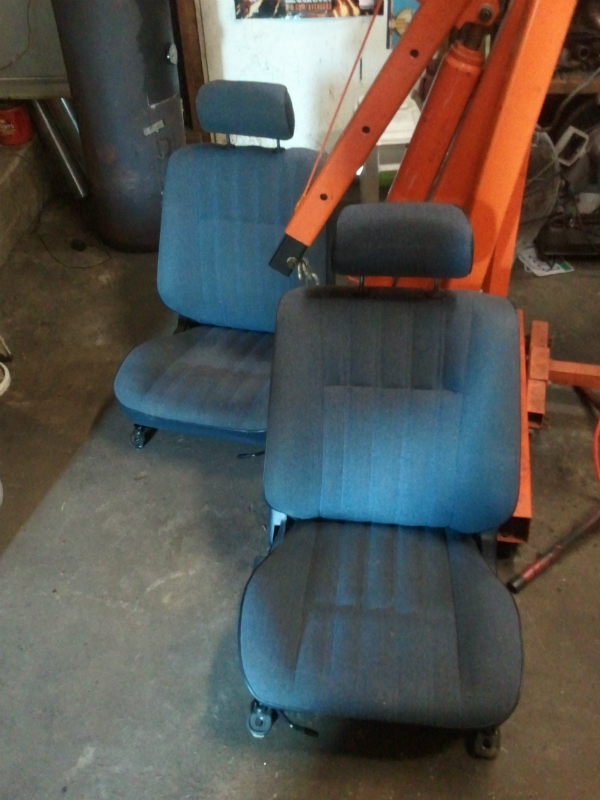

Bought some seats today.
93 corolla seats to be exact. I have not test fit them, but they look like they will fit in well.

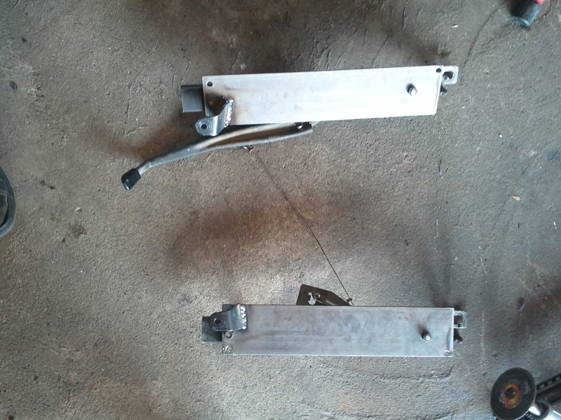

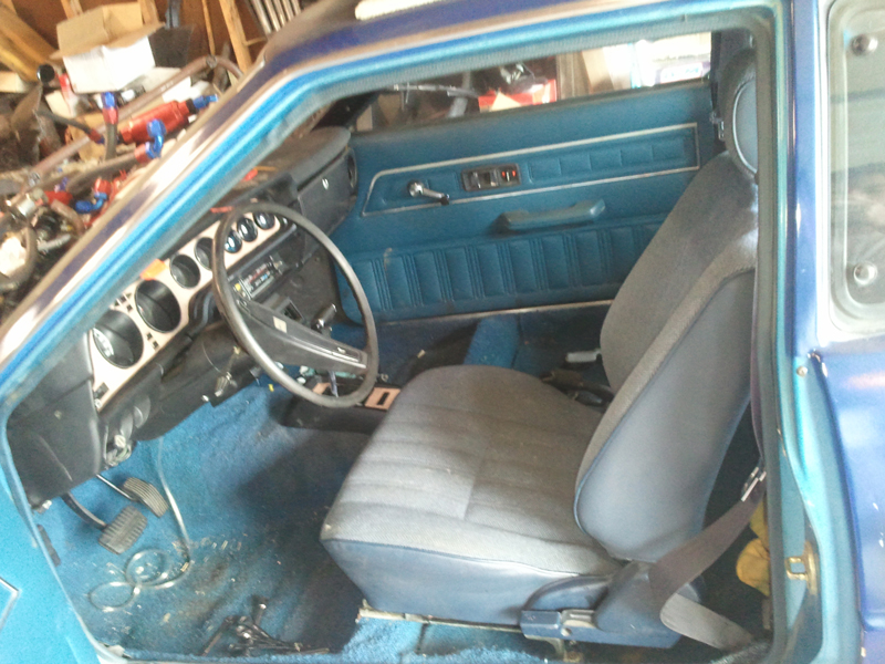

So, I whipped these up.
I painted them black, then installed them.
So far so good.
I'll make the second set once I get more materials.

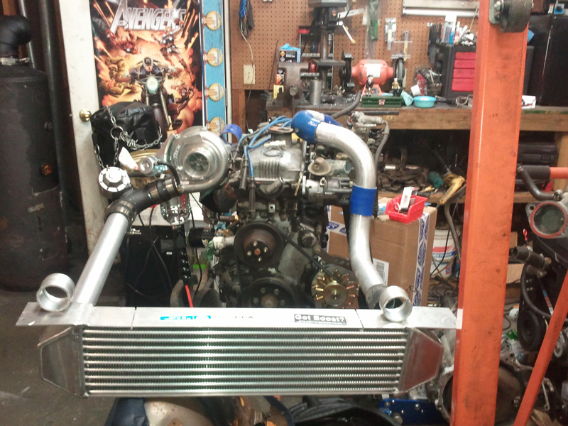

I have to order some couplers, But I think I am going to run my ic piping this way.
My flat parts guy said he should have my 36-1 trigger wheel and mount cut before the weekend.
