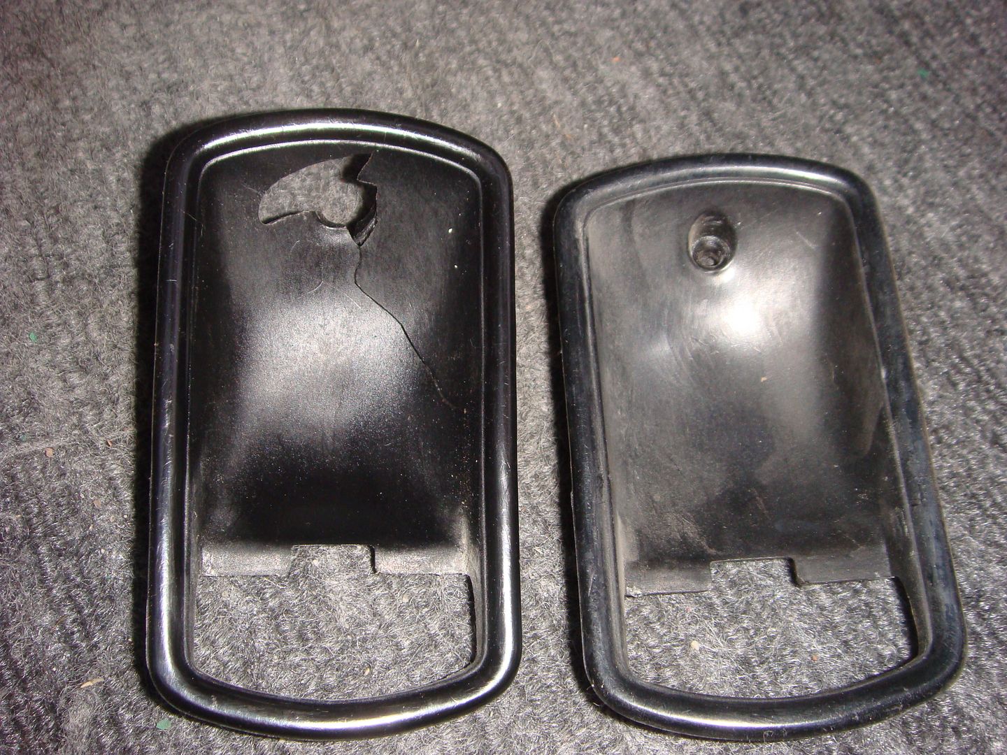

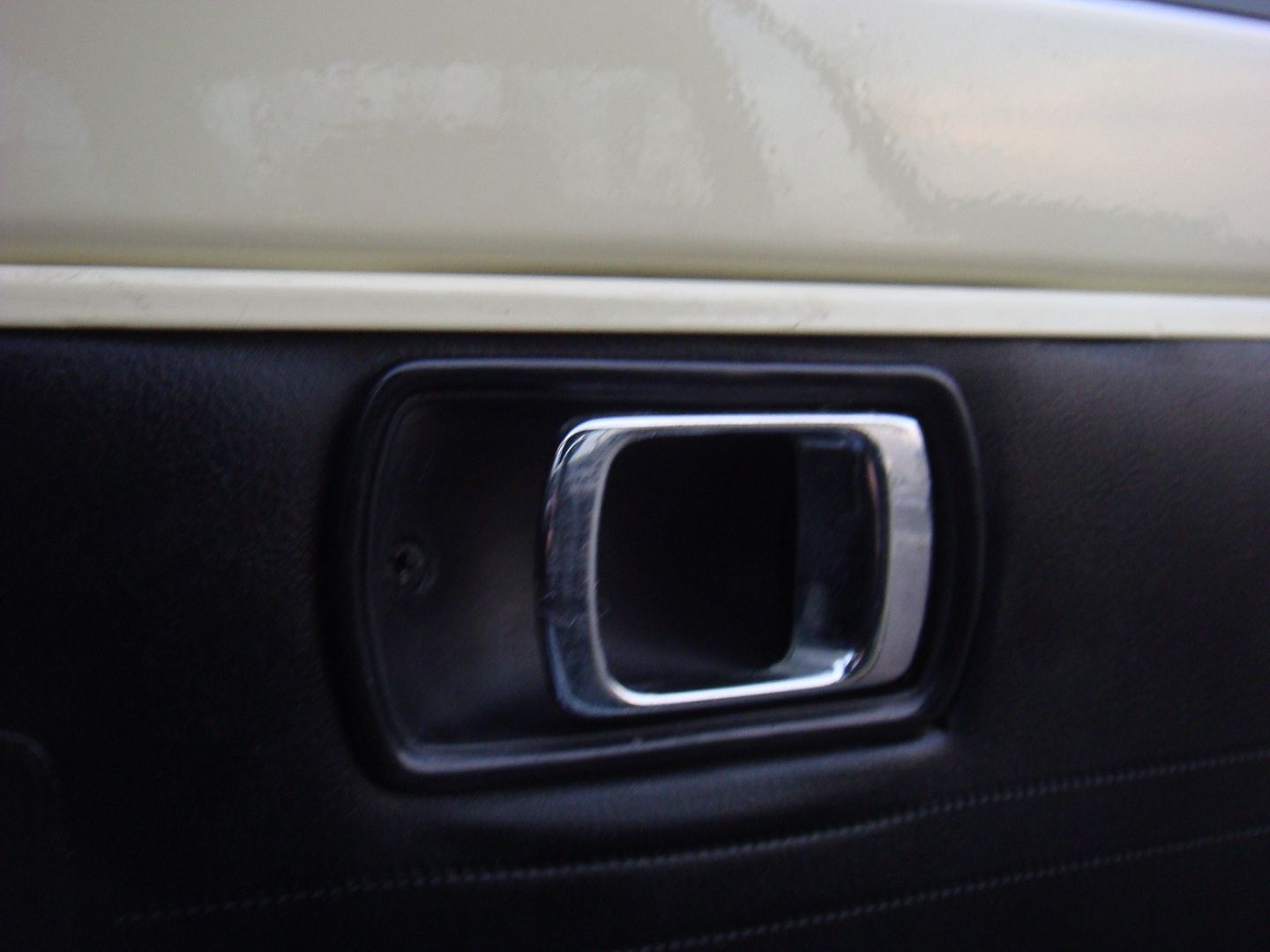

So, now that I had a properly running and registered car, it was time for me to address a few things that were bothering me. So I hopped in and headed down to Classic Car Nagoya to raid their parts car. I came back with these:
My little trim pieces that sit behind the door handle were both cracked and broken.
The pieces I lifted from the parts car weren't quite as black, but they were both very solid.
Installed, I think it looks much better!
