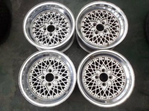

    The first set of wheels getting a resto are Star Sharks in 4x100, 14x6.5 +13
    Here's some pics of what i'm working with

    The set of wheels are currently at a wheel shop getting some work done.
    This includes TIG welding the outer lips to fill the gutter rash, re-rolling the lips to fix the flat spots (one of them is so bad that the tire didn't hold air )
    and finally polishing the lips and spokes.
    i'll hopefully have them back in 2 or three weeks. While i wait, i'm going to have the bolts re-zinc'd locally.
