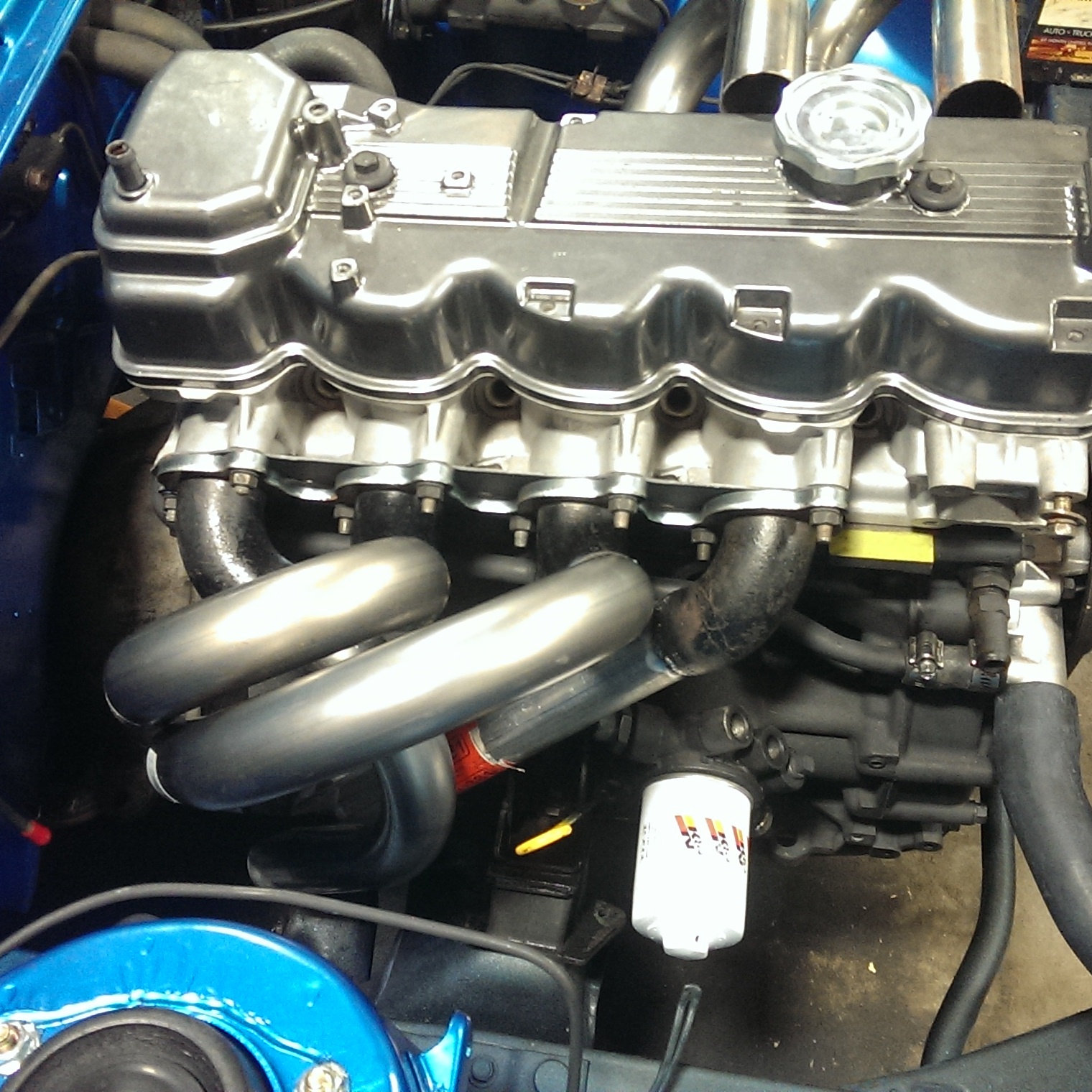

    Working on a 4-2-1 tri-y header.
    I'm going to get her running, tuned, and dynoed in NA form first.
    Then we can see what 15psi does.

                        • So the chinese turbo threw in the flag.
                          I started a tri-y header a while back, and figured it's about time to complete it.
                          It sounds like a harley now....... i hate how those sound.,...
                          http://www.ilostmymind.com/wp-conten...0/imag0297.jpg
                          Comment
